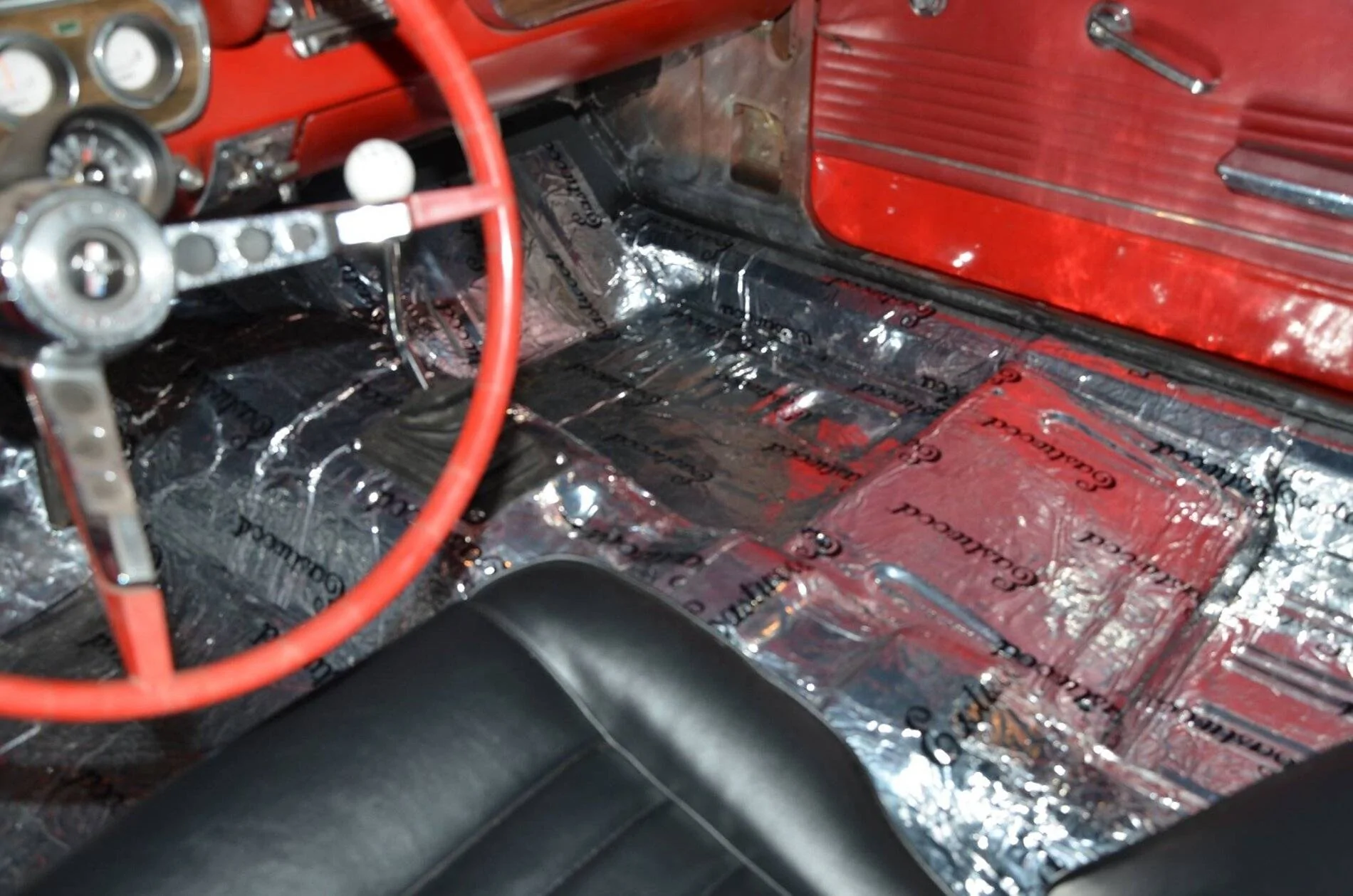

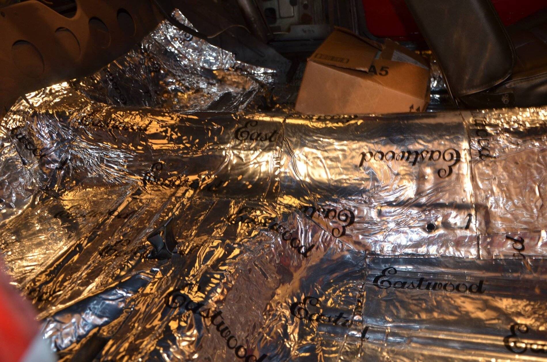

As an alternative, you can look at www.Eastwood.com sound deadening material. I’ve used this on all my classic and new cars when upgrading speakers. I’ve never been sorry.
the pictures below show sound deadening mat used in a classic convertible. The difference is in no way subjective to road noise. It blocks a lot of the stone, dirt or water sounds that splash up on the car. When installed under the hood, engine noise is quieted down. All of this plays into being able to hear your conversations or music better.
