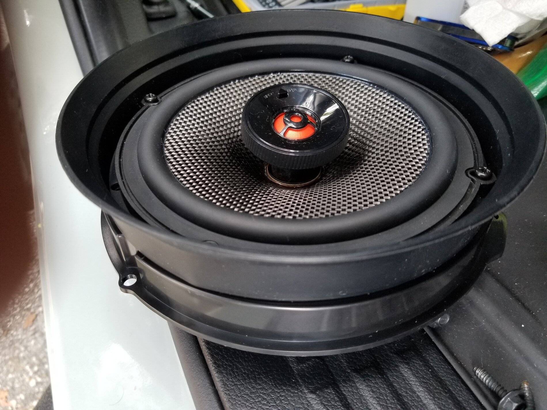

I saw some good reviews on the Powerbass 6.5 coaxial that is designed to mount up to factory Ford locations, so I bought a set for the rear to try them out while I decided on what front component set I wanted.

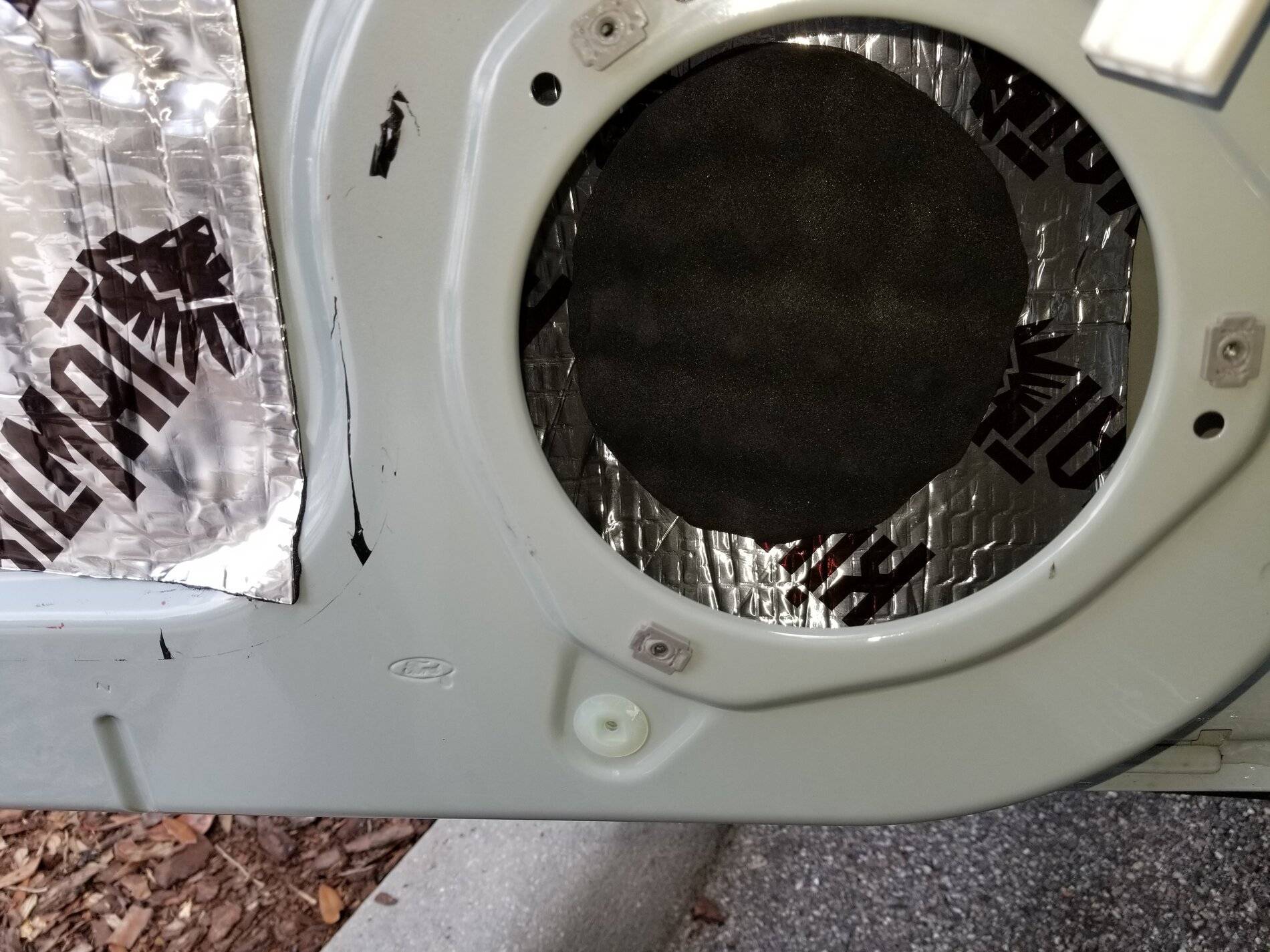

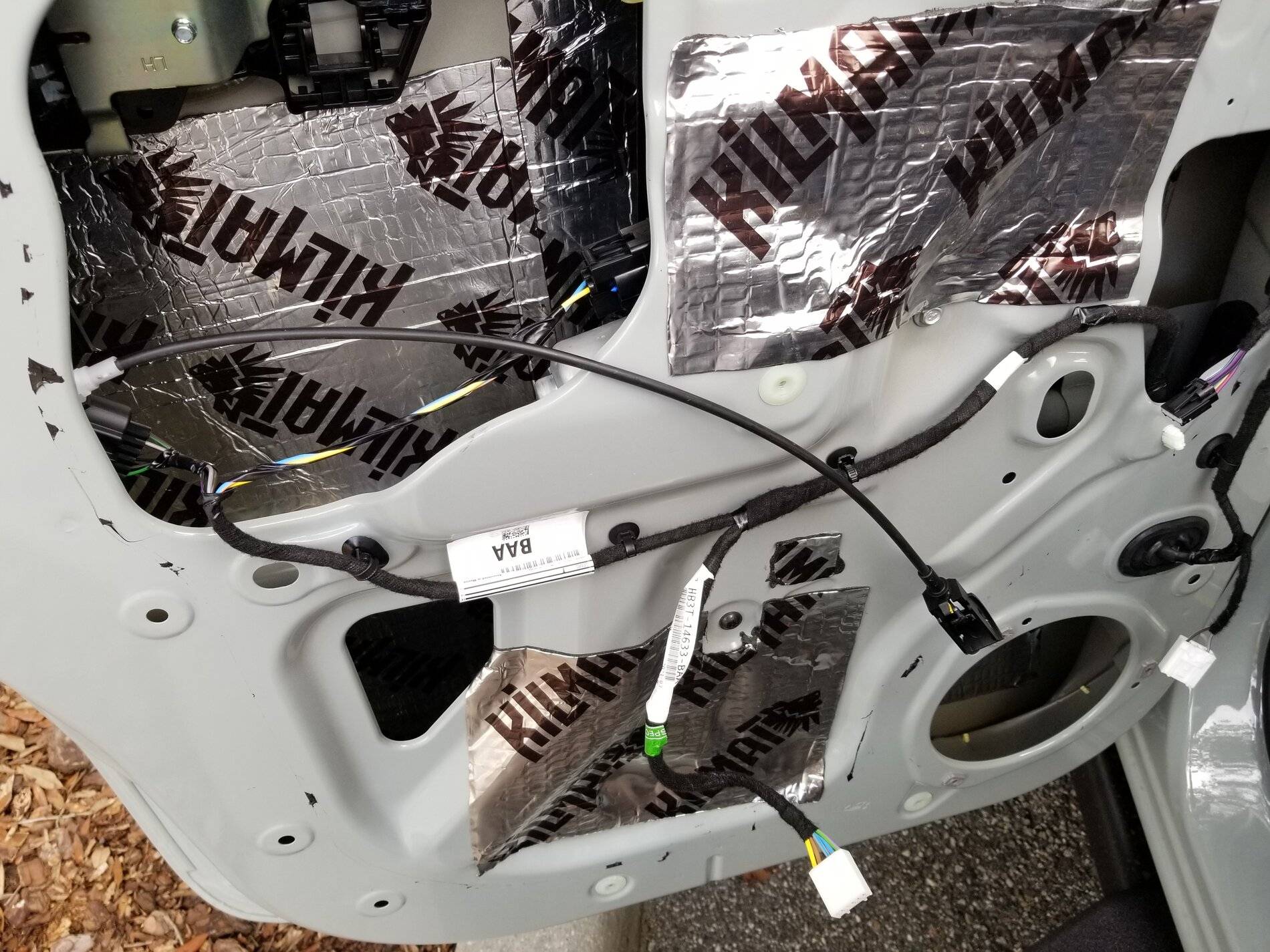

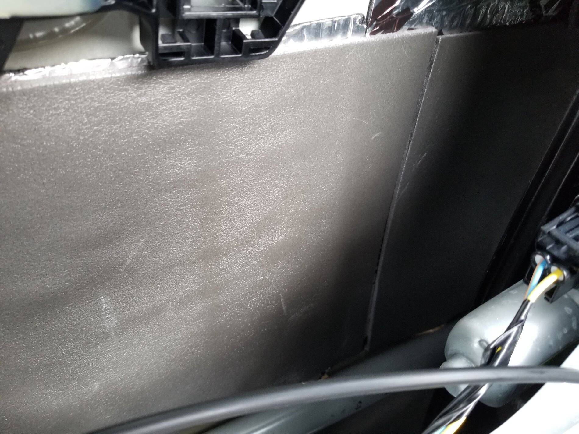

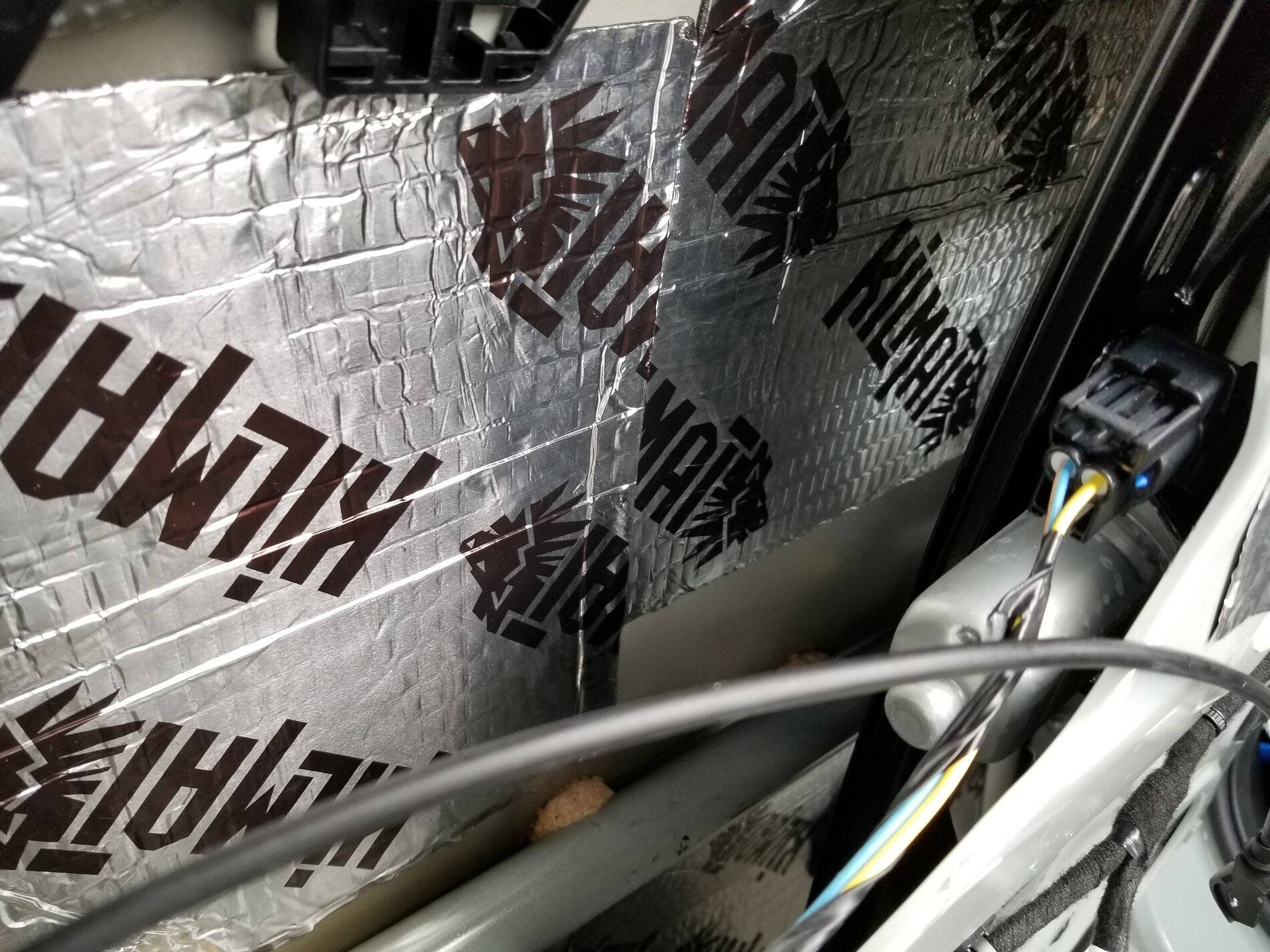

I installed Kilmat on the majority of the inner door skins, and on a few surfaces of the door frame where I knew it wouldn't interfere with the panel fit. Let me tell you, it made a MASSIVE difference in the sound resonation of the doors, and you can knock on them from the outside and get a nice dead thud sound. I've always thought the Ranger doors sounded cheap when closing them, and this helps a bunch.

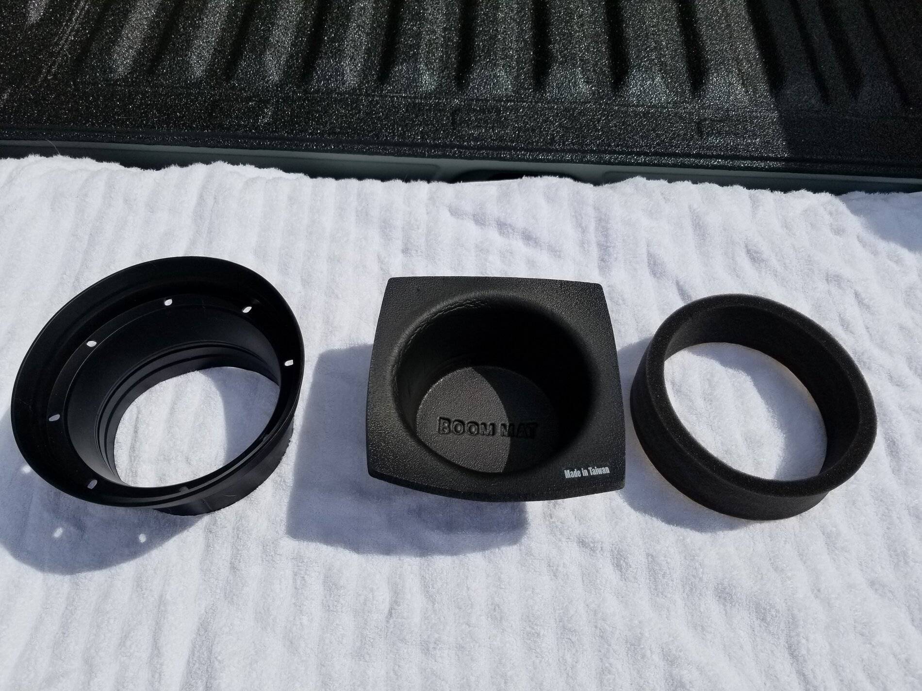

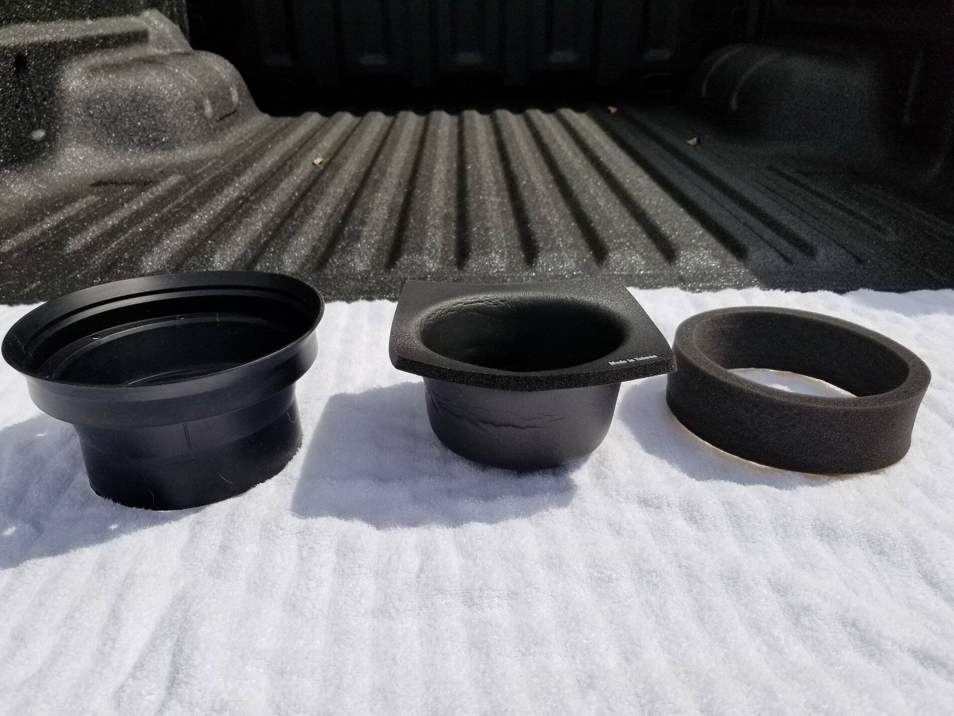

I bought foam surrounds from Boom Mat, rubber speaker protectors with a lip that is meant to seal the front of the speaker against the door panel, and foam surrounds that are also meant to seal the speaker against the door panel.
It turns out that due to the factoryish (lol) design of the Powerbass speakers, I couldn't fit the rubber trim, so I will try them on the front components.

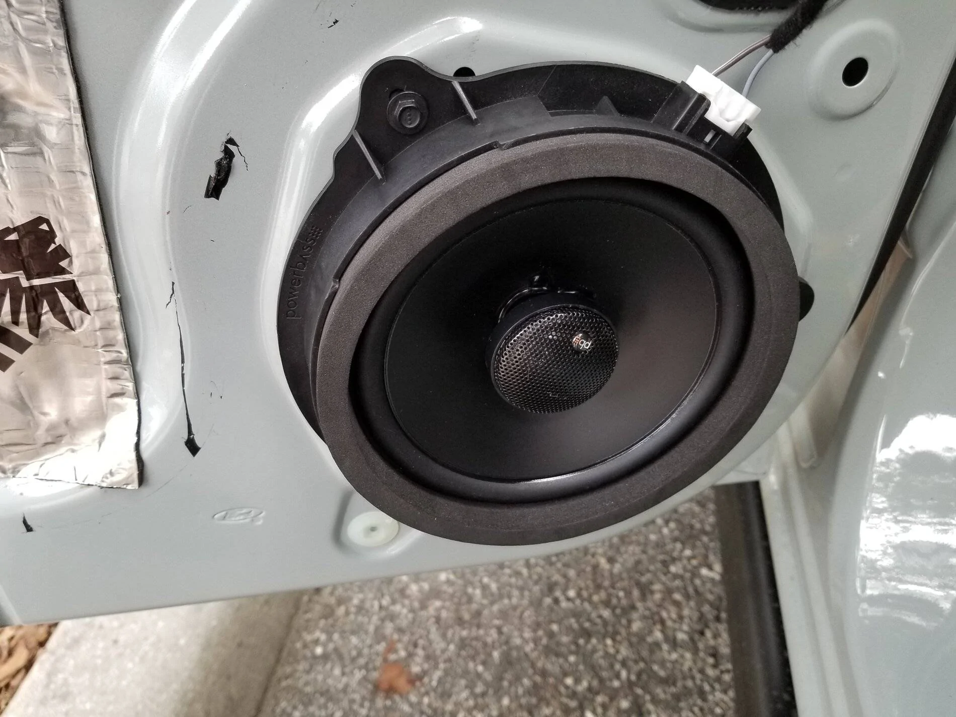

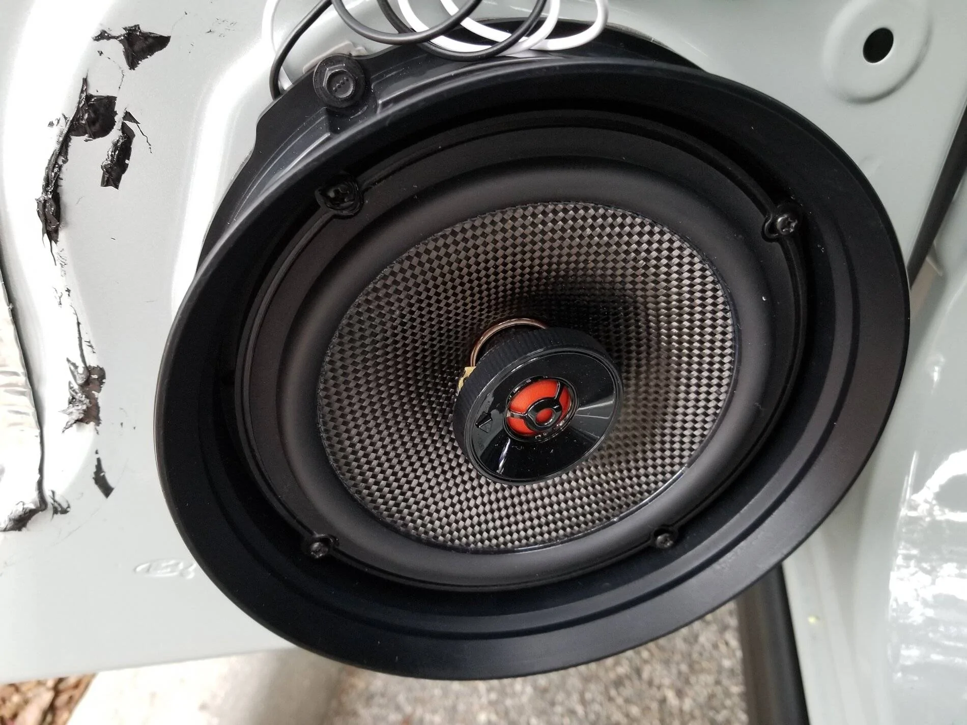

I put the Boom Mat foam surround under the passenger side speaker, and on the driver side there is nothing on the back of the speaker. I installed the foam rings around both speakers to seal them against the panel. After playing the speakers I determined that the Boom Mat definitely decreased the bass response, and it is likely because it is just such a small enclosure that it doesn't give the speaker much air to work with. I don't think the product is useless though, because it would definitely be helpful in protecting speakers in the case of a vehicle that gets a lot of water intrusion leaking down into the doors. When I pull the panels I am going to trim the bottom half of the enclosure away so the speakers will be protected against water, yet still have the benefit of the large enclosure of the door.
The foam seal rings seem to do a good job of directing the sound out of the speaker grills in the panel instead of allowing the sound to go sideways back into the door.
The biggest issue I ran into is that the new speakers don't sound good, and I don't think it is the fault of the speaker. They seem to be good quality, yet they barely sound better then the factory speakers. There is a harsh spike in the upper midrange, there isn't much treble, and the bass is not as punchy. I suspect the DSP Is designed to make the factory crappy speakers sound as good as possible, so the EQ is nothing like what it should be for speakers that can actually produce accurate sound. Another reason I think DSP is heavily at play, is when I fade the speakers all the way to the back, they sound really dead. Once I start moving the fade a little to the front, the rear speakers start sounding better, and more bass and treble seem to come out of them. Of course the overall sound is better because now the front components start playing, but I mean directly at ear level in the back, the rear speakers start sounding better once the fade is moved to the front a couple notches.

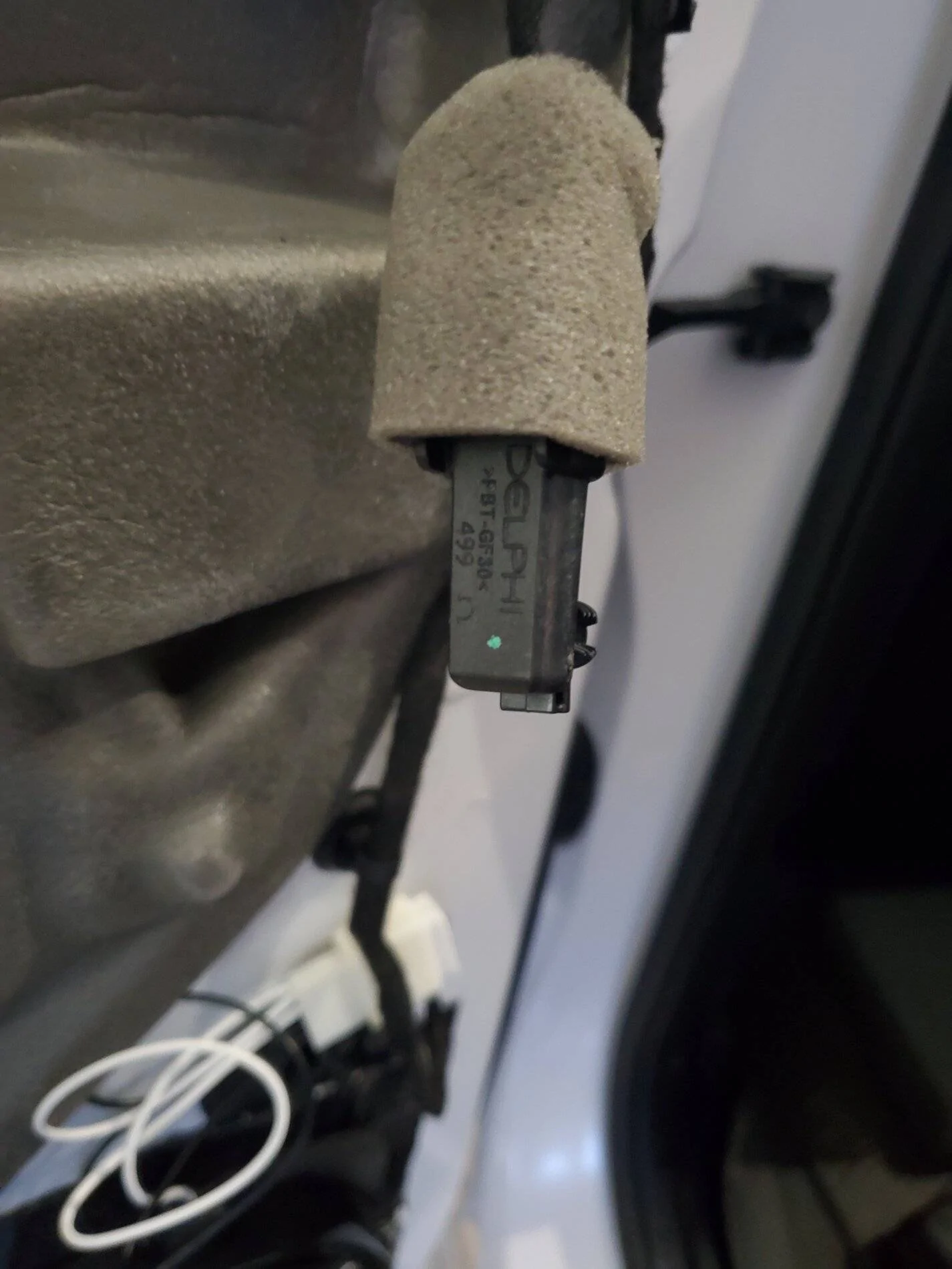

I have question. I replaced the speakers in my rear doors on my crew cab today and there is a Delphi resistor thingy on both doors near the top, plugged into the wiring. Is that part of the audio, or is it for something else? The Alpine 2 ways I put in already have the capacitors and such on the speaker. If that Delphi resistor is for the audio I didn't know if it was going to mess something up or if i'm supposed to take it off
I'm not sure, I didn't see it when I installed mine.

Here it is, must not be for the radio. I unplugged it and the speaker was still putting out sound
I was swapping out the rear speakers today, and I looked for this Delphi connector. It appears to be a cap or a connector to complete the circuit for the wiring harness that is made to connect to a tweeter.

I also added more Kilmat and I put a few pads of Noico sound deadening foam on the door skin. The rear doors are now completely finished.
I also finished completely covering the front door skins with Kilmat and Noico, and I bought a matching JBL component set for the front. I will install the component set as soon as I get the time this week.

The door panels are easy to remove. The kilmat makes a big difference.
