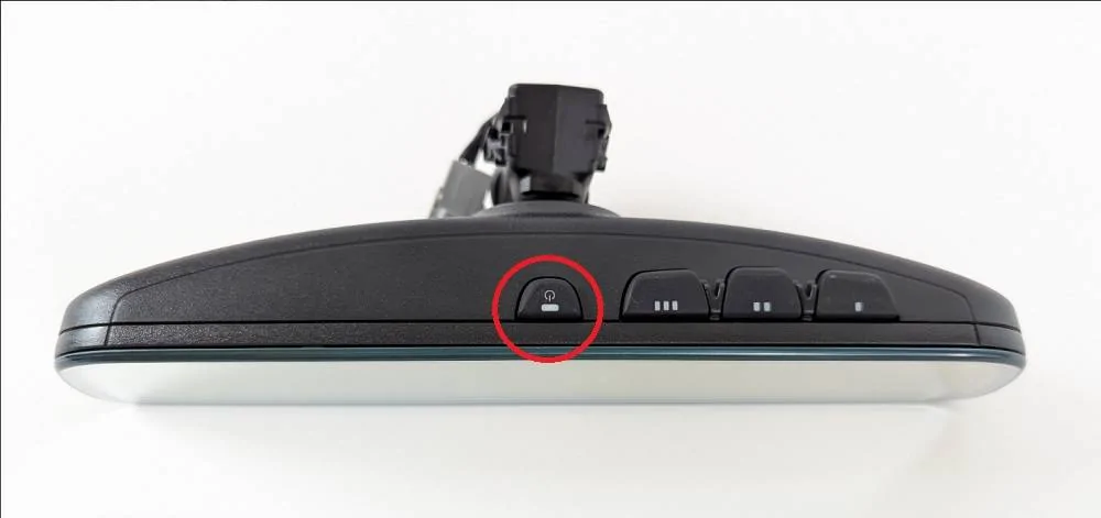

Reading through the information and looking at the pics, what is this button (circled) looks like a power button?

This button disables the autodimming feature of the mirror.
Another comment on these types of mirrors. They have Power, Ground and Reverse Signal. The reason for the Reverse is so it disables autodimming while backing out of your garage. The dimming feature works by monitoring the light intensity at both the front and back of the mirror. If the light shining on the glass is much higher than the front (like when someone's high beams are shining on you in the dark), the mirror will dim to reduce glare. This is disabled when pulling out of your garage when sunlight may 'trick' the mirror, so while in reverse, it will not dim.
if you ever want to disable the dimming feature, you can just press the center button
It should be noted that the power coming to the mirror on the Ranger is Accessory power, so it's not always on and only works when the Accessory power is keyed ON. I have other vehicles where the mirror is Always ON, so you can use the Homelink buttons with no key.
