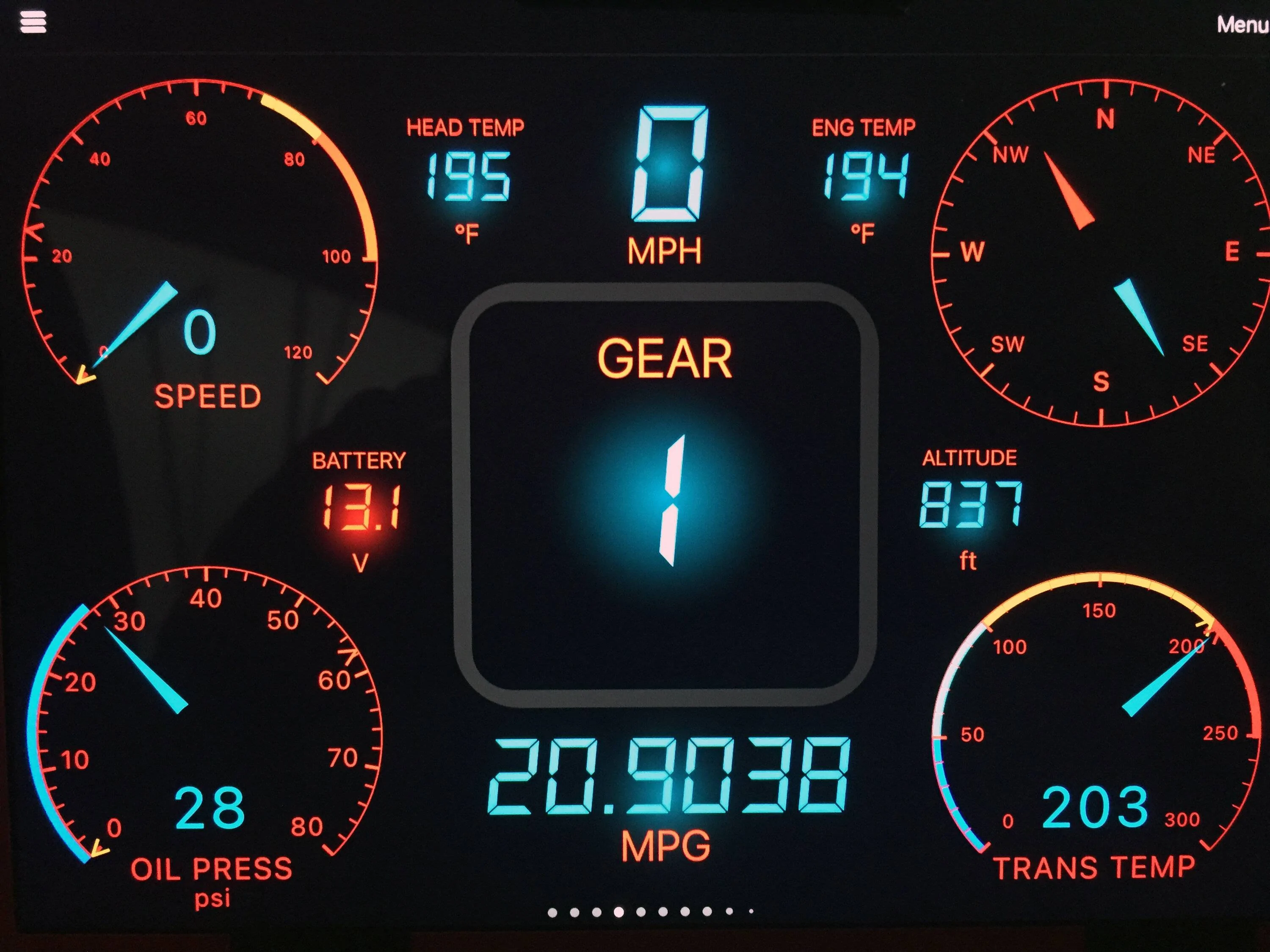

Is the app you're using the one that comes with the purchased Ford PIDs?
Displayed on iPad or Android tablet?
That looks great!
You buy the app first (might've been free)...it has standard SAE PIDs...they have a purchase option within the app for Ford Ranger PID that gets me access to trans temp, oil pressure, gear position and more...

Thanks, i saw that but I don’t want to use anything external or an app. Was just hoping to keep the regular driving mode indicator up all the time.
Unfortunately, Ford didn't set up their HMI to allow this for some reason...you'd think that having engaged sport mode is when gear indicator would be obvious to have visible all the time...the whole HMI for this 5G Ranger sucks in my opinion...
