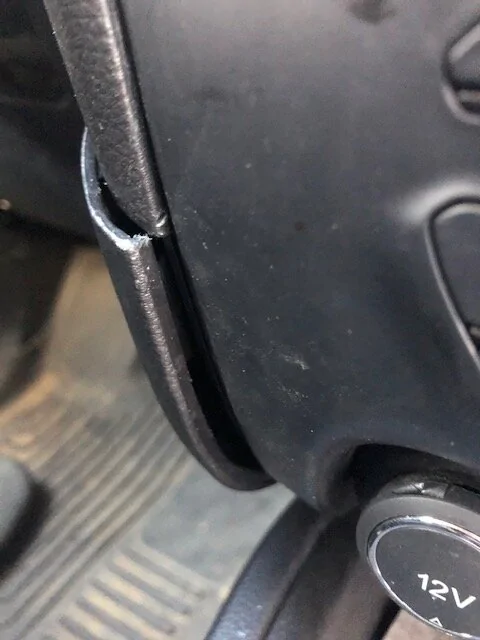

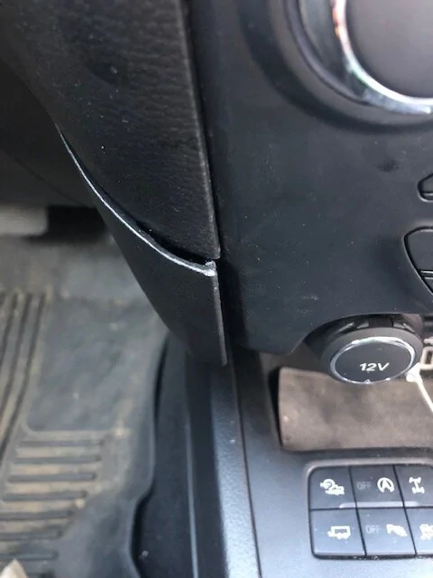

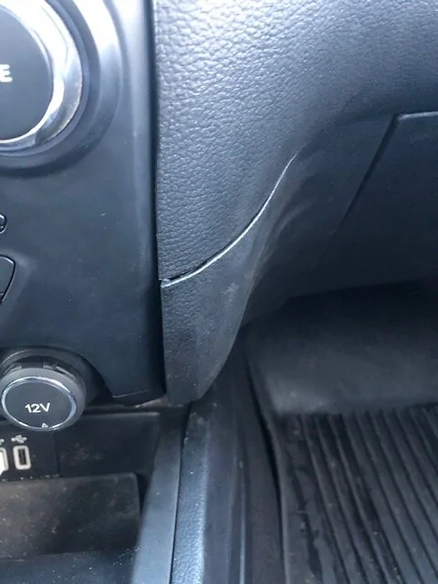

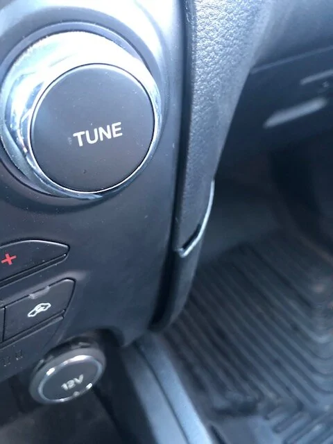

So I got my Ranger back today after the climate control module change out/dash pull....needless to say they really screwed me around cosmetically. So if you hear a very loud noise from my direction tomorrow around lunch time, it's just me letting my dealer know how I feel about this warranty repair work. I brag on these guys all the time in here and I'm am so ticked off!
Just for starts, my door sills were on the wrong (opposite door), so they broke a clip on both. Had them just sitting on top of the assembly, I got them in fairly well, but the drivers side has a spot that won't sit right now because of the broken clip. Then the two bottom trim pieces along side the center control panel for the HVAC..etc are completely out of alignment with the edge of the control panel and the trim piece above. This is on both sides. I was able to dissect the drivers side trim piece along with the drop panel under the steering wheel (the trim piece abuts the drop panel to the right on drivers side). Anyway, they broke a clip on the trim piece and on the drop panel, along with the middle screw part of one of those stupid fasteners was completely gone. Bottom line, they will fix every single clip, screw, trim panel....etc or I'm going completely nuts on the leadership of this place. Papaw is a nice man....very nice....and as such, if your not careful you will hurt my feelings and that is not good.....because I'm a very nice man ;)

Update...my awesome service advisor Oz is back from a family emergency. He told me to send pictures of the trim pieces and everything that is not right cosmetically and they will order whatā€™s needed to take care of my truck. This guy has taken pretty good care of me thus far. He was gone when they were finishing up my climate module work. Continue to stay tuned....
