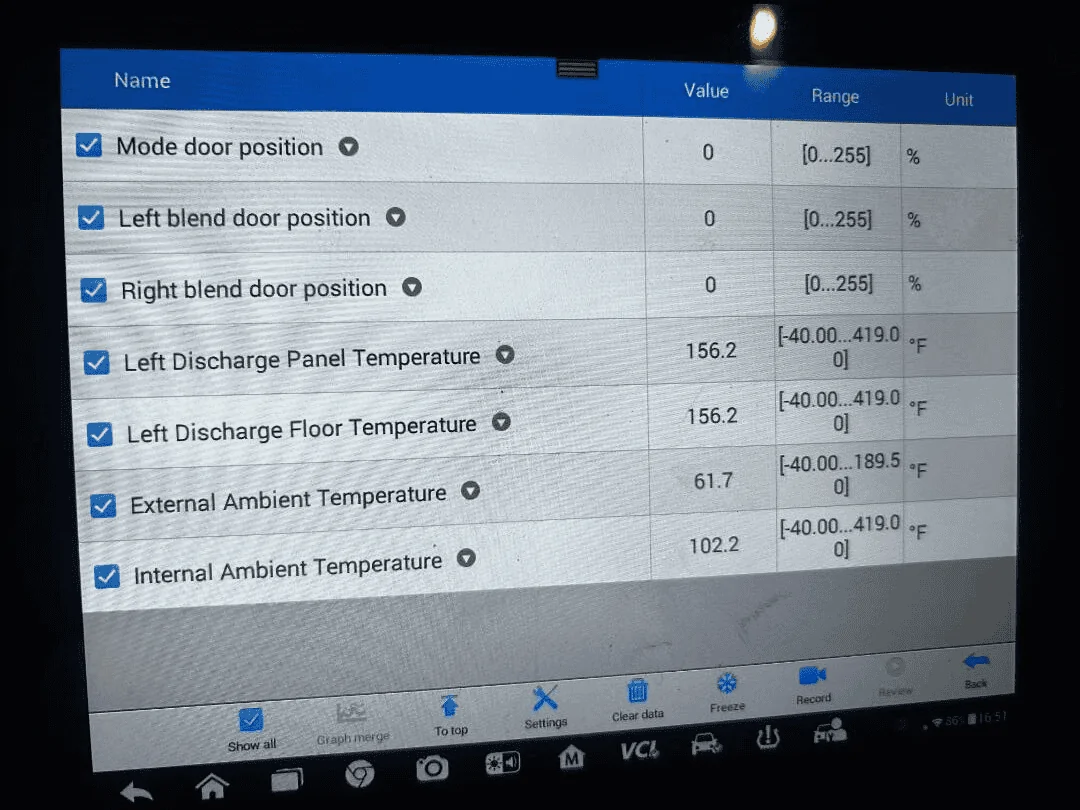

To highlight operation of the doors.
In Heat operation they open
In AC Operation they close
Notes: For T/Shoot
Mode Door Position: (Normal Readings as Follows)
Defrost = 100%
Panel = 0%
Floor = 50%
Blend - Panel/Floor = 25%
Left / Right Blend Door (This is the Temp Actuator/ Door) Position, this will check max travel open and closed.
Any selected temp in between the (percent) will vary.
Hi (Heat) = 0%
Lo (Cold) = 100%
Left Discharge Panel Temp / Left Discharge Floor Temp
These temps will vary but should be close to each other, if mode is placed in Blend (Panel/Floor) if you wait about 5 minutes or so the temps should be near equal.
External Amb Temp - Should match OAT Temp, using your phone etc.
Internal Amb Temp - This is the Temp/Humidity Sensor, this reading will read high and or low, if just sitting still as the heat/cold air is rising up from the floor vents through the dash.
