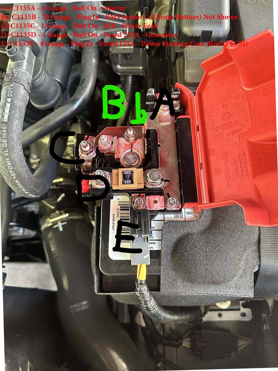

I tried all of them one by one, very meticulously, to no avail. Then eventually we decided to just pull the battery overnight and let everything reset. During that process we noticed one of the bolts in that tetris thing connected to the battery negative terminal was broken and sometimes lost contact. Jammed a beer can tab in it and suddenly everything was working. We zip tied it and it’s holding fine. It’s this very large yellow/red cable. Very much looking forward to not having to deal with a dealership. We’ll extract the bolt back home.

Awesome - for a reference - The Red/Yellow cable feeds the PSCM, So I assume it was location (E)

I thought he said the negative terminal he must have meant positive terminal.

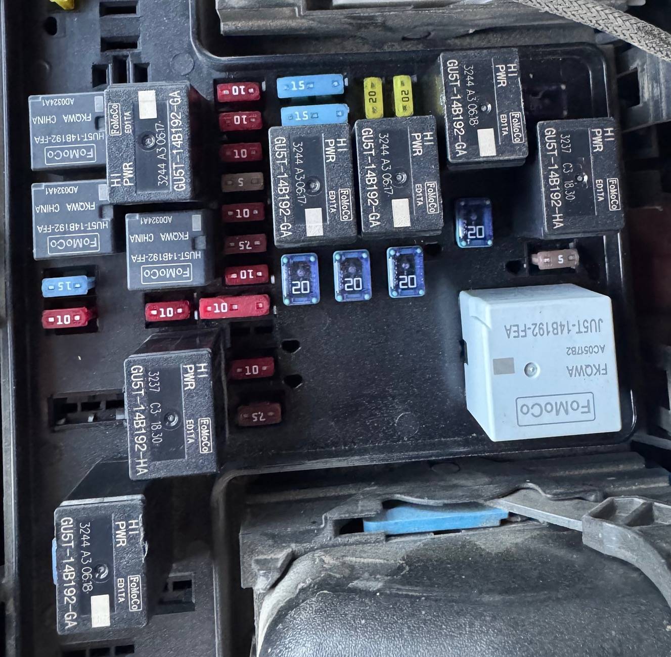

Do you by any chance know which relay I put in the wrong place? I was swapping relays to see if that was the issue but I guess I forgot to put it back in the right place. I also didn’t realize some of them are GA and some are HA.
4wd is not engaging.
Both bottom left relays should be HA relays. You have a GA there. You have an HA top right (should be a GA). Bottom Left should be an HA relay.
Swap the bottom left relay with the top right relay.
