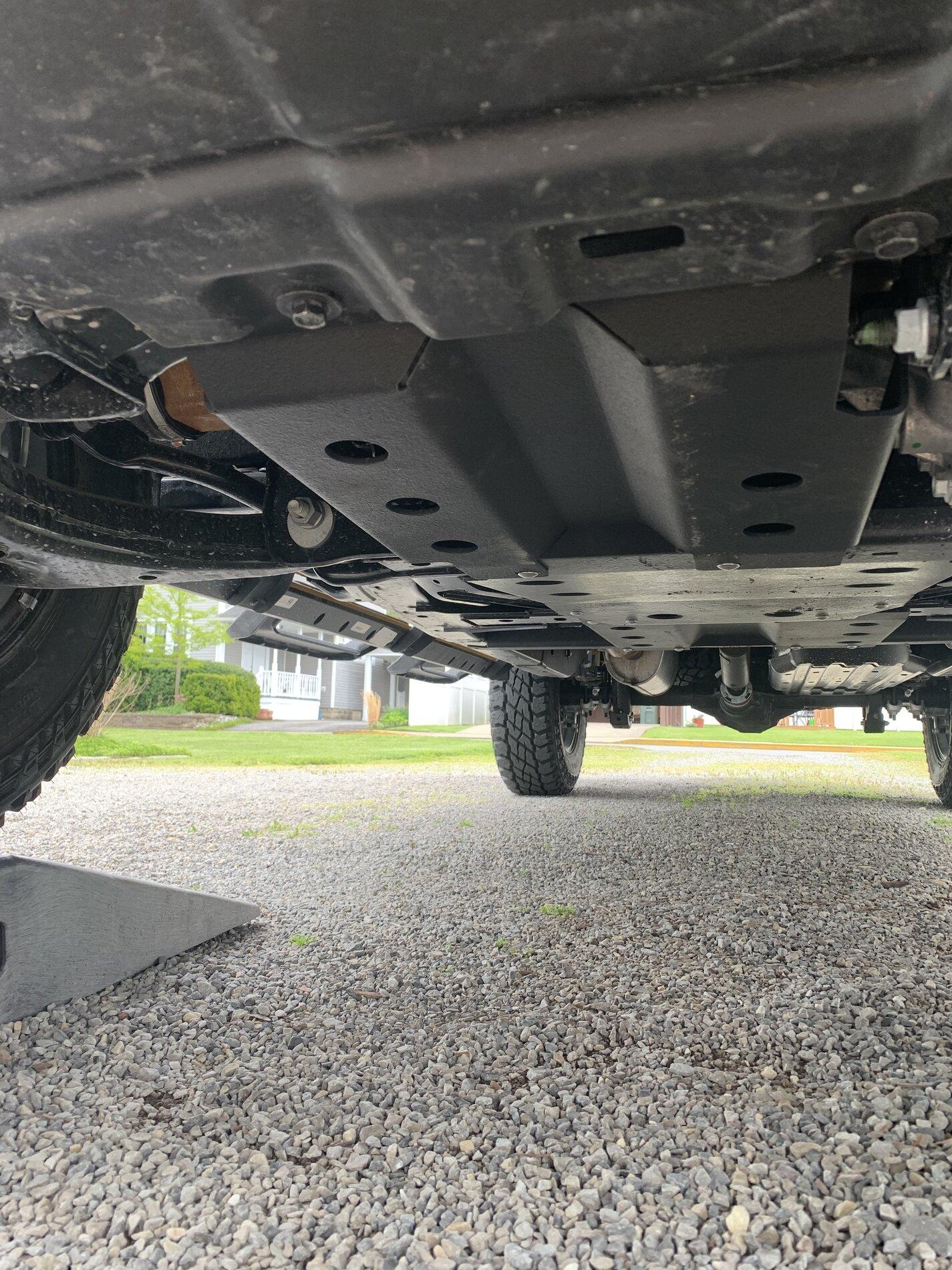

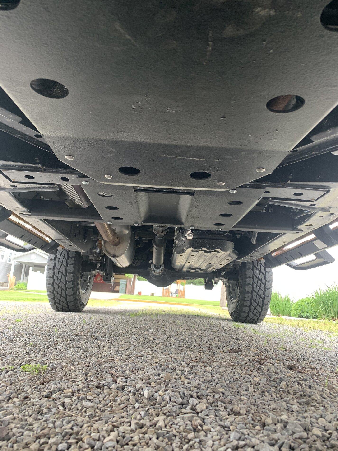

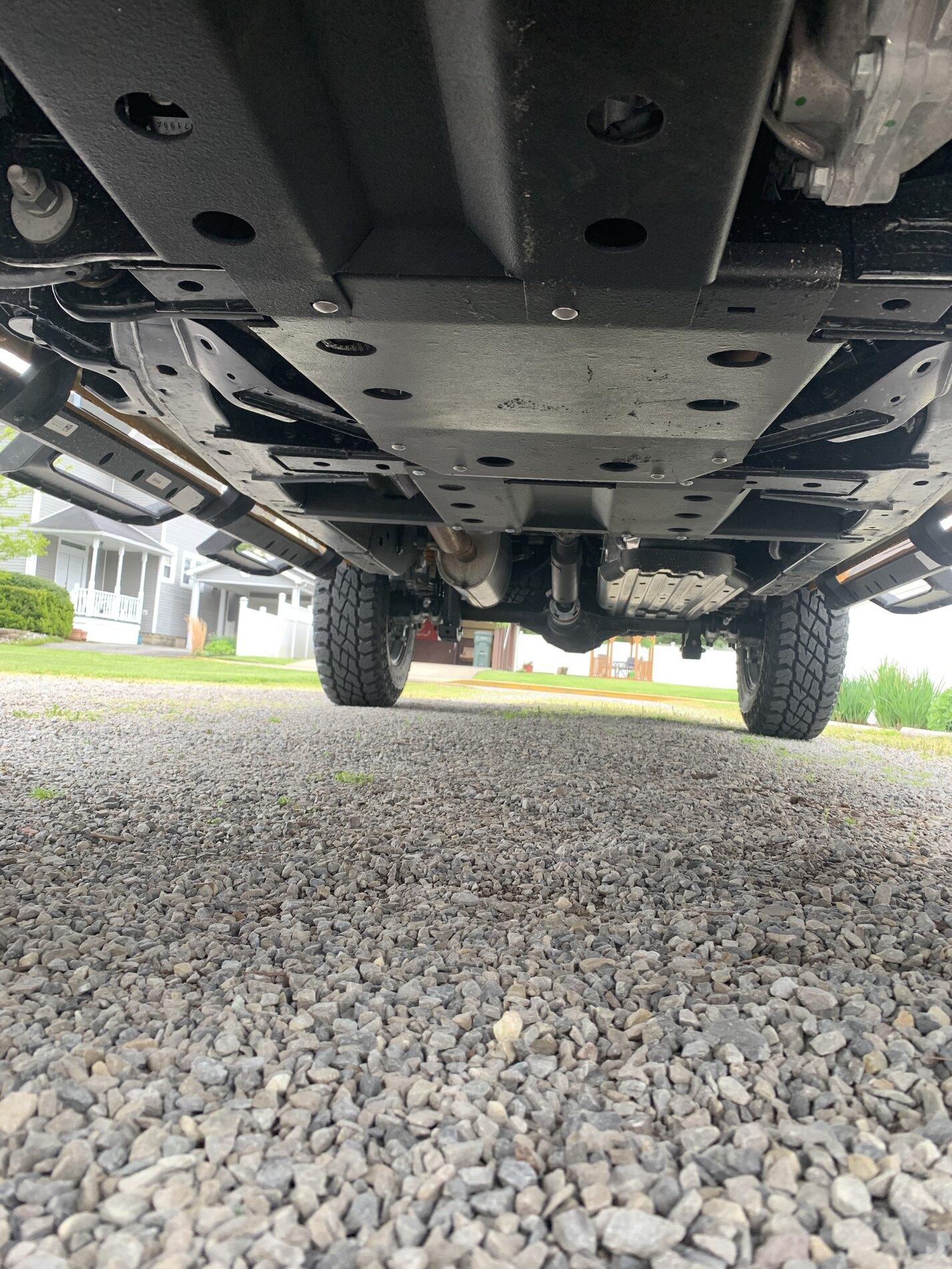

Did you opt to keep the FX4 front skid plate? If so, how is the fitment/alignment with the Shrockworks and the factory skid?
I’m not sure if there is a difference other than the color.
That said, I recently replaced my tremors bumper with an AFN front bumper which replaces the stock skid plate as well as the small plate behind it, and when I pulled the stock skid plate off I was surprised at just how thin it was. The front plate that came with my bumper is 6mm aluminum and is very beefy, much more so than the stock one. The rear plate that came with the bumper is 4mm steel and made that small plate seem like plastic.

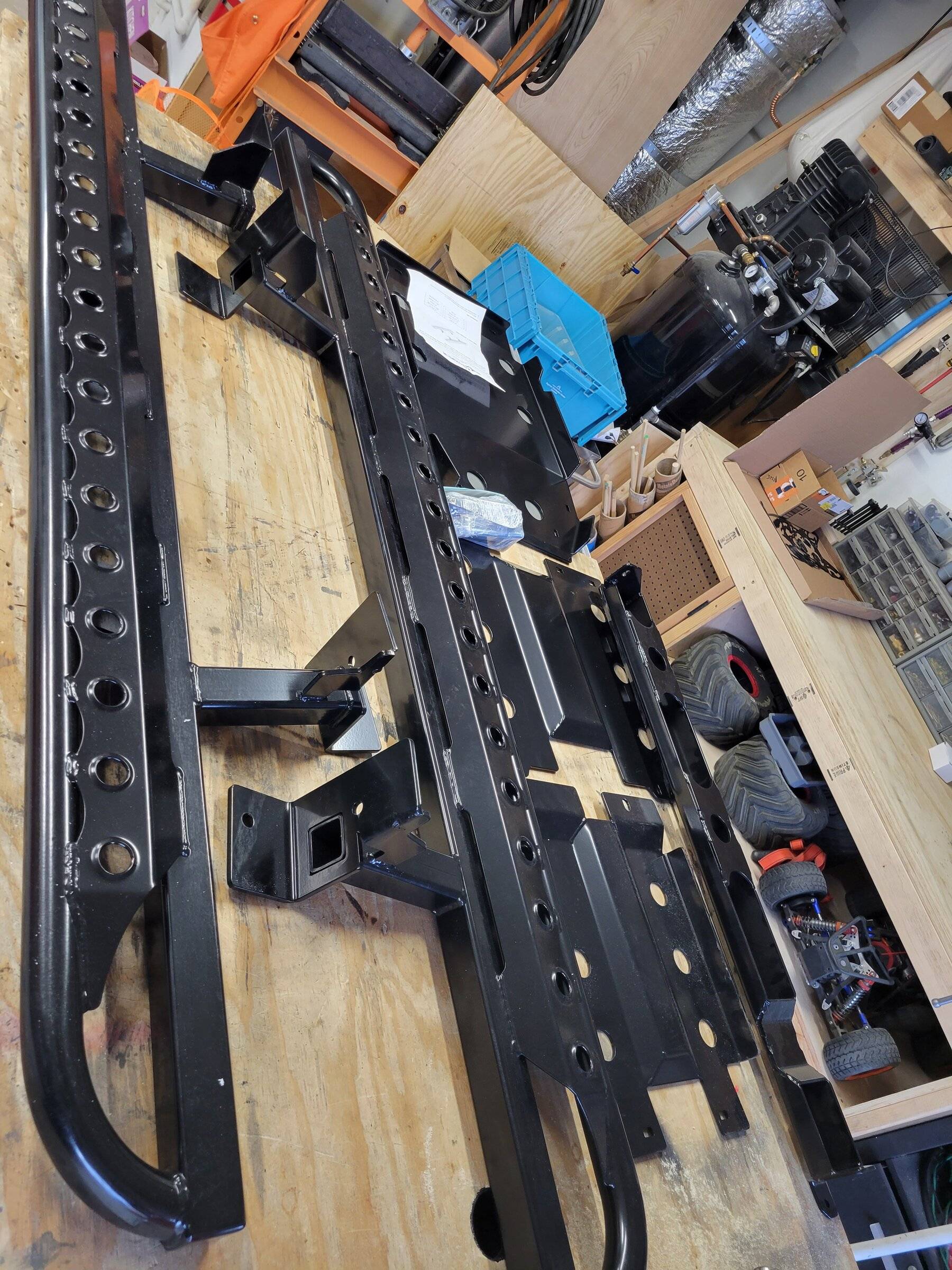

Nice. Just got my set in today, along with there sliders. I also have the 589 shock armor and a coastal offroad bumper.

What sliders are these?
Sorry for the hijack. Skids look great and now that's another thing I didn't realize I need to buy that I feel like I need to buy now. lol.
Gsd1976
Nov 28, 2020
58
169
Las vegas
Ranger
Construction
There shrockworks sliders to go with there skid plates that the OP pictured in the beginning.
9,230
28,579
NWO Robot Polisher
Looks like my Shrok sliders...they went out of bidness....

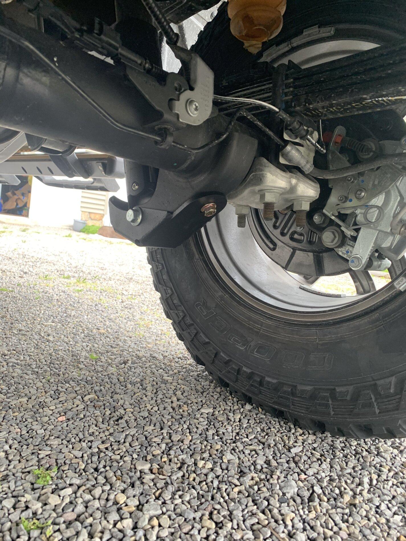

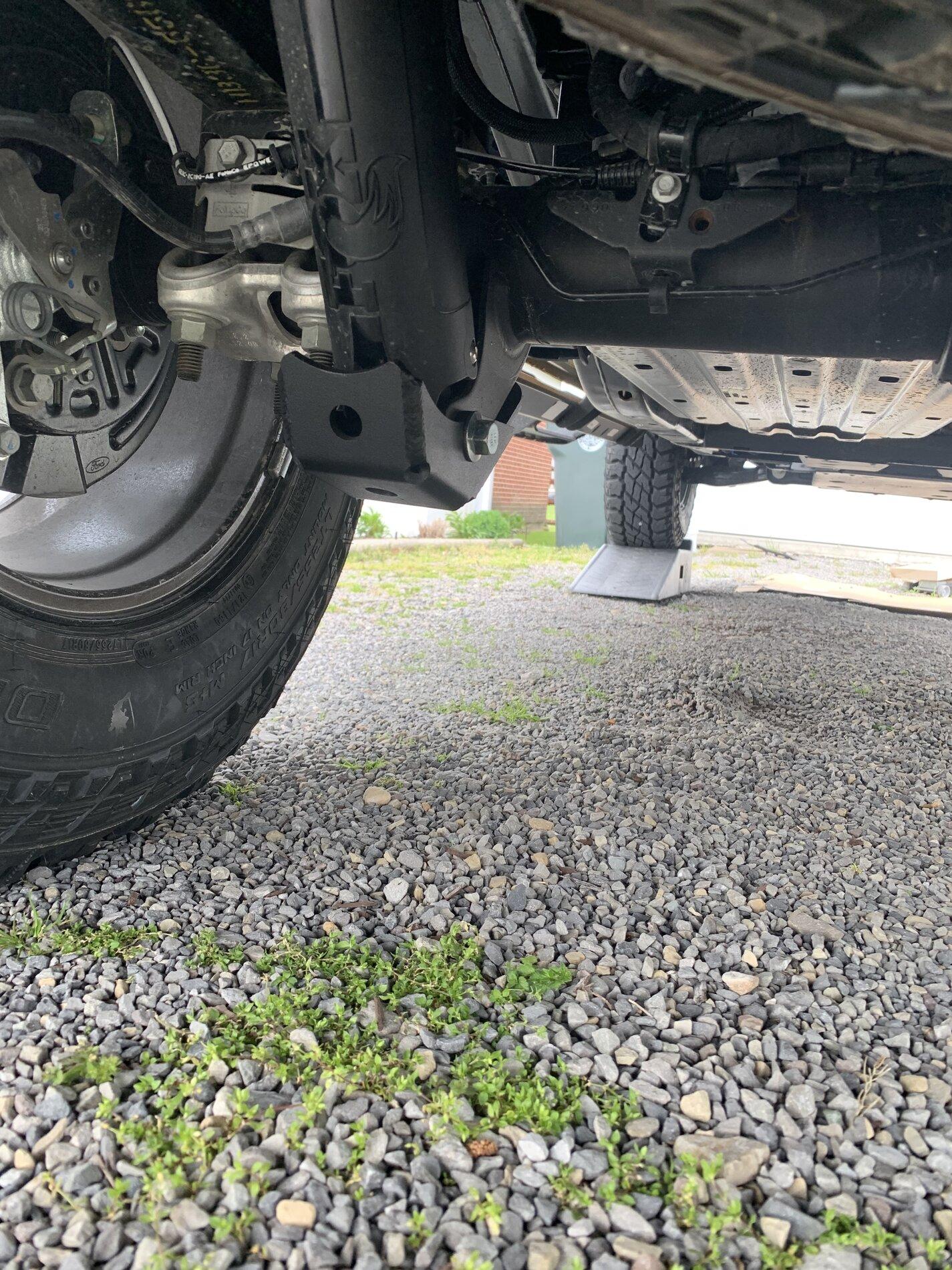

Installed Shrockworks skids and rear shock guards from 589 Fabrication. Think they will provide peace of mind on the trails.
I just got my shock skids. How did you install them? I can't find any instructions anywhere.
Mighty Little Blue
Jeff
Jul 11, 2021
401
1,386
Wisconsin Rapids, WI / Philippines
2021 Velocity Blue Supercab FX4
Printer/Retired
Straight forward just remove bottom shock mount bolt and mount skid using new hardware. One thing to watch is the 1st ones I got from them were not wide enough to fit. Customer service was great, and they sent new ones out with a return label right away.
