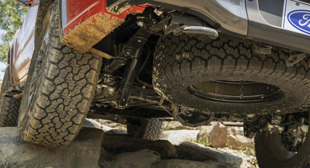

“Compared to base Ranger, Tremor is raised 20mm (approximately 0.8 inches) at the front and rear. That lift is accomplished through the redesigned springs,” Andrew Surma, Ford Motor Company Truck Communications Coordinator, told Ford Authority in a statement. Those redesigned springs are just one of many components that help make the 2021 Ford RangerTremor the most off-road-capable factory-built Ranger ever offered in the U.S.
The Ranger Tremor package also includes redesigned front knuckles and 32 inch Continental General Grabber A/TX all-terrain tires mounted on new 17 inch Magnetic-painted wheels, as well as Fox 2.0 monotube dampers with remote rear reservoirs and hydraulic rebound stops. Rounding out the suspension mods are a multi-leaf rear spring setup and anti-roll bars with reduced stiffness.
https://fordauthority.com/2020/09/2021-ford-ranger-tremor-suspension-lift-details-revealed/
https://media.ford.com/content/fordmedia/fna/us/en/news/2020/09/14/ford-ranger-tremor.html
The FX4s Hankooks are 31" diameter exactly. The Grabbers are 31.6"
That's only a .3" lift. So maybe the Tremor suspension is only .5" taller.
