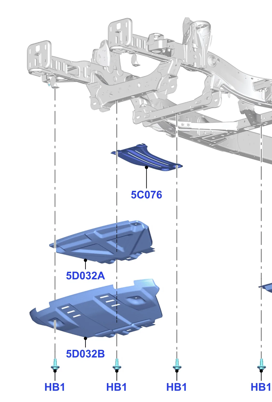

There are a few other threads going over this. There are a series of skid plates for the Ranger, the FX4 having all of them. I am not 100% positive, but I believe all 4x4 models, without FX4, have all but the front metallic plate, FD032B. See the diagram below:

IDK, all i can tell you is that i had a fake plastic 'Decorative' 'skidplate' that i had to remove prior to fitting the 'B' model. It came out with a bunch small bolts accros the front. That's because i have a FX2. The B model plate seats farther forward then the 'A' model. Buy it and see, 'A' Plates are pretty cheap cost wise. Don't forget you'll need a set of 4x4 tow hooks, and bolts, if your going to do the trans plate as well, As the 2x4 hooks lack the skid plate brackets.

I just got the B plate in the mail today for my 4x4 non-FX4. Scrubbed the finish off with steel wool and put a few coats of Herculiner on it to match my black truck. Anxiously awaiting install upon drying.

B plate, which is the larger one, is painted silver. My understanding is that you either get the A plate or B plate. Base models 4x4s get the A plate, FX4s get the B plate.
