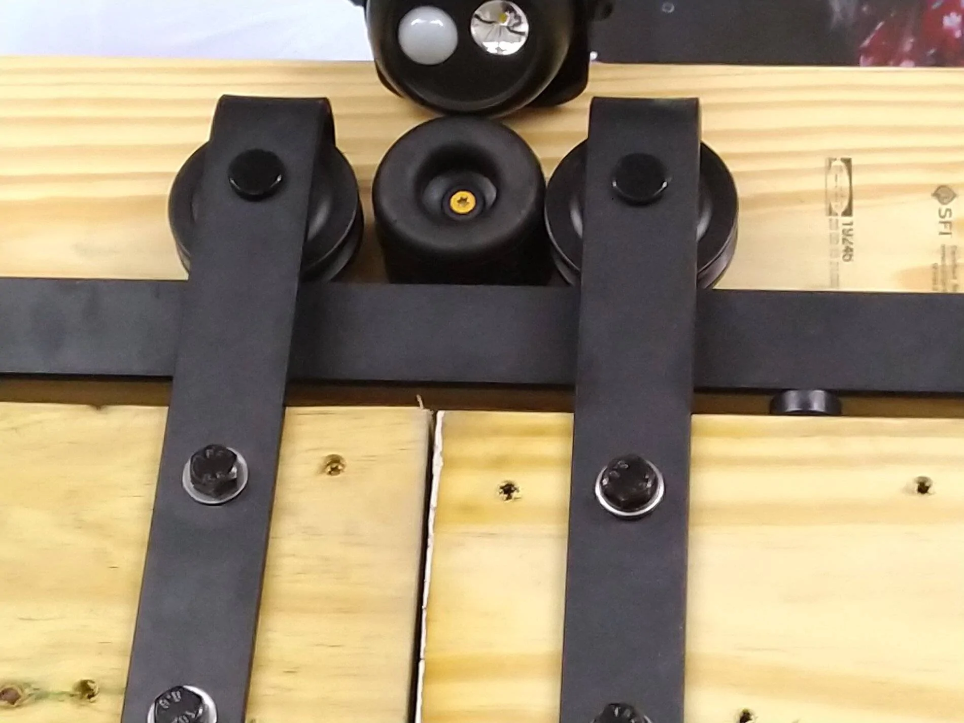

Little more work done on the barn door design. For clarification when both doors are in the closed position the overlay will be about 6 inches or so on the door frame opening, so ignore the gap you see.
In regards to the gaps in the actual door, I have some tricks up my sleeve to close those off later.

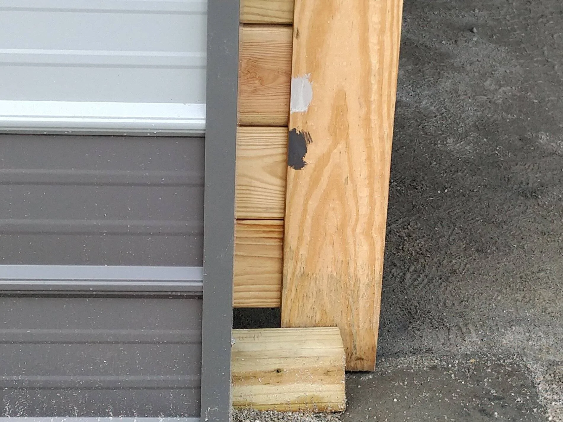

The bottom color came out a little darker than I expected once I dabbed some on the wood. Seemed much lighter and nearly a perfect match at the store.
But it will do. Will see if weather allows me and my daughter to paint tomorrow.
I am thinking of installing flashing tape on the bottom edges of the door, seems like a smart idea to protect against water soakage over time yea?

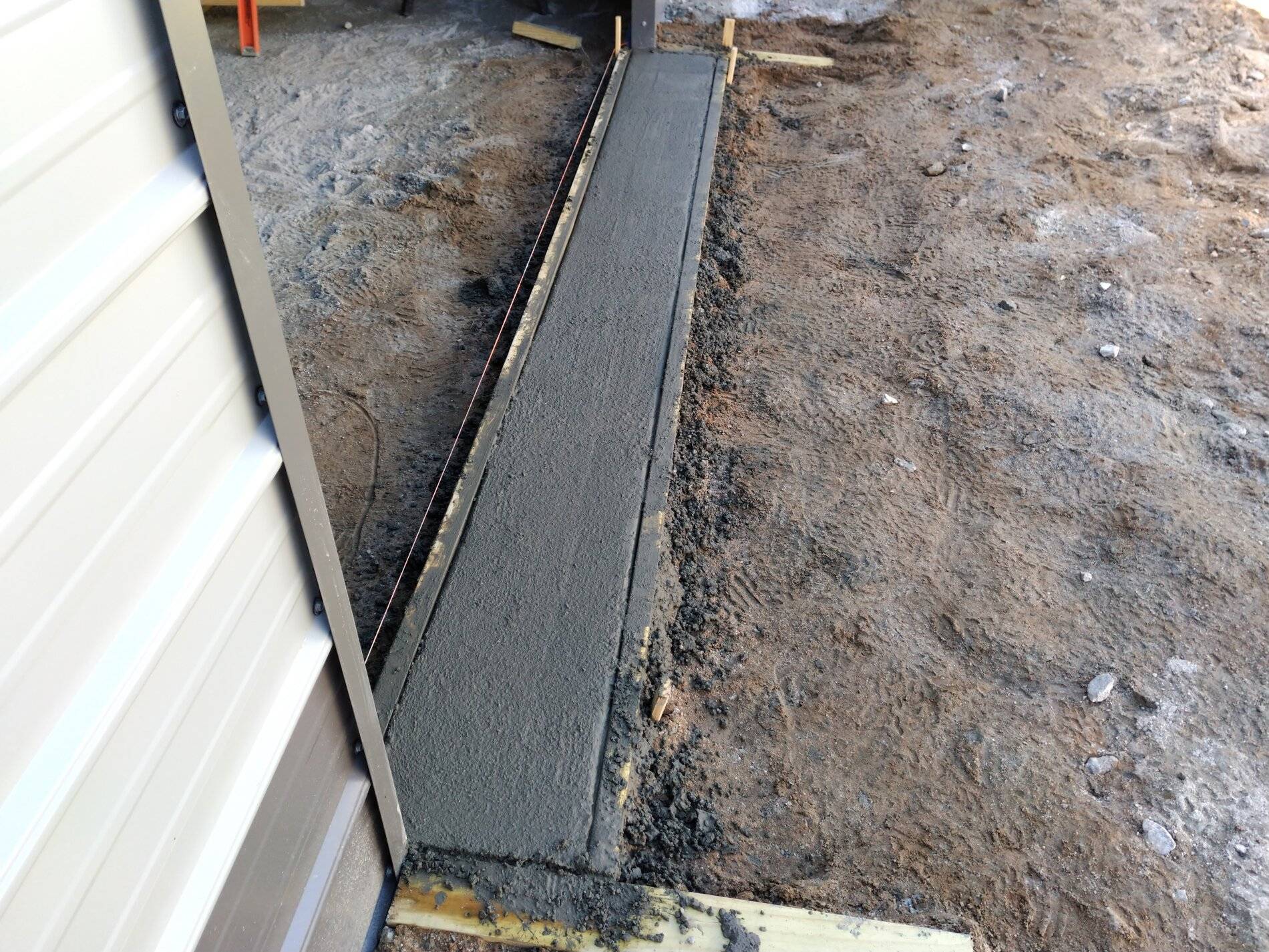

Well tomorrow my plan is to put in a concrete entry sill (1' x 10') at 4 inches deep. I figure this is a small enough project if I like working with concrete I may just do 6' x 6' sections at a time. until the entire floor is done. This is the only budget friendly way I can do this with all my other projects going on.

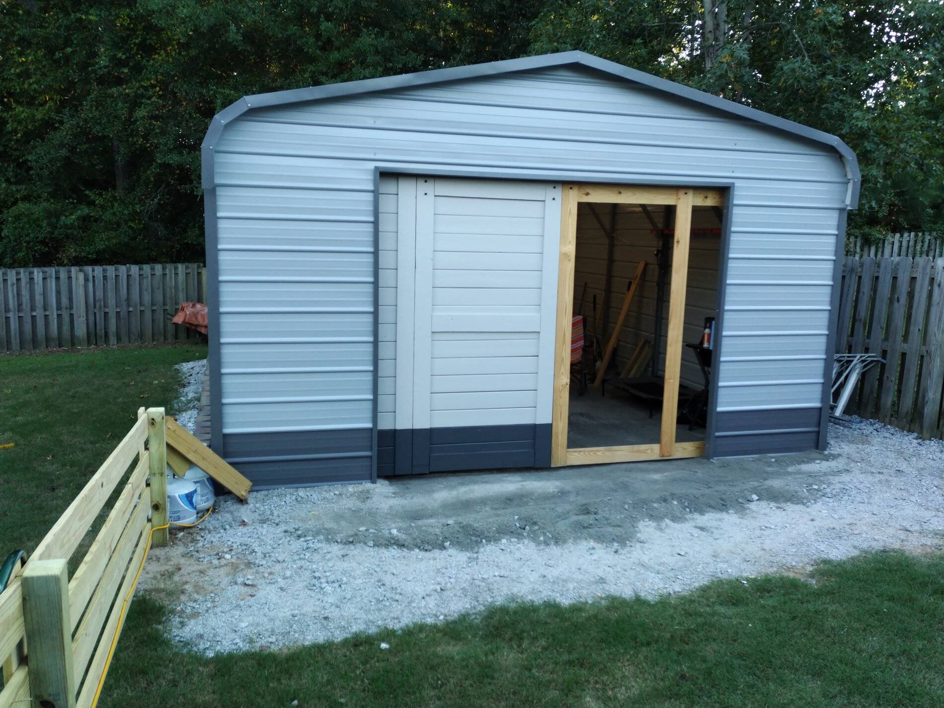

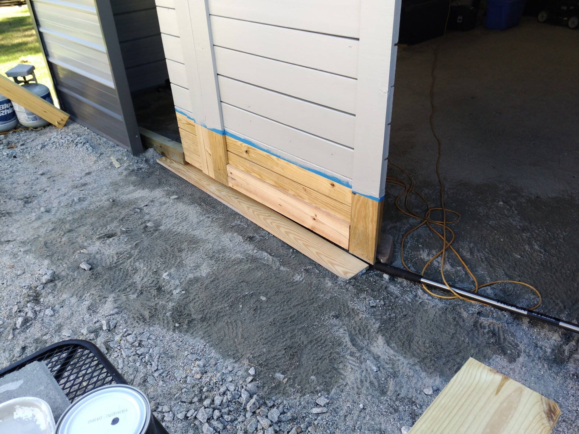

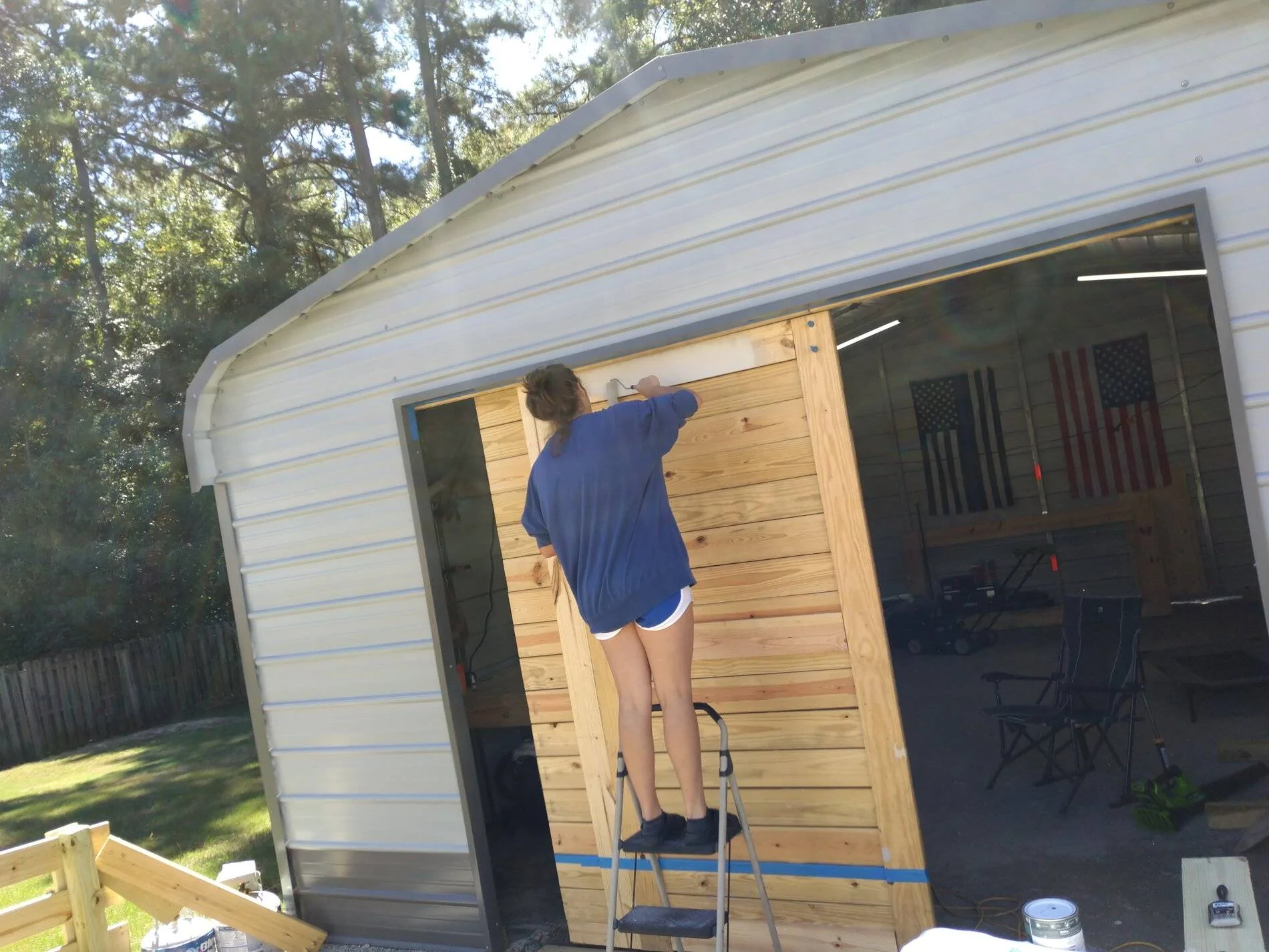

Todays task, my daughter gave me a hand painting the one door. She rolled, I brushed the edges. I'm a little let down how the color came out, but it could be worse and doesn't look half bad. I may try a better color match at some point in future. Amateur hour I know, I need to fix my middle trim piece (its crooked) and I guess I should have caulked the trim gaps before painting? I guess it doesn't matter won't take no time to touch it up.
The paint chips looked good at store, so I dunno, but fyi Home Derpot "Pewter Gray" is not the same as metal garage "Pewter Gray". The bottom came out pretty good, though a tad darker.

Okay so it's not too bad job for the first time trying it. Execution could have been a little bit better especially on the edge but I'll be happy enough if it doesn't crack if it does no super big deal I don't have a lot invested in it and it's small enough I can break it up and redo it.
I will say however in this instance a hand mixed the bags of concrete and screw that mess. An automatic mixer of some sort is definitely going to be added to the budget somehow.

If you want to save a good bit of money you can make your own concrete - you buy bags of portland cement and then get truckloads of gravel and sand. 3 shovels of sand, 2 shovels of gravel and 1 shovel of cement:
https://www.thisoldhouse.com/masonry/22256867/how-to-make-and-mix-concrete
It is quite a bit cheaper than the premix bags.

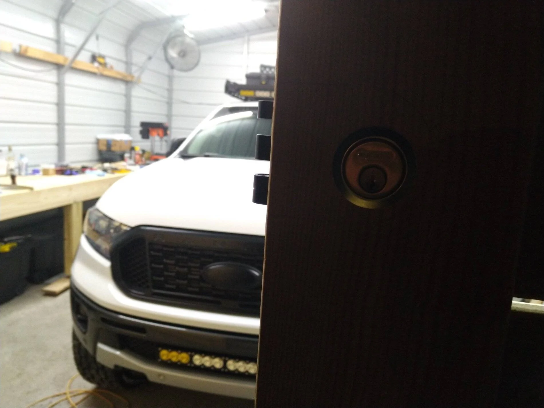

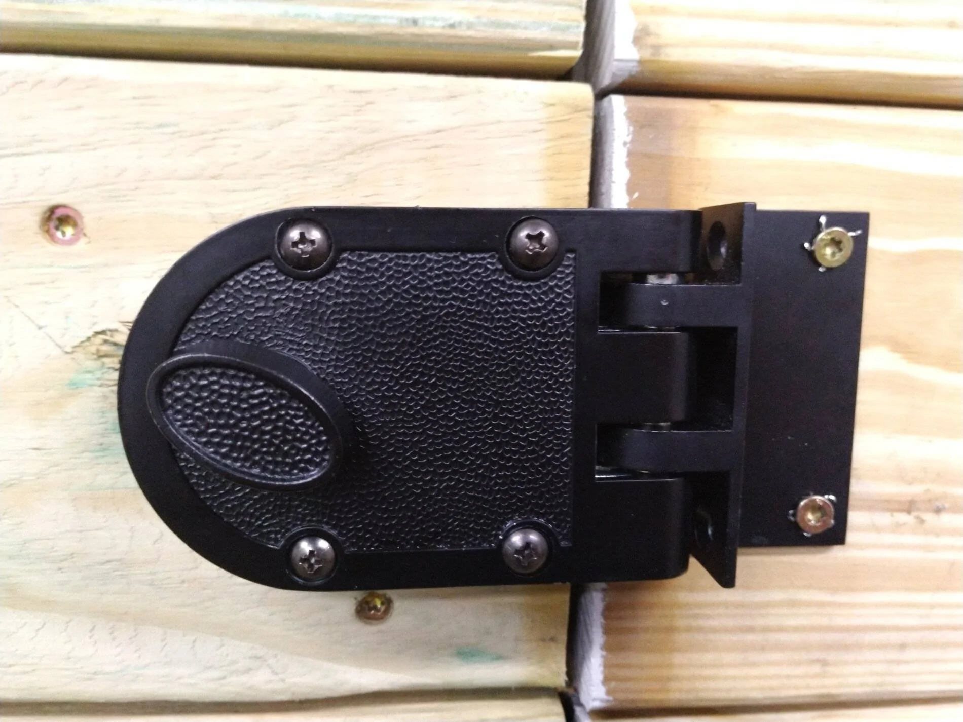

So here is how I rigged the cylinder lock. I didn't feel like notching the door for the cylinder channel bracket so I just flipped it. I also added a bump stop from some left over parts from the rack project to prevent the two locked doors being moved together all the way left or right which would create a small enough gap for a small person to bypass the doors (lol).
Also, my new shop pet Wilson (not very original I know) was hanging out with me.
