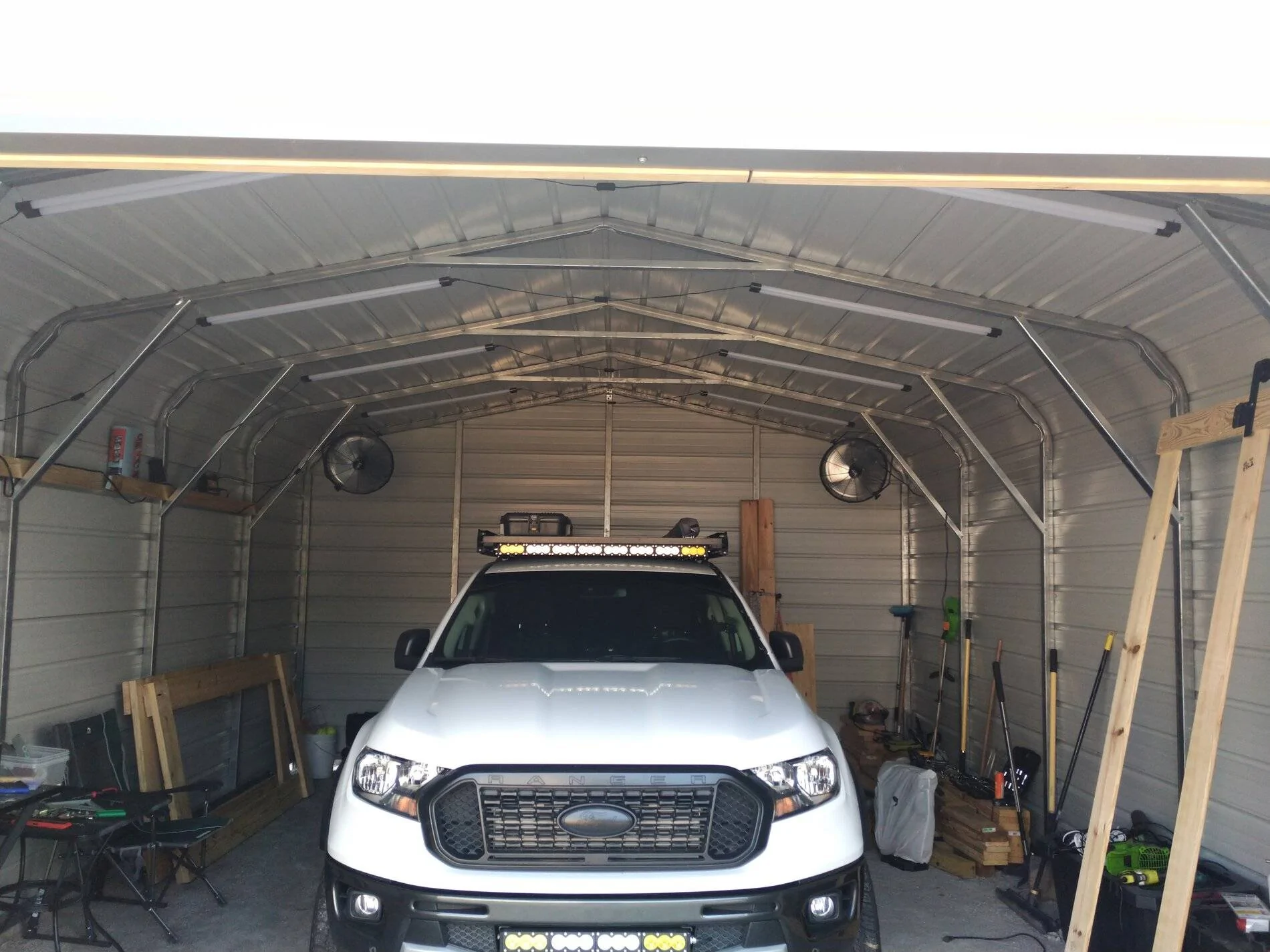

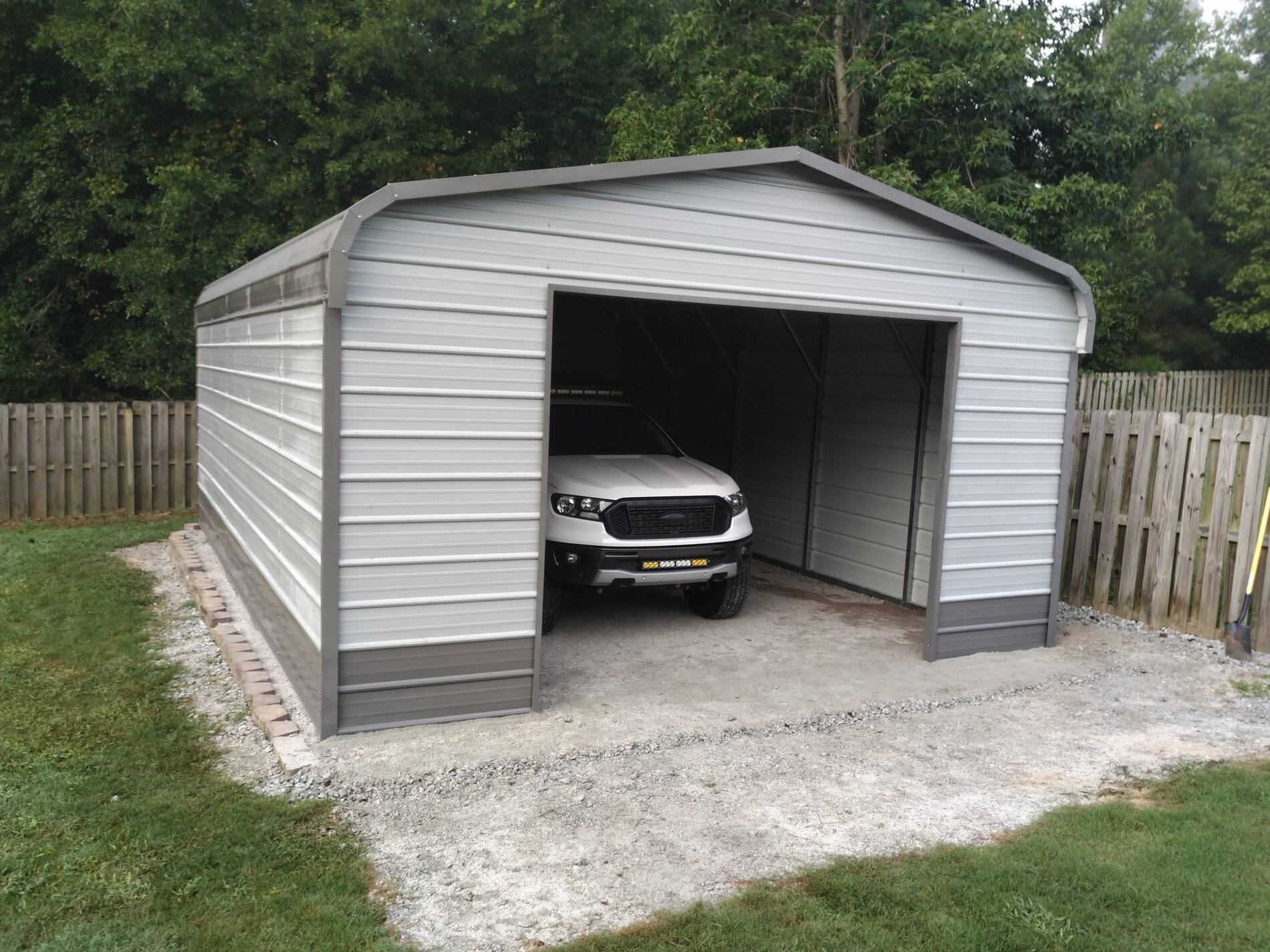

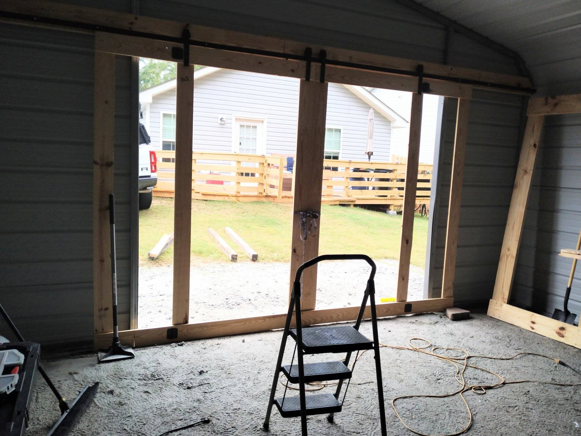

Been posting updates in my build thread (see signature), but its been slow going getting everything setup.
Hoping to finish the sliding / folding barn doors today. Will get them painted to match the two tone next week is the plan at least. Got some lumber to build some new work benches. Debating on how many and what size, along with stick built shelving. Loft style storage is an option as well. Lots of room to do whatever I want. I am thinking about doing storage pods like my truck has with plano boxes and gas struts, but the larger tote sizes turned on their sides and framed in by wood. Hell of a lot cheaper than metal enclosed storage.
As you can see I had to come up with a clever way to have a sliding internal barn door for a 10 foot opening, but only 4 feet of room on each side. The easiest solution was having 2 foot sections on each side that can fold. Those sections will be held in place (made rigid) by latches when I am done. So basically, unlock and slide open enough to walk in, pop the latches, fold the sides, then slide the rest of the way wall to wall. Hoping my floor guide rollers will be in today.
I think the floor plan, as of right now at least, is to do a concrete door sill type setup, but still use paver blocks for the rest.

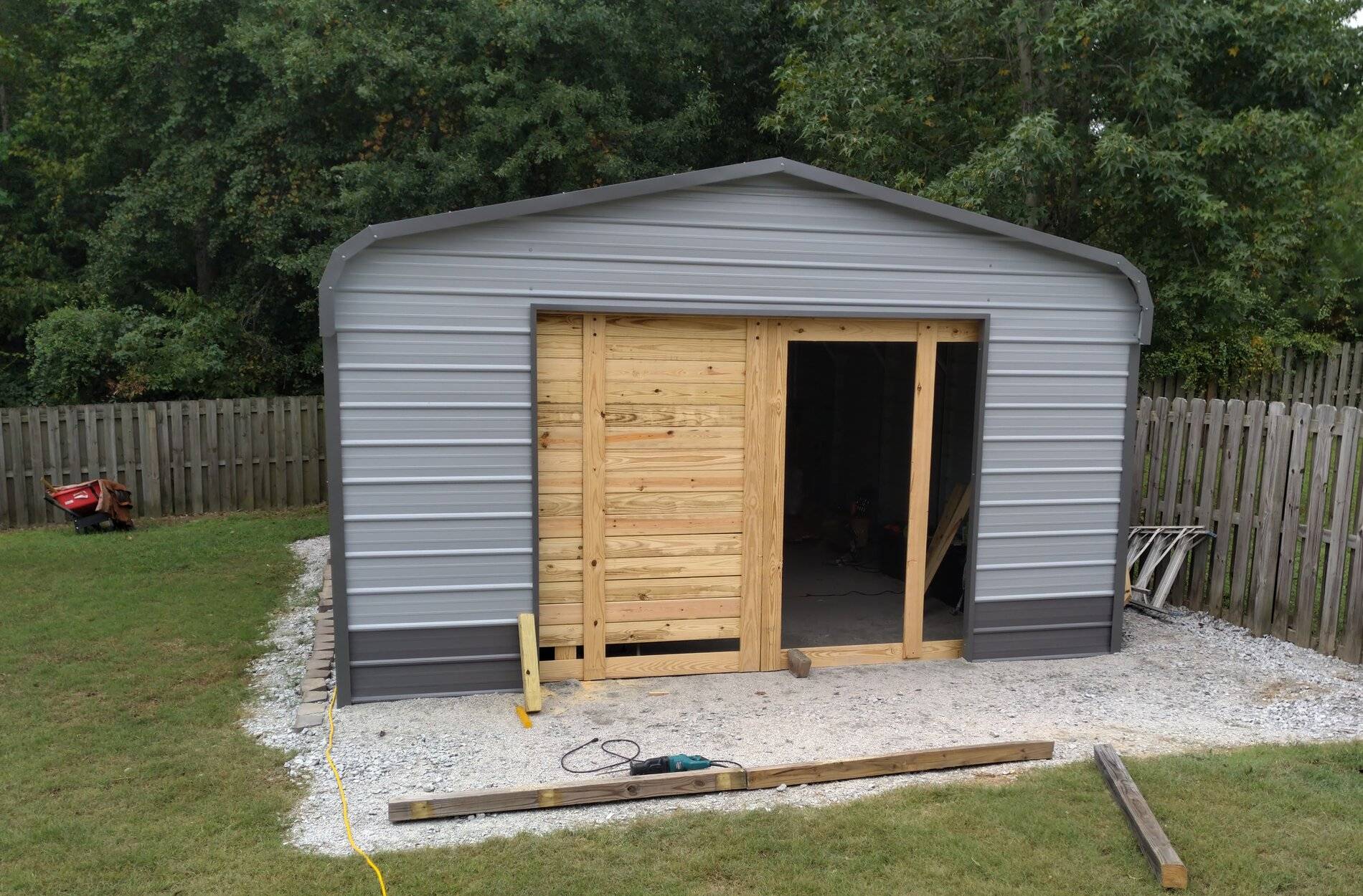

Ok it may not get done today. More slow going that I thought.
Anywho... once I get the front trim in place it will look less like a backwards installed door.

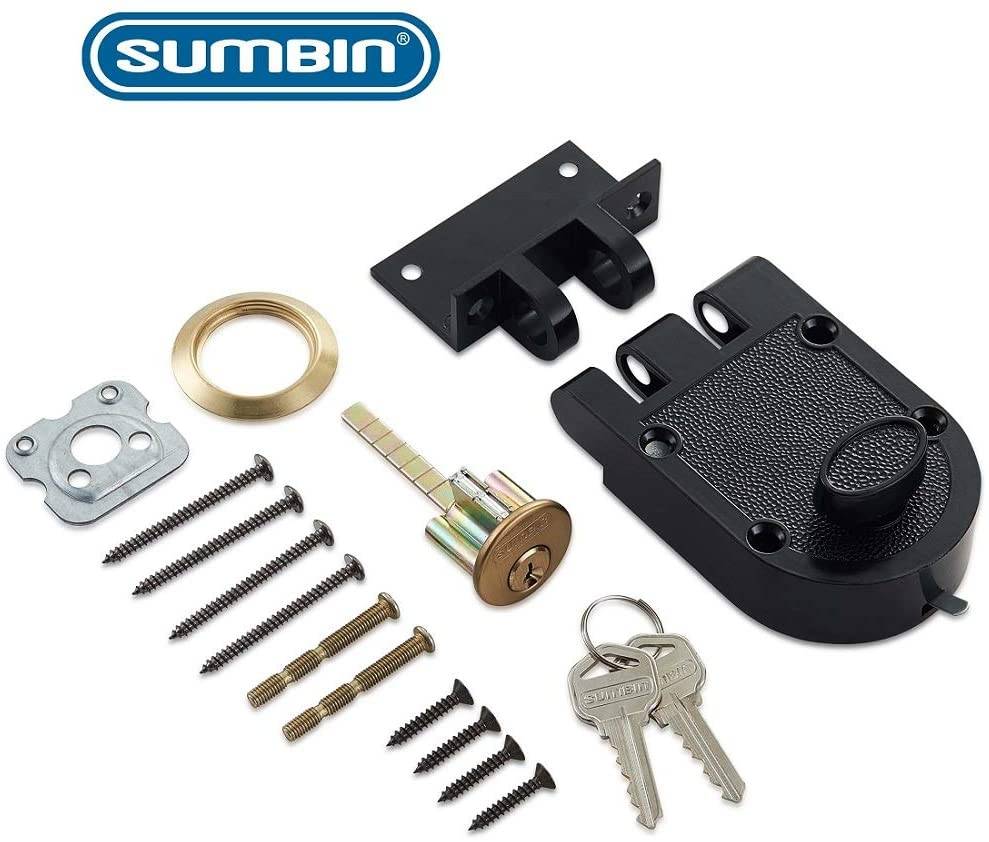

Another challenge was finding a locking mechanism that I liked for double sliding doors. Sadly most things on the market are for swinging doors. Pocket door locks wouldn't really work either they still utilized a static wall for the second half of the mechanism. Didn't really like locks meant for barn doors, cause more like generic gate latch type stuff, almost all of them external.
So I found this keyhole piston style lock on Amazon and realized it would work perfectly. Now the only external mechanism will be the keyhole.

This is really coming along nicely.
Good to see people with talent doing things.
Well done.

Thanks!
The part no one talks about those doing the DIY there is often wasted material/money as you learn as you go. I framed the doors with 2x8's with the intention of doing the slats as 2x8 as well. I wanted a solid heavy ass door.
Being a dummy I didn't actually consider the barn door track weight limits (even with a header board installed). I had to switch to 1x6's and 5/4 decking board for the slats to lessen the weight. I mean its still heavy as shit, but about half the weight.
So here I am with $175 worth of 2x8 lumber. Thankfully I still have benches and shelving to build. Well, they are going to end up over-engineered with extra lumber I have now. haha

You could always cut the 2x8's in half lengthwise and get 2--2x4's from each one to use for the shelving.

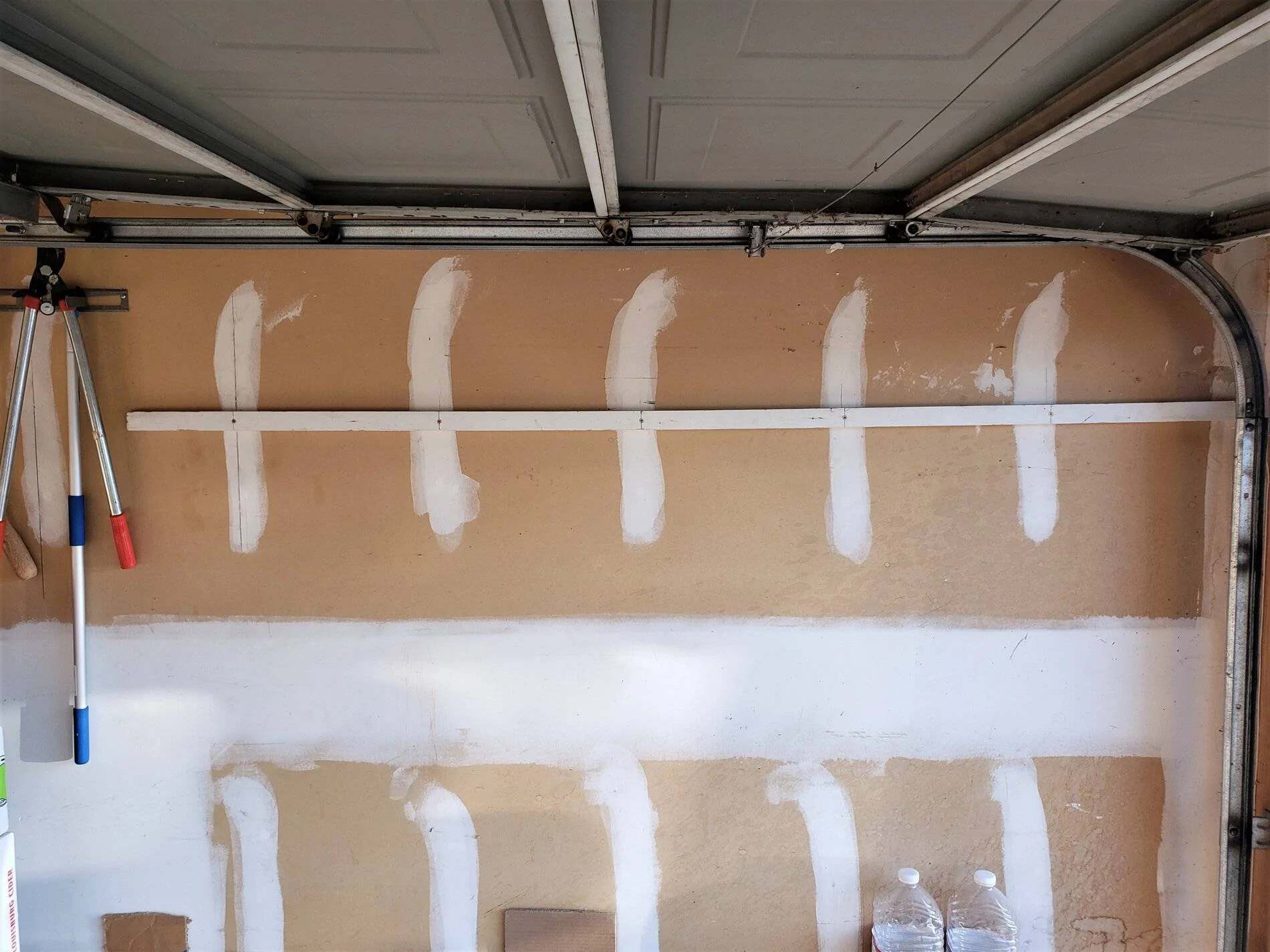

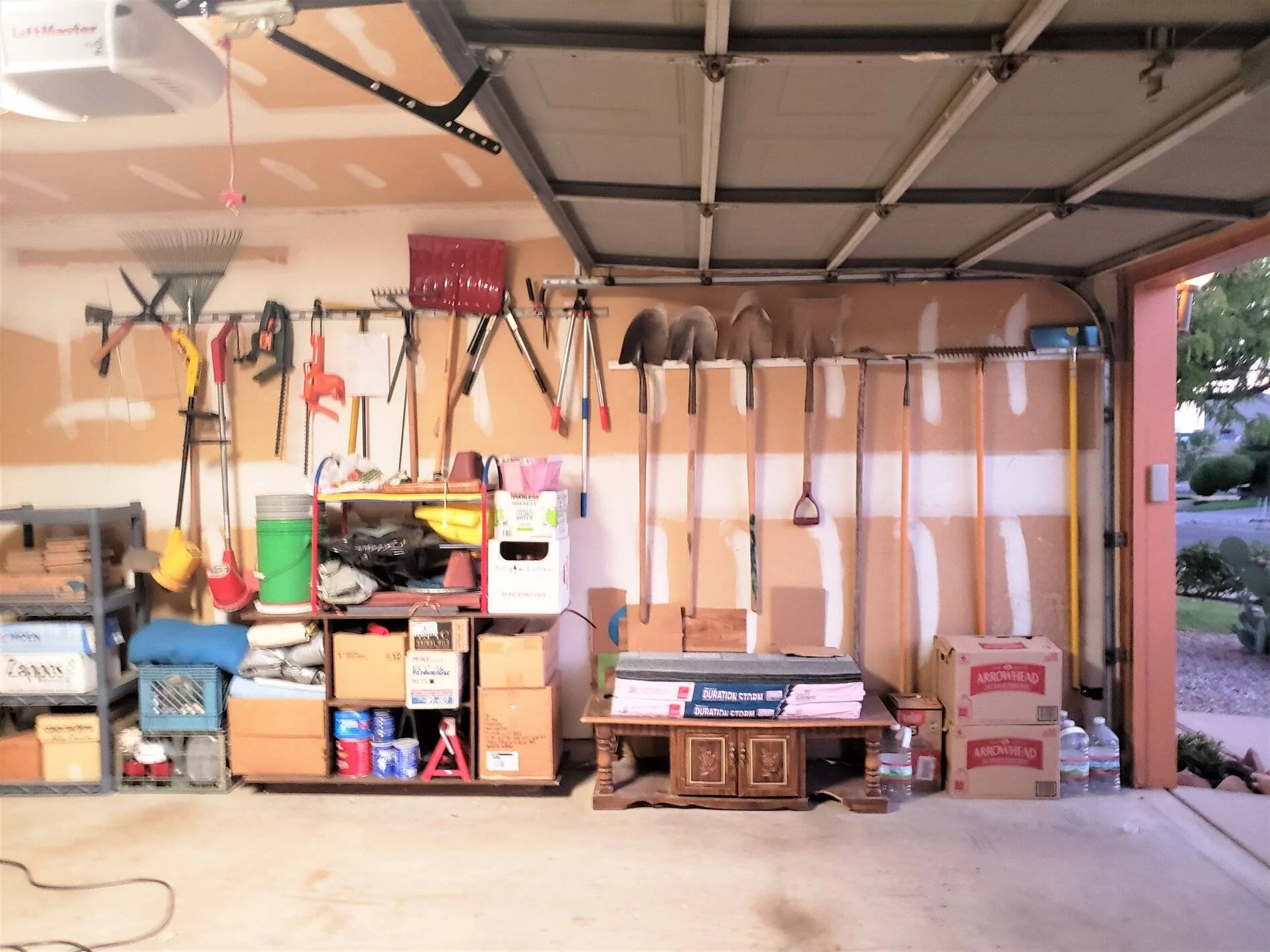

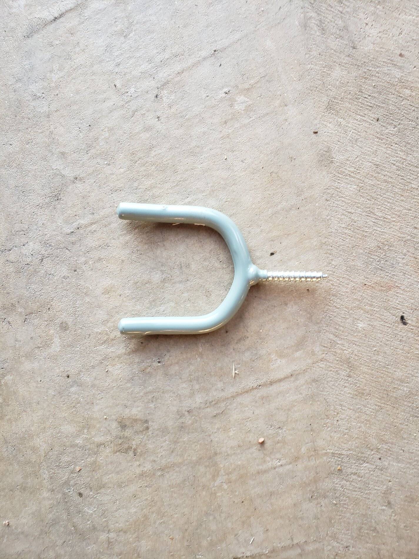

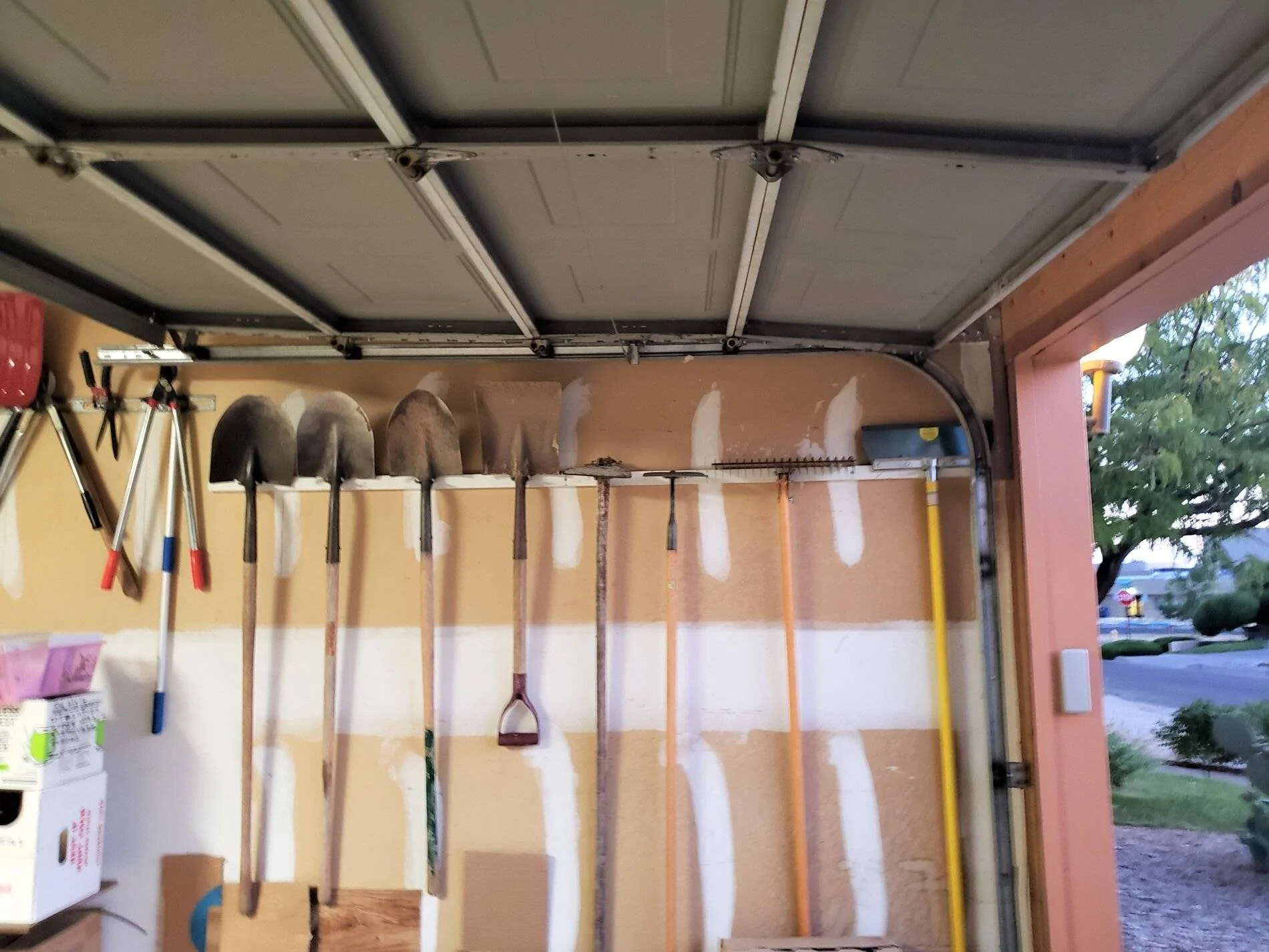

Added an additional strip on garage wall to hang tools on
1. Attached a 1"X 2" strip of wood (painted white) to the studs with 2.5" screws.
2. Inserted 8 screw-in U hooks into the wood strip to hang tools on.
3. Total cost: $10.85

That’s giving me some good ideas for my husband’s workshop.:like:

Your welcome! I searched online for an existing one and the price starts at around $50.00 if you want good quality. I already had the wood and it was a pretty easy job to do. The U hooks were only .98 each at Home Depot and are rated at 15 lbs. It is well anchored to the wall and won't come off! :)
