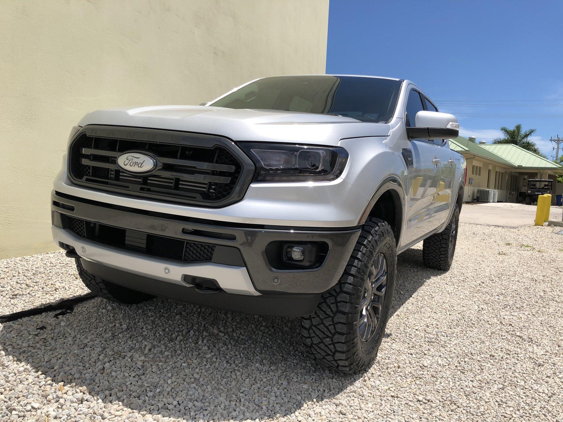

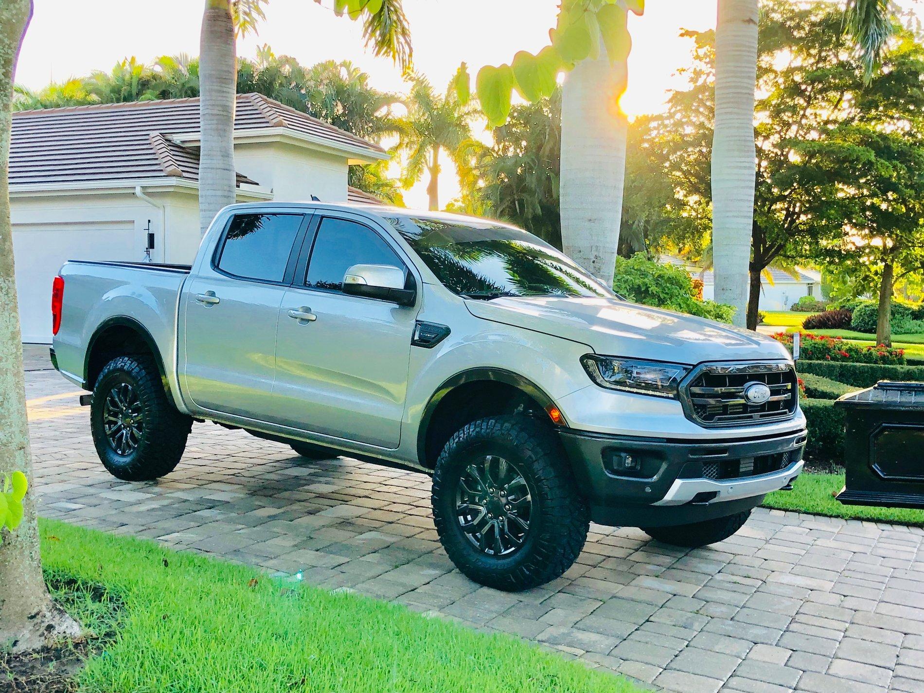

Stock 2019 FX4 Lariat
Lift/level with Fox 2.0 and OEM wheel/tire
Lift/level with aftermarket wheel/tire.
Details in my build thread.

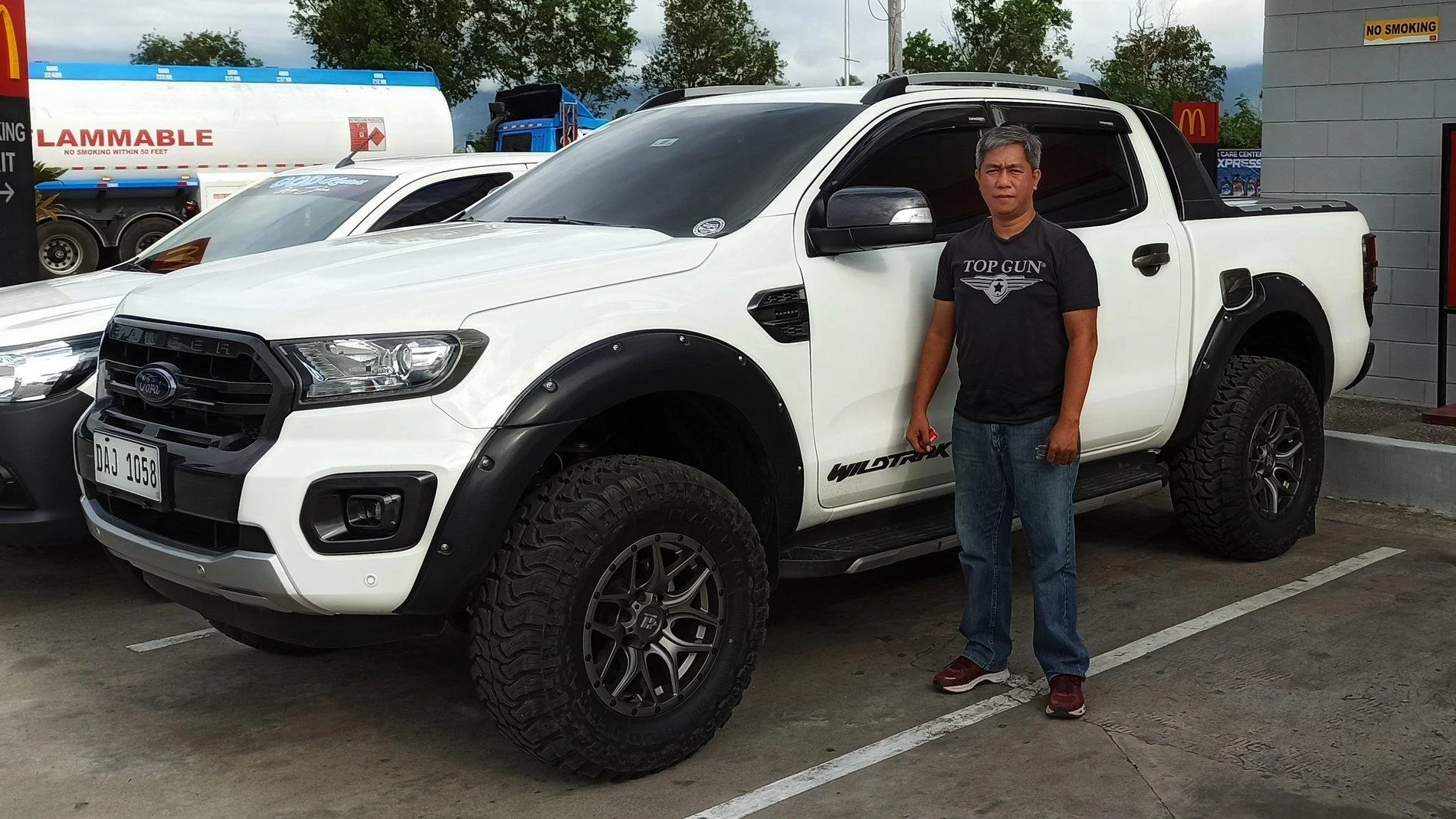

3 inch level lift from fordrangerlifts.com
285 70 17 Blackbear M/T Tires
9x17 et 12 Husla Barreta Mags
Is that set up just a 3” front level kit from that website?
Look great man, any problems thus far with rubbing or anything?

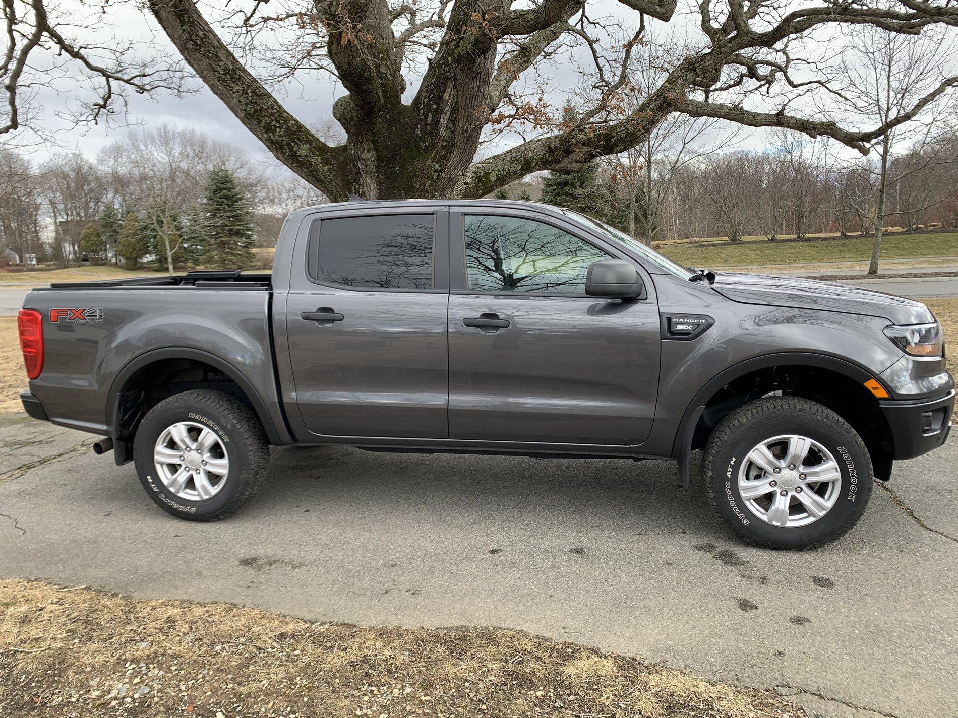

RANGER_MARC
MARC
Apr 29, 2019
1,734
4,296
Delaware USA
FORD RANGER LARIAT 2019
TEACH
Looks really good Marc. How do you like the ride with the Fox kit? I really liked the way the RC kit raised and stiffened the front end up on mine.
Hey, Dave, yeah, I really like the ride with the Foxes, definitely more stable to drive, and I am loving the higher vantage point as well!

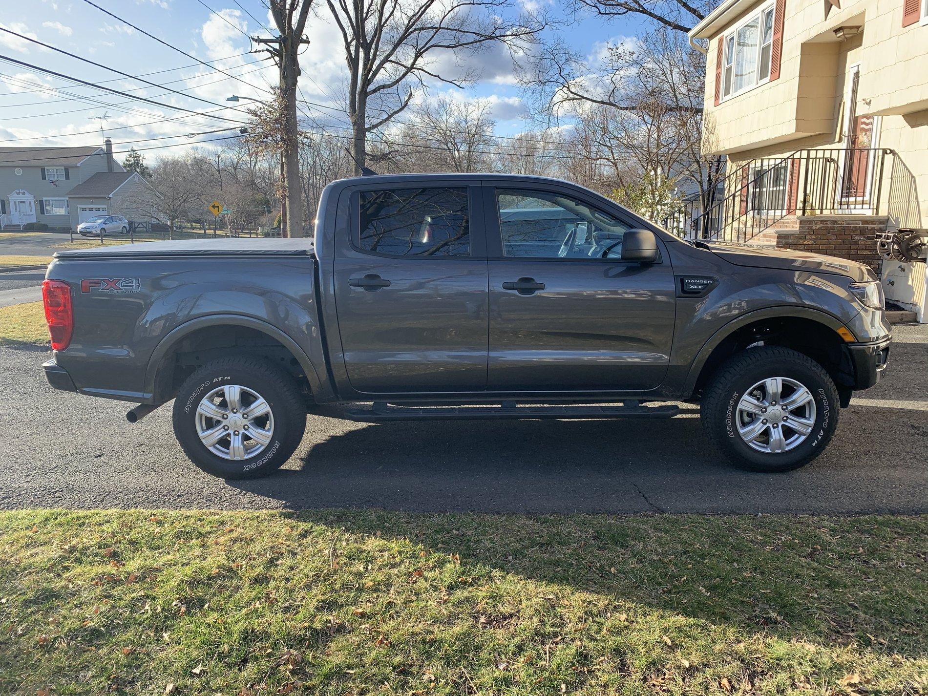

John Jenkins
Nov 25, 2019
106
Pennsylvania
19 Ranger Larait 4x4 Super Cab
I feel as if I’m a bit stiffer in the front but still a nice ride. Right now my truck sits a 1/2” higher in the rear. And I could have run next size up in tires(33”) with no issues
