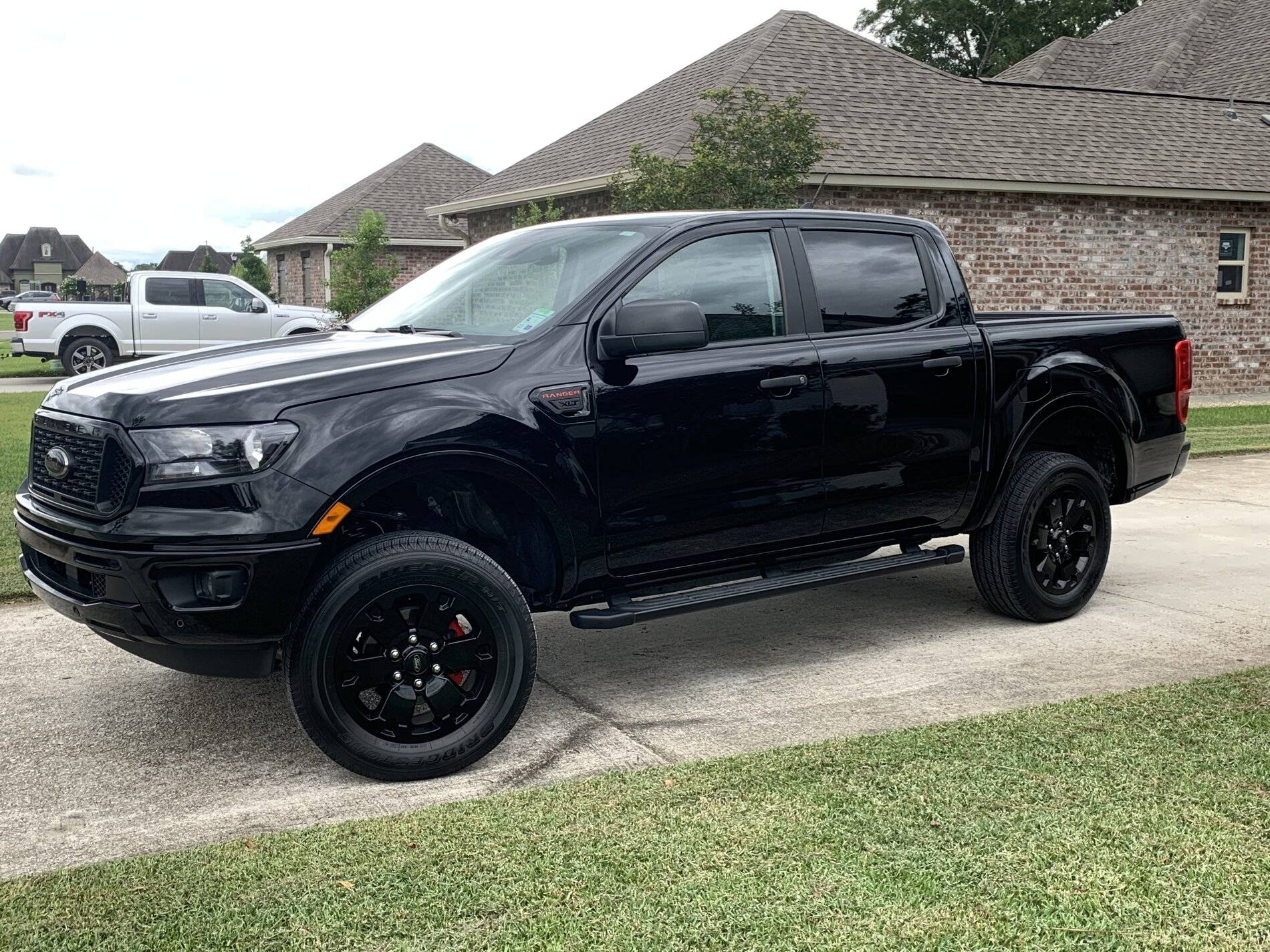

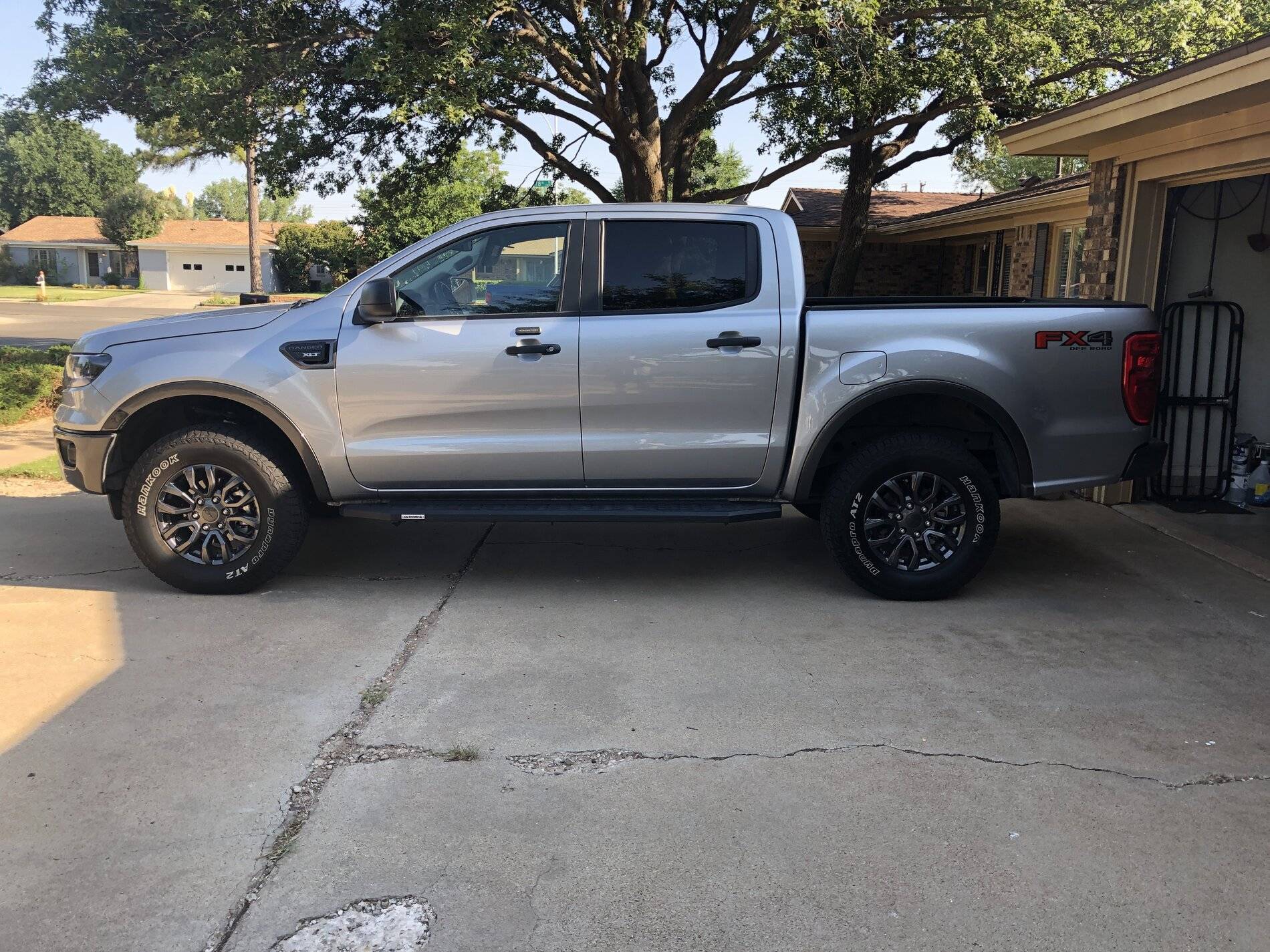

Your truck looks lower in the front. Is it stock ?
LoneRNGR
May 8, 2020
470
861
Lubbock, Texas
2020 Ford Ranger XLT
Systems Engineer

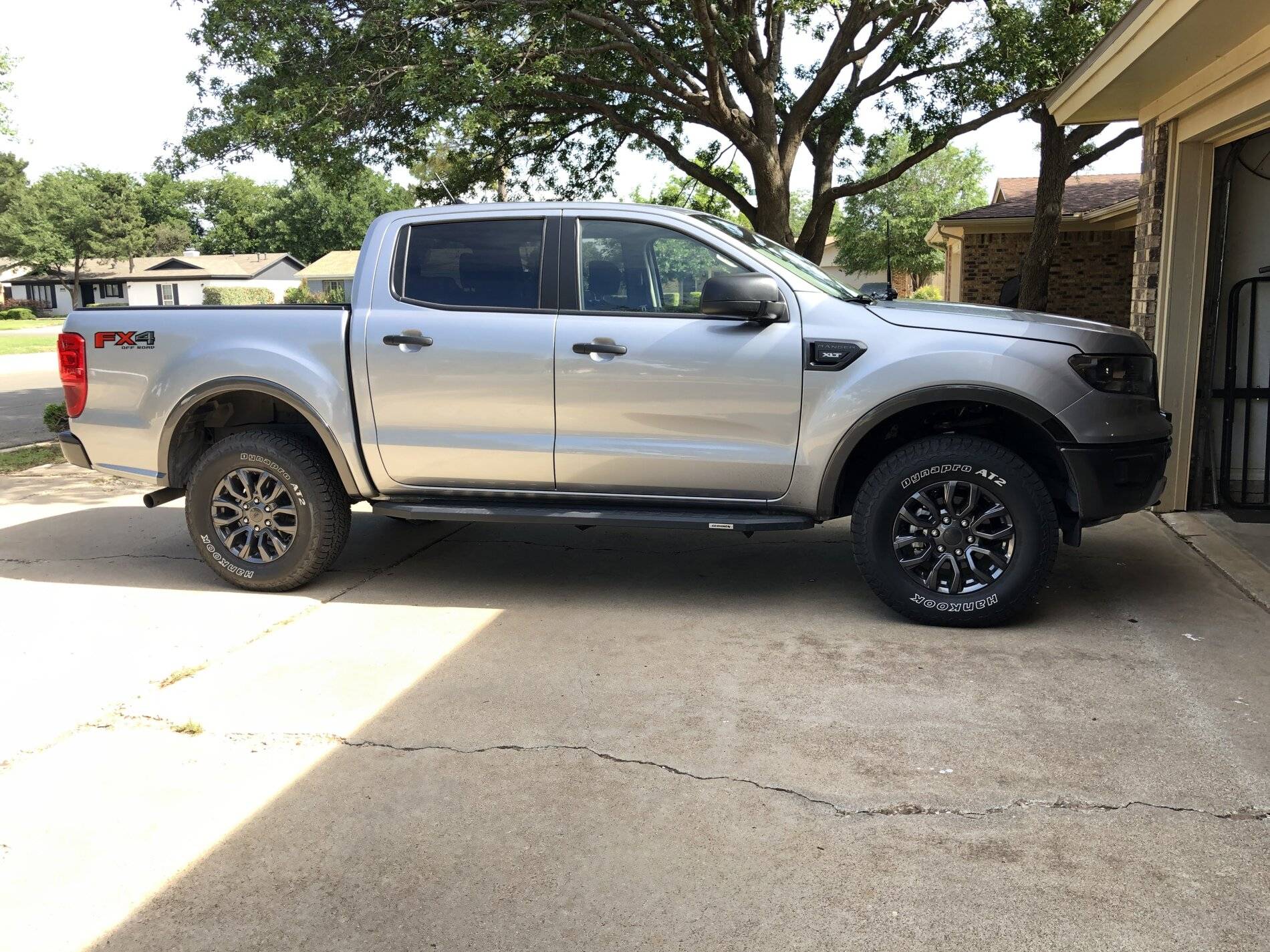

It’s not stock. Here is the other side, in case there is some issue with the camera on my iphone.

Is being level an actual thing you measure, or is it a perception?

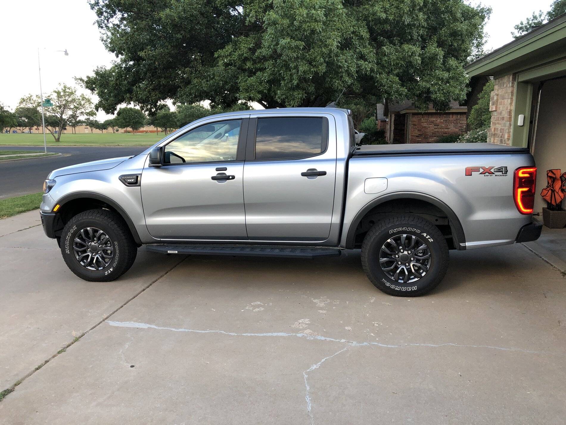

This is my truck. Is it level or not?
To me that looks great. I wouldn’t want to go any higher personally. All the 2.5”-3” kits end up looking like reverse rake in pictures to my eye at least.
LoneRNGR
May 8, 2020
470
861
Lubbock, Texas
Systems Engineer
This is my point. I agree that there is “rake,” but how much?
Here is a picture of my truck loaded down so much in the back that the headlights are pointed up in the trees. To me it looks the same.

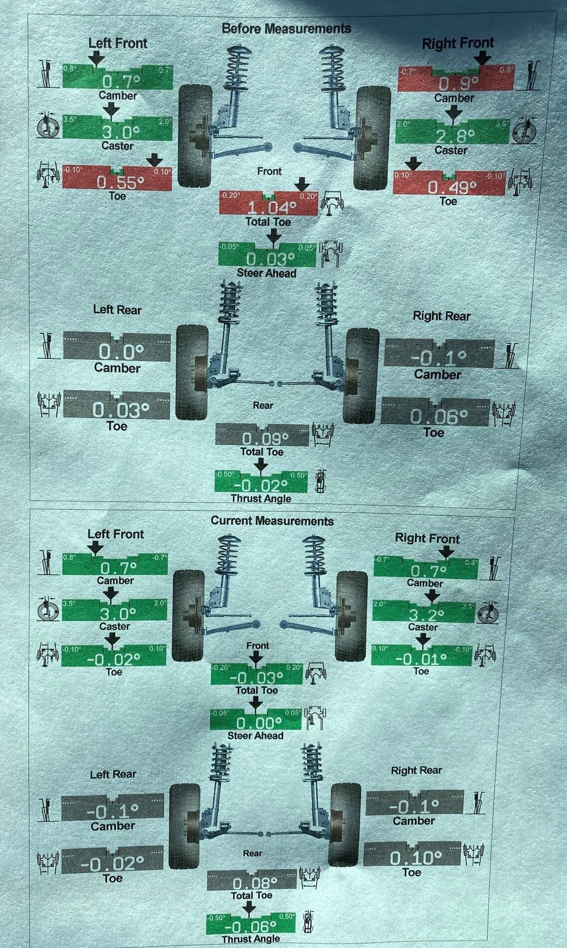

I was considering the 2.5" Bilstein front shocks also, is an alignment required following install?

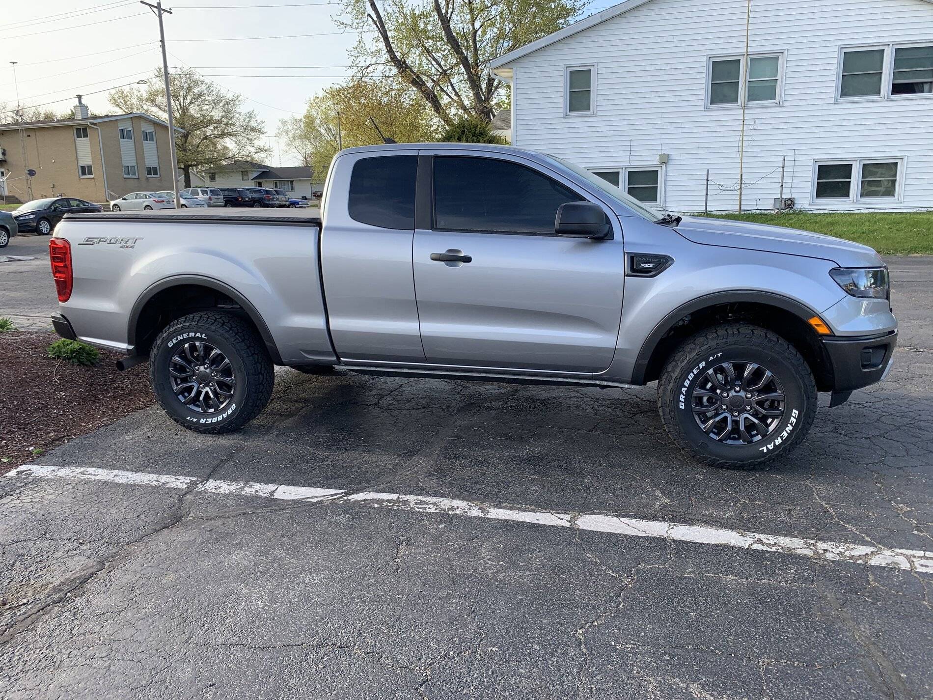

Just a question because I’m not completely clear on this. I am having a 2.5 rough country leveling kit installed next week. I ordered 17x8 wheels with a 0mm offset. I will be running 265/70r17 tires. Does anyone know if I am going to run the crash bars with this setup? Pic of truck now! Thanks!
I put a Readylift 3” SST levelling kit on mine. It comes with a 1” lift in the rear as well. Still has a slight front rake which will level out when box is loaded. It looks good.

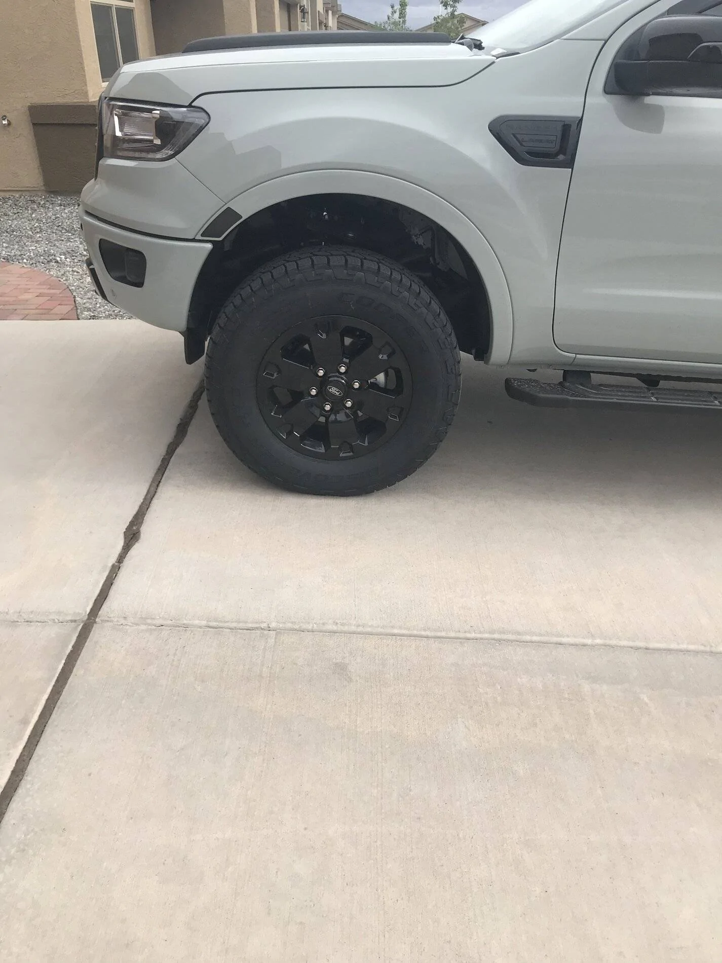

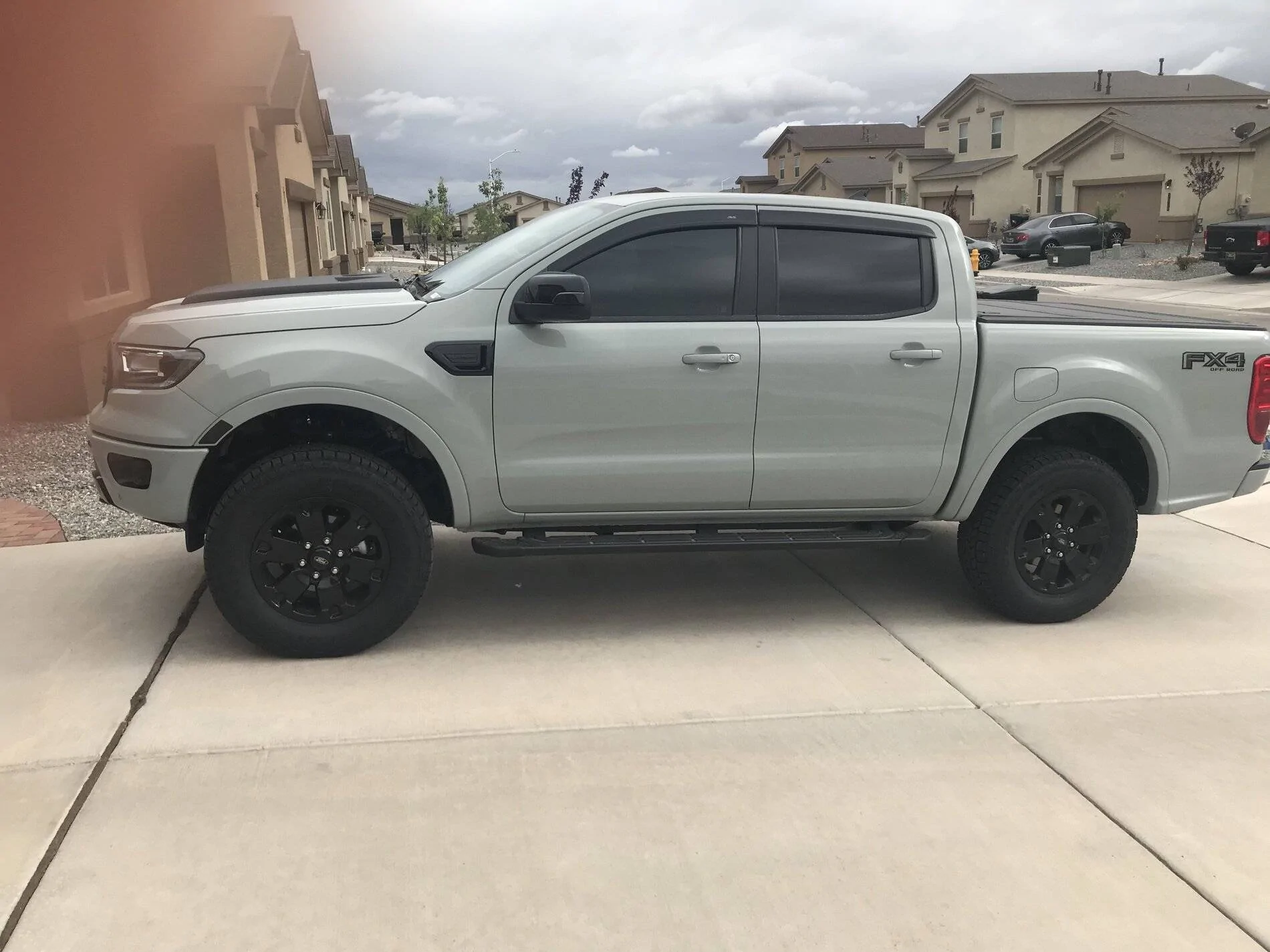

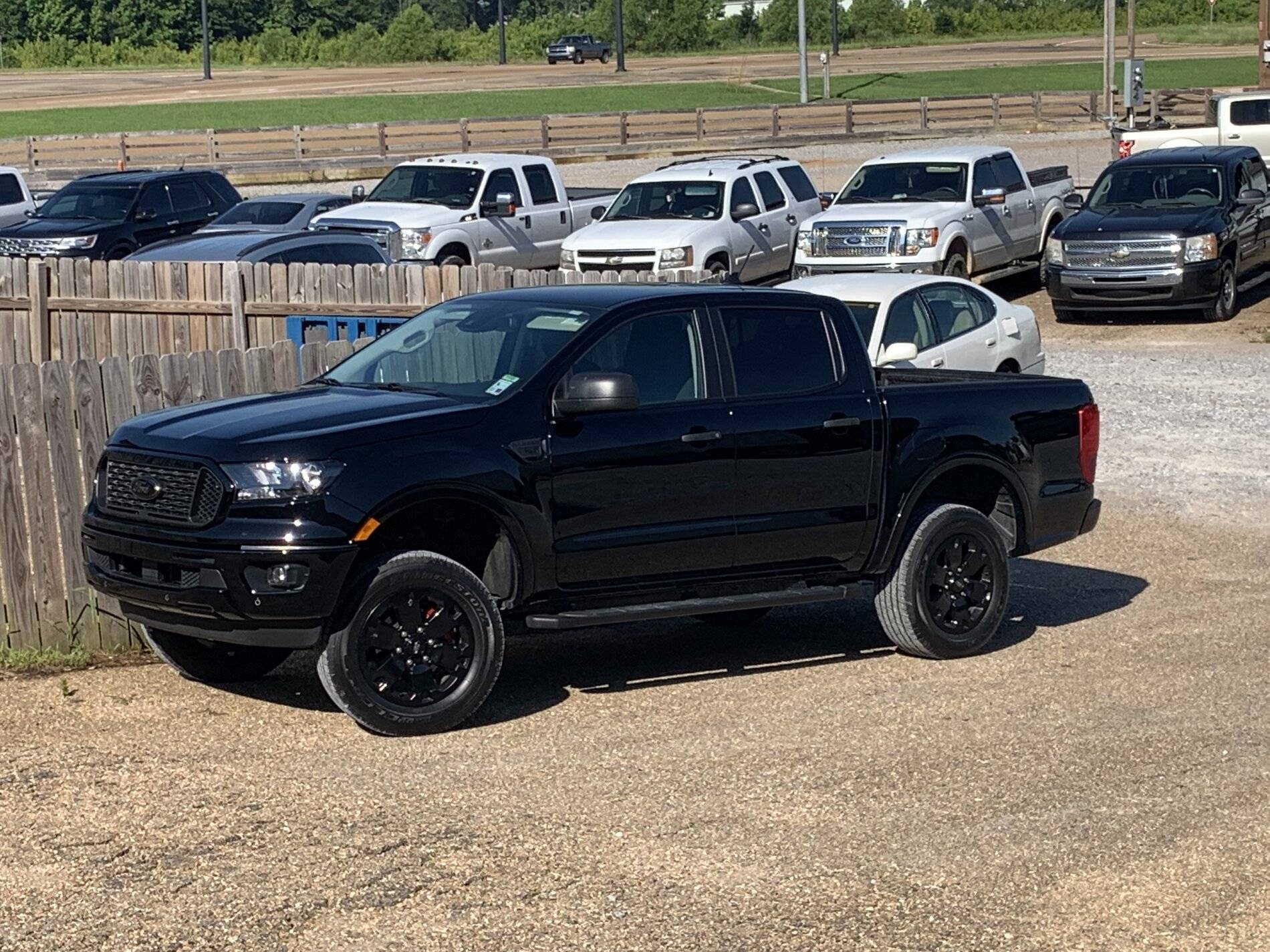

This is mine with the 2.5” Rough Country level kit, factory rims and tires. Its almost perfectly level, any weight in the bed will probably bring the nose up.
This is definitely how the truck was meant to look!

I have eibach leveling struts set to 3" and it's still not perfectly level. The front still sits just a smidge lower, which I don't mind. It looks great! It's crazy how much lift is required up front to get these leveled. I definitely needed an alignment afterwards. My alignment was JACKED after my strut install. One recommendation I can make, don't get alignment right away. Wait till you get 100-200 miles. I have to go back because after my springs settled, my steering wheel is not aligned anymore and I have to go back to get readjusted.
