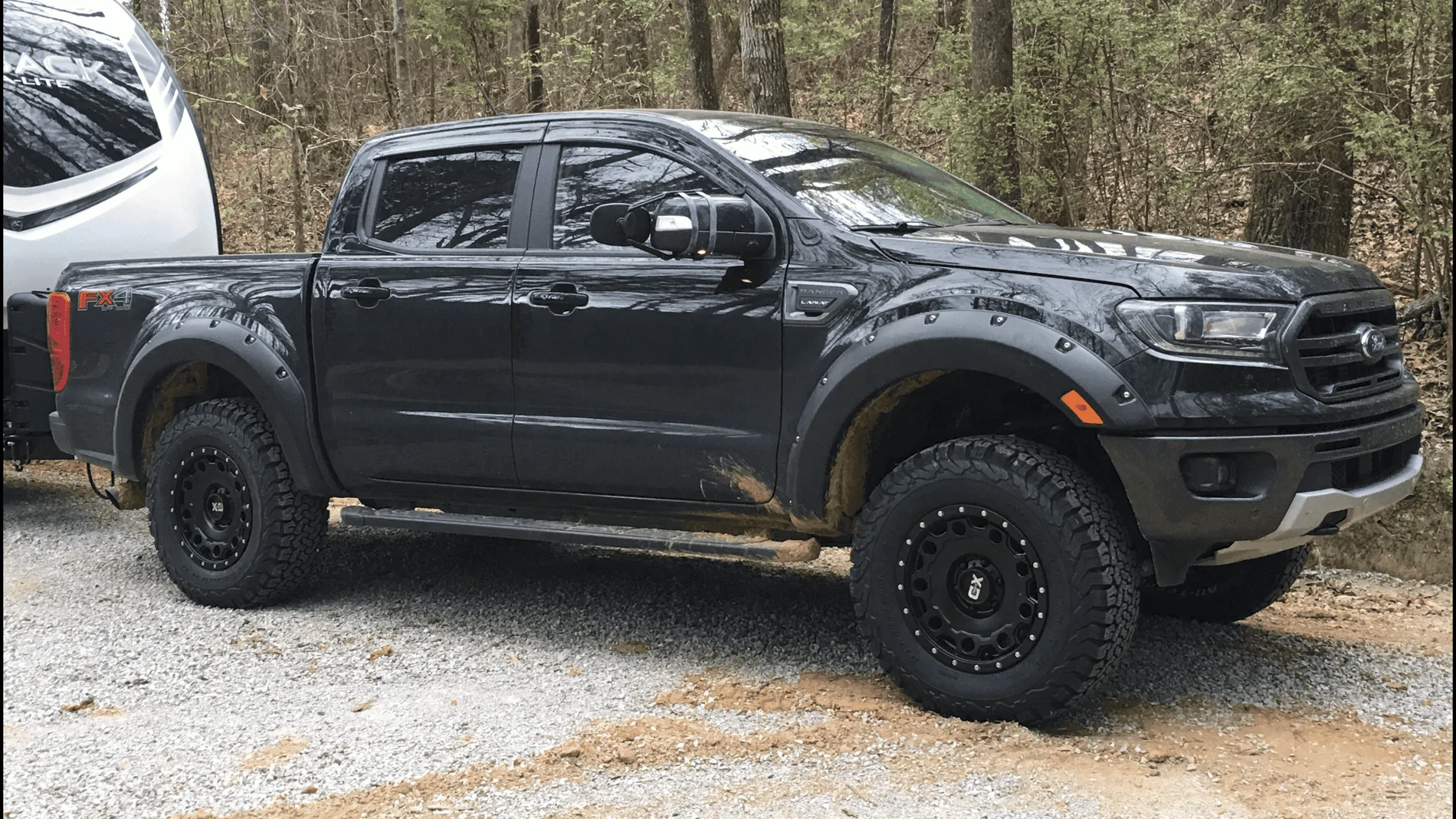

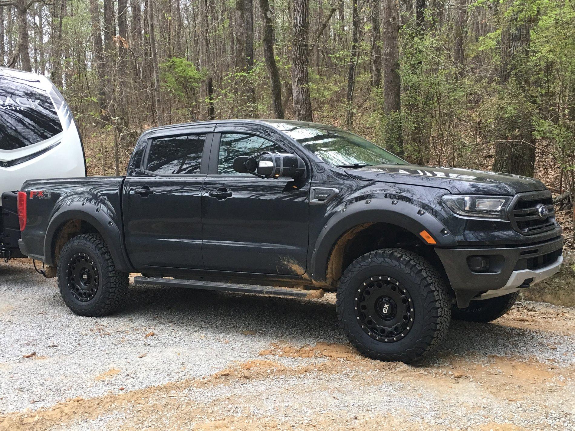

These new rims are positive 34 offset with 275/70/17’s,,,no scrub, steers and turns like factory with the lift. I almost bought rims with positive 25 offset, and feel they would have turned and steered well, but I didn’t want them to stick out too far and sling more mud and debris up the side of the truck. I think the 34 offset looks good enough and fills out the fender flares
they do fill the fender flares well from that angle. I was thinking I would need something close to zero to accomplish that.
DMac
57
80
2019 Ford Ranger Lariat
I used the tire/wheel calculator to check, and both 34 and 25 offset stayed under the truck. I think 0 offset would make them stick too far out. 25 had a little more scrub radius possibility so I played it safe at 34. Its too bad you can’t go somewhere and test fit rims. That would be ideal.
Yep, 0 offsets stick out too much IMO, looks like roller skates. It's frustrating though, because so many of the nice wheels only come in 0 offset. Luckily I found the +20 Fuels from Panda. Still waiting for them though...
