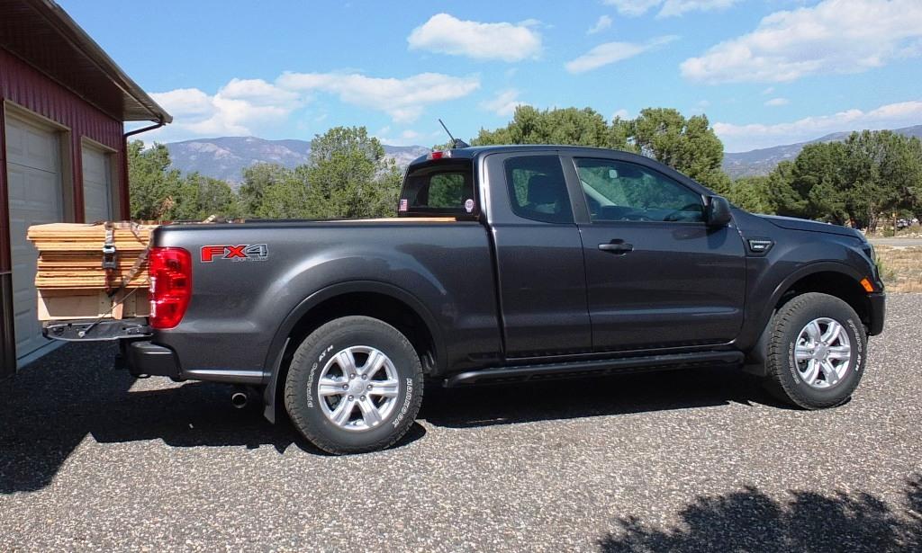

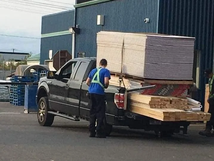

Just don't be this guy, and you should be OK.
LOL I have done many alignments over my 40 plus years of wrenchin and when you see rear camber out of spec you know it was over loaded or jumped ! Those payload numbers are there for a reason. Bret
