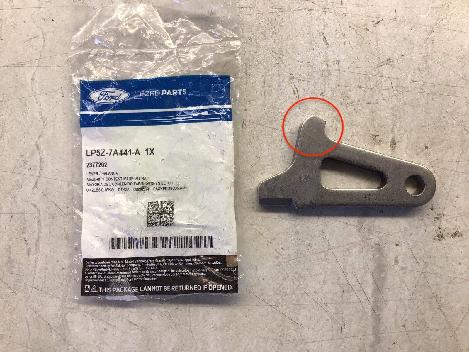

If one is on an incline and constantly uses the parking pawl instead of the parking break, guess what is going to break? That's right, the Parking Pawl. How you ask? Simple, the stress put on the Pawl will break the lever arm or teeth on the output shaft. To repair you have to hope that Ford has the pares available individually
I disagree with you on that one. The pawl and the output shaft it engages are made of heat treated steel and will take 10's of thousands of pounds of force to break either. As I mentioned before shifting into park before you are completely stopped will certainly wear the pawl which could cause a failure but the static load of the trucks weight won't.
As mentioned by mtbikernate using the parking brake to ease the effort of getting the tranny out of park is certainly a valid reason. In my 50+ years of driving I have never had an issue getting the tranny out of park on any of my vehicles so it wasn't something I considered.
And yet if on an incline the for it multiplied. I have seen one break. It isn't fun to deal with. The customer was not too happy either with the bill that was coming their way
