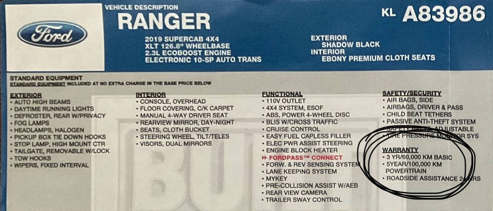

Are you sure that you're out of warranty? I just had to look at mine for an issue that I'm having, and term warranty is 36mths/100K km. Given that we're in the same province and that I didn't take an extended warranty, you should still have 5K of km to go on; of course, I have no idea when your 36 started.
Wow, that's interesting, because apparently my warranty needed at 60,000km, it's what 2 seperate dealers told me. Which I think is nuts, because 60,000km is nothing...

You Canuckleheads,
You’re mixing up up your Basic and Powertrain warranties…
Or should we rename them “Blend Door” and “Transmission” warranties? ?

You Canuckleheads,

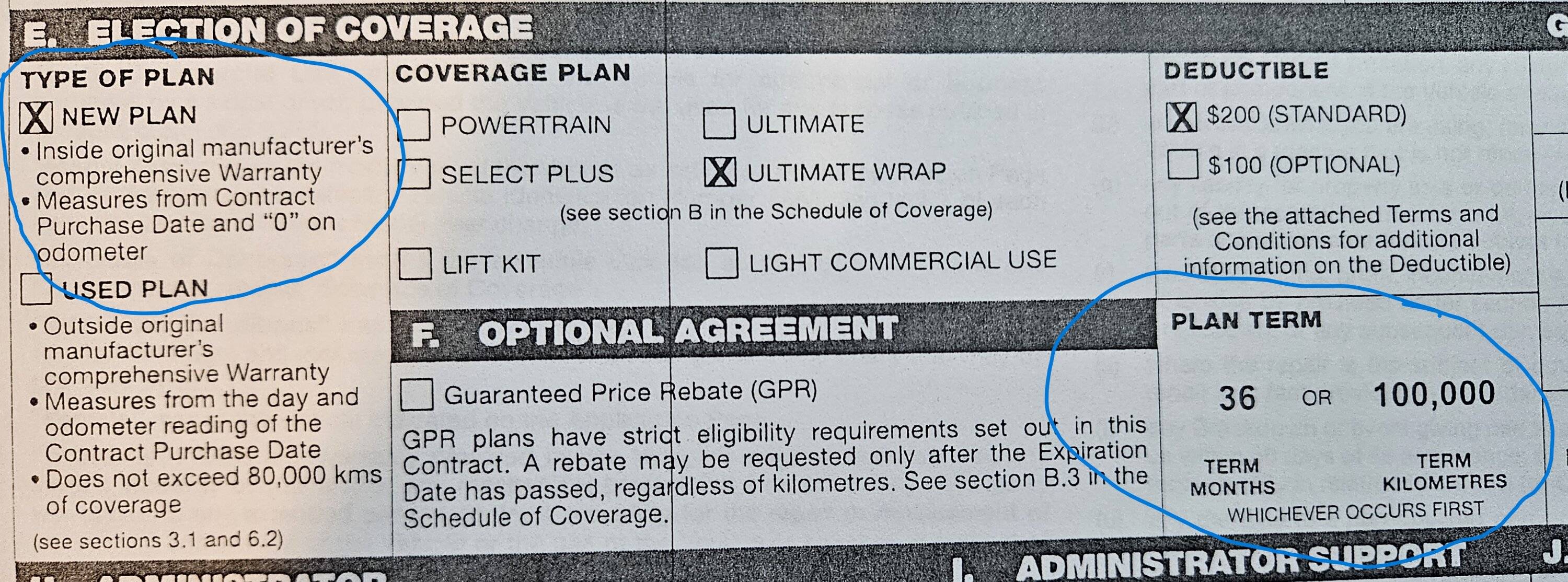

I bought mine CPO from a Ford dealership, but it didn't have that fancy window sticker. I'm just going off of what's noted on my "Time of Sale Plan" from the dealership:
That is the top coverage and shortest term Ford extended warranty, I believe. See your dealer; it probably covers the parking brake minus a deductible, assuming the truck is still in the plan's term.
The parking brake issue belongs to @Jacksonlucas1312 . I'm in for multiple oil leaks, which are fortunately still covered (I'm nearly at 24 months & just over 78K), but sure enough, I've got a $100 deductible on the job.
So that is what we call the Bumper to Bumper Warranty. After that is up you only have powertrain coverage
That seems like a decent plan when buying previously owned - not big on that deductible but it sure beats putting full bogey on a big repair. ?
