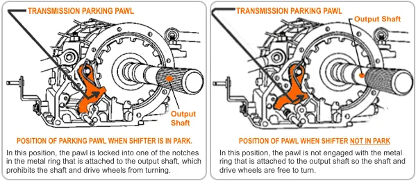

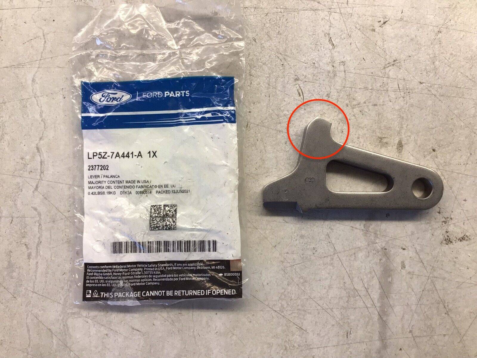

I use my parking brake every time in both the '21 Ranger and the '09 Mariner. I always select a carwash that includes an under spray. Both vehicles get washed about twice a month, and the Mariner's foot-operated parking brake has worked flawlessly since new.
It took getting torque locked a couple times to start using it always. Once was on a hill and my buddies and I couldn't rock it enough to take the strain off of the transmission. There was a pay phone near, and one of my buddies called his dad, who came out and was able to push and hold my "63 Plymouth an inch or so and I got it free. The whole ordeal took two hours.
Personally I druther use my two rear brakes to hold my 4400 lb Ranger on a hill than this thing:
2019-2023 Ford Ranger Parking Pawl
Ford 10R80 Parking pawl operation:
The truck would be sliding on the tires long before you could shear off the pawl in the transmission. The only time these fail is if people are slamming the vehicle into park while the vehicle is still moving. That will wear it down so it does not securely engage.
I would trust the pawl to hold the vehicle on a hill long before I would the parking brake.
