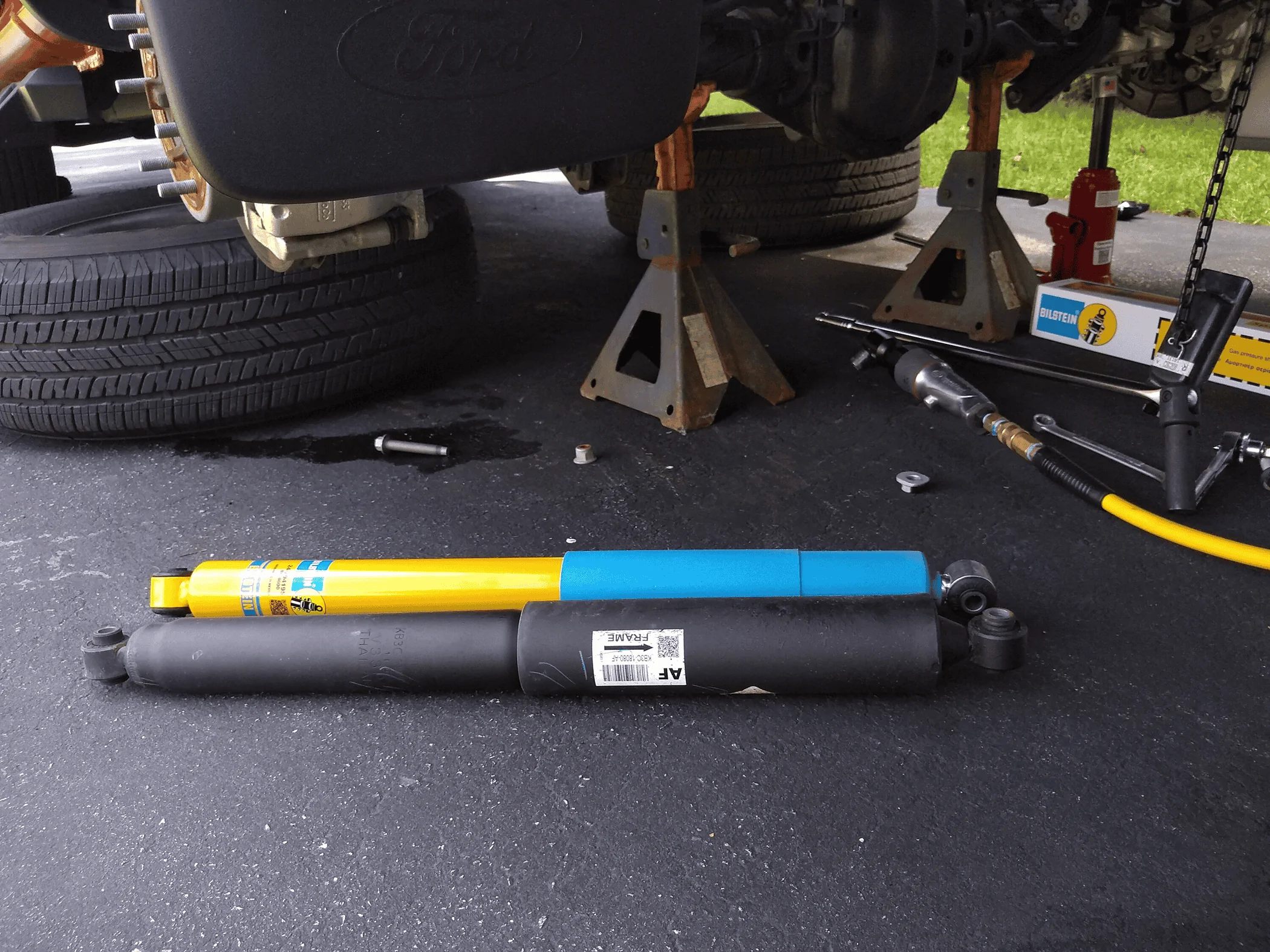

I did the 4600's for my 2WD XL. I went back and forth on which shocks to get. And like you, no lift and I'm also on the pavement all the time. I find that it does make a difference for that head whipping when hitting bumps or potholes, especially while turning. It's not night and day, but it seems like a gentler ride ...
It was easy, no need to do what I did, but I spent an afternoon of it and made it as easy to get to as I could. Many do it without removing the wheels.
