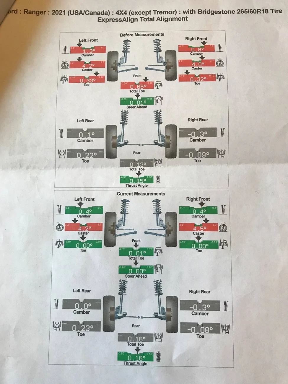

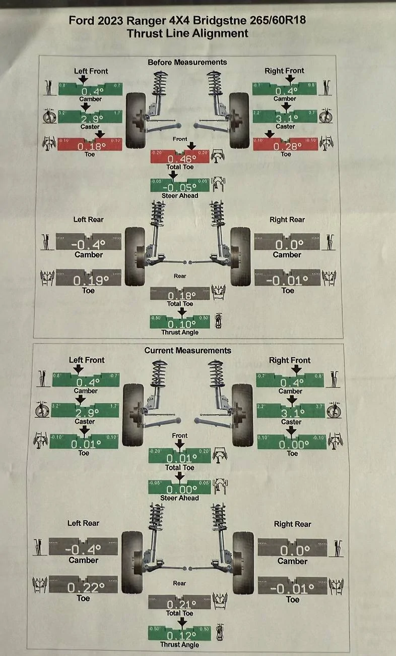

Off subject but can you post your alignment specs photo please if you got one. Thanks

Here

About the same as mine. At .4* it’s going to ware the tire. This was before and after the lift in the front
