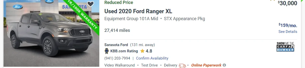

if you really want a 101A have you considered a CPO one? There are a few out there....noy sure how the pricing compares to new.
