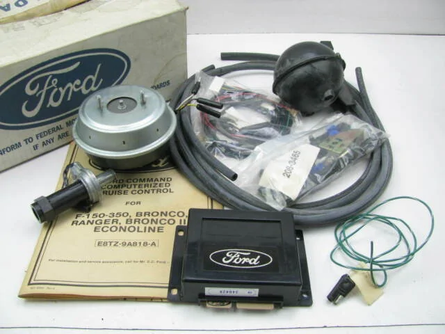

Ford offered Ford branded, dealer installed kits in the 1980s for many applications. Unfortunately, I heard it was trouble prone after about a year - control module was junk I was told.
