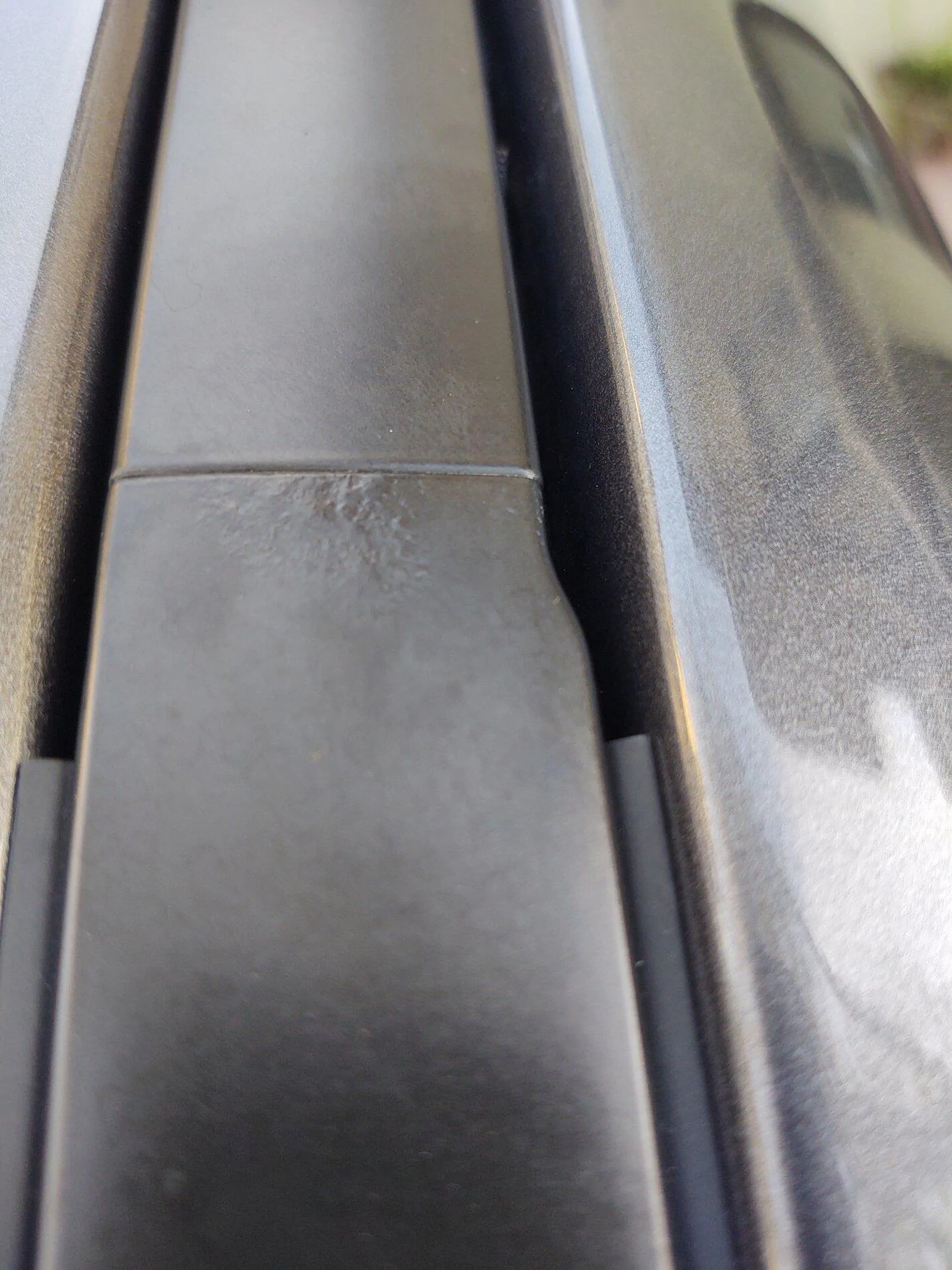

I have seen some complaints about paint chipping and flaking with dings, but I have an area on the drivers side passenger roof rail that is peeling and lifting. No idea how this could have happened other than if being a defect. It is bubbling and lifting.
Would this be something covered under warranty? Or is this an easily replaceable part? Truck bought July 2019 and have 30k on it.

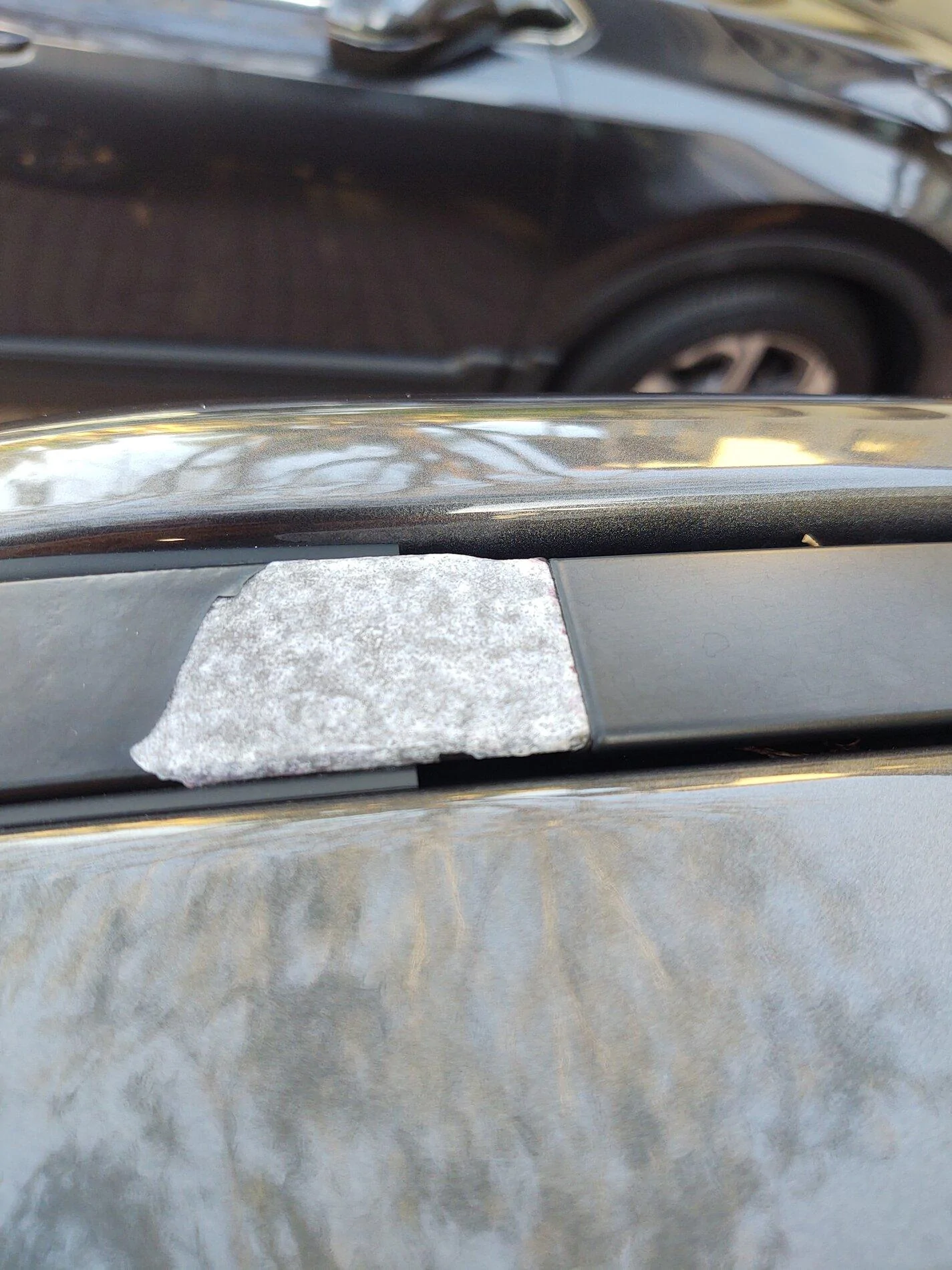

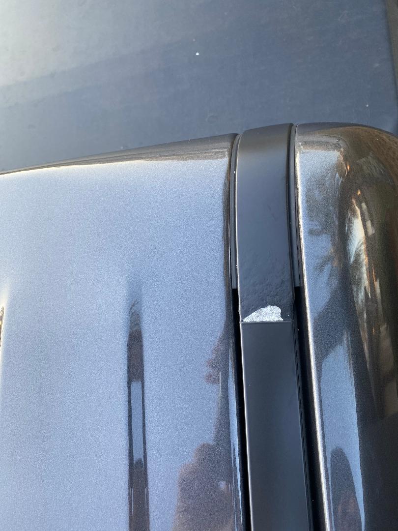

My truck was built in the first half of 2019. Looks like I'll be taking this up with Ford:

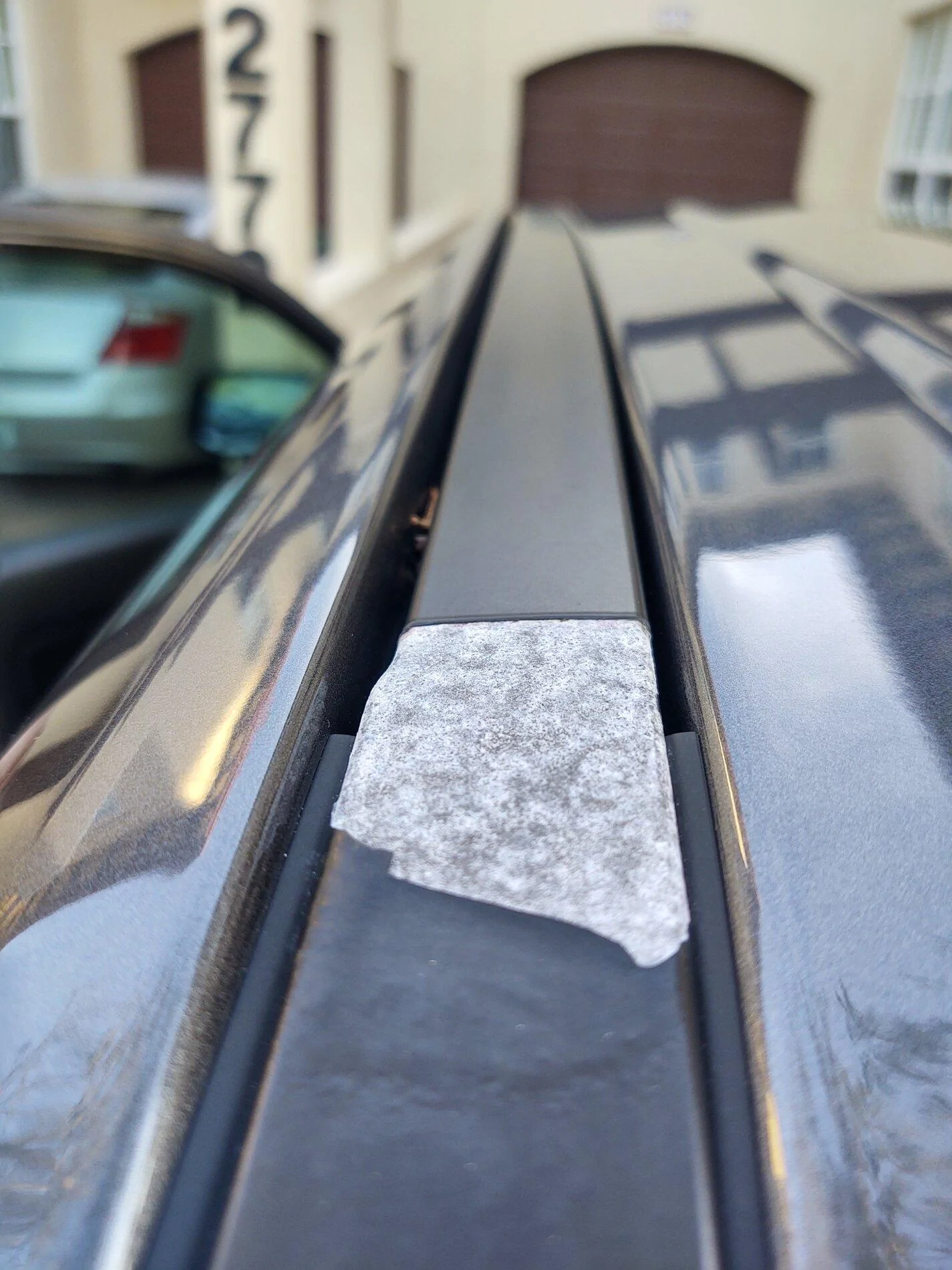

And bubbling on the other side:

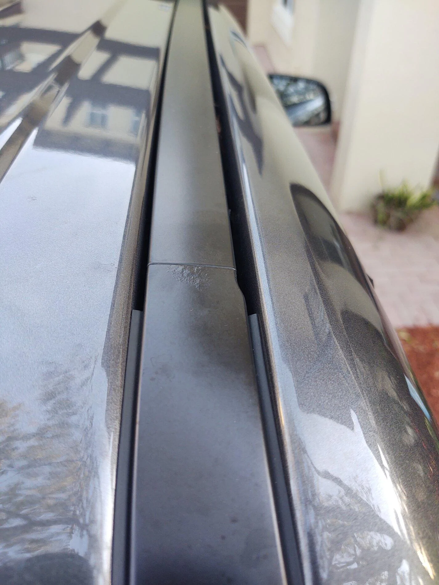

It's not so much a rail. Mainly there as a decorative piece to cover up the weld where the roof skin is attached to the rest of the body.
I'd be very happy with something steel and body color matched.

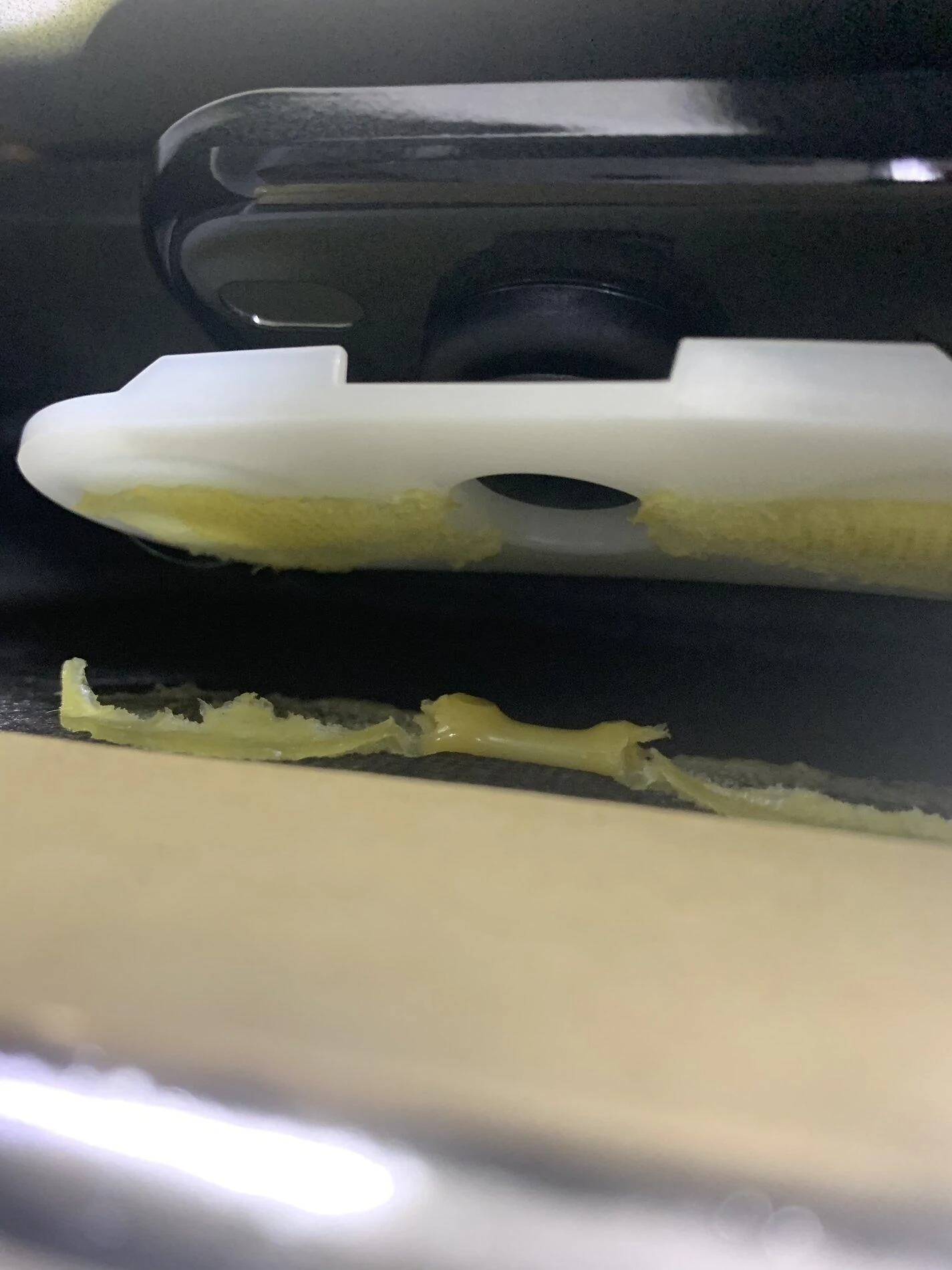

Today I had the roof rail replaced due to the paint defects. All is well now with that with one exception.
They had to remove the headliner to replace the rail. I dont think they installed it back together correctly as the dome light area of the liner seems to sag and has a lot of play to it. I can push it up about an inch or so before hitting the roof. I didnt notice this before. Should there be some kind of clip or other attachment keeping this snug to the roof?
I can't find any attachment points on the replacement parts diagram for this but cant imagine it is supposed to be this loose.
Can anyone verify for me on their rangers if they can move the headliner near the dome light? Appreciate it.

There is an attachment point. Glued to the liner just behind the light with the other end a magnet to the roof. Still waiting to get mine fixed.

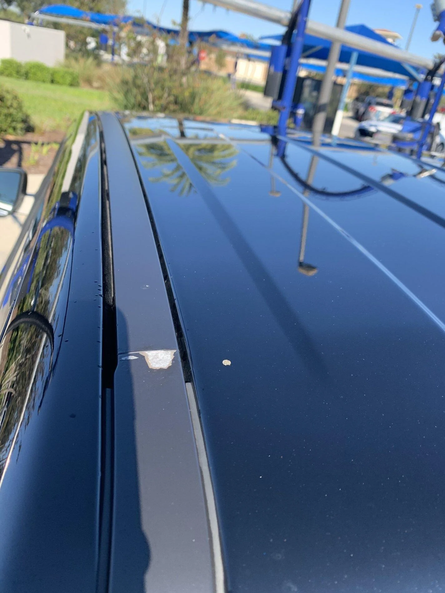

Thanks

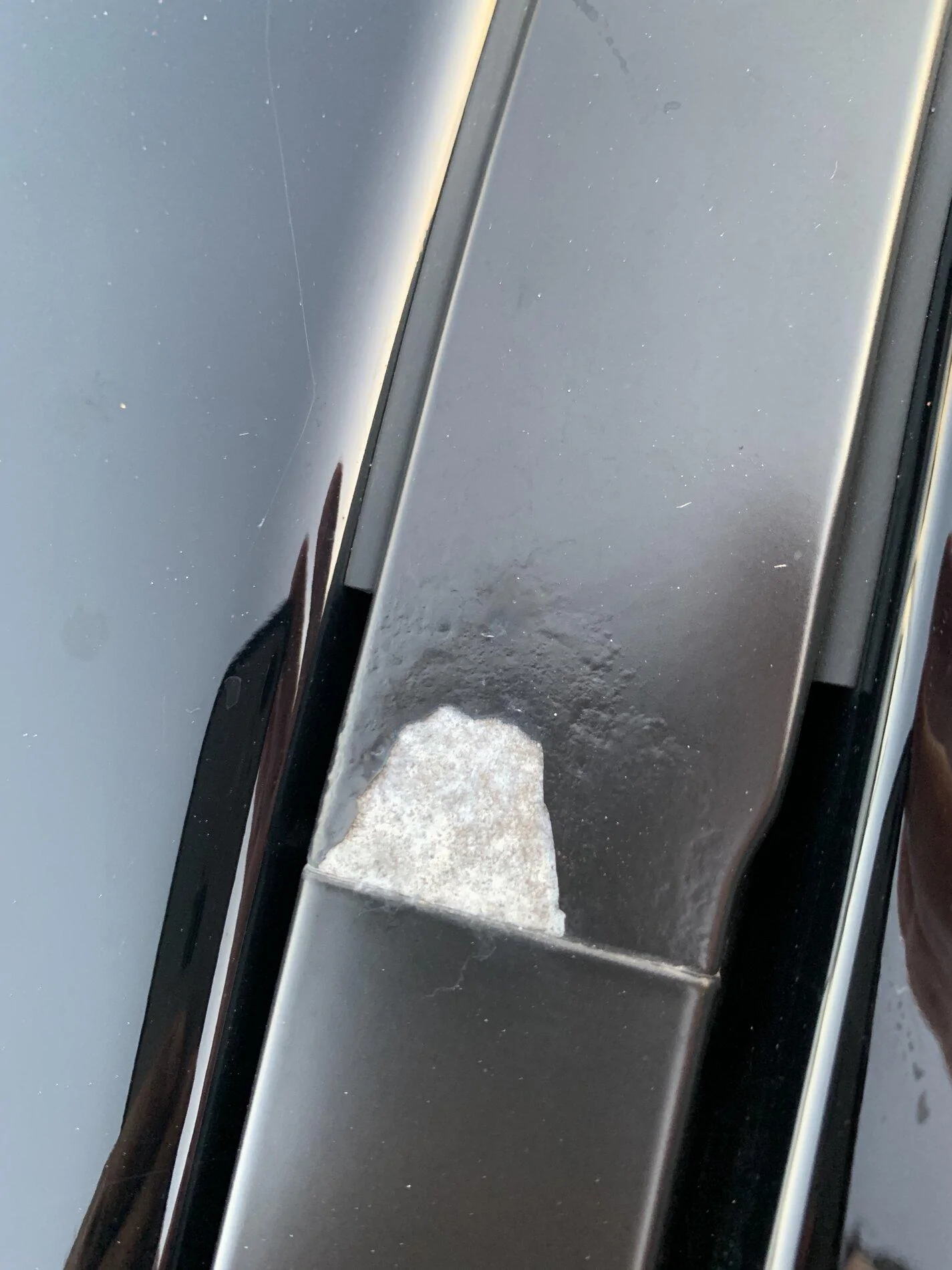

I didnt see any impact damage, it really only seems to be this end rail piece. Just seems like a defect in the paint. Here is another closer view where you can see the bubbling.
Not sure what the outcome with warranty was on this, but I have the exact same issue on my 2019 Lariat. Plan on discussing with Dealer this week during a scheduled oil change.

It was covered 100% under part replacement. Don't let them send it off to the body shop. Also make sure they dont damage your headliner when installing it. They are supposed to remove the headliner and my dealer cheated and only removed one side and pulled it down causing the center mount to rip off. Still waiting on getting that resolved.
