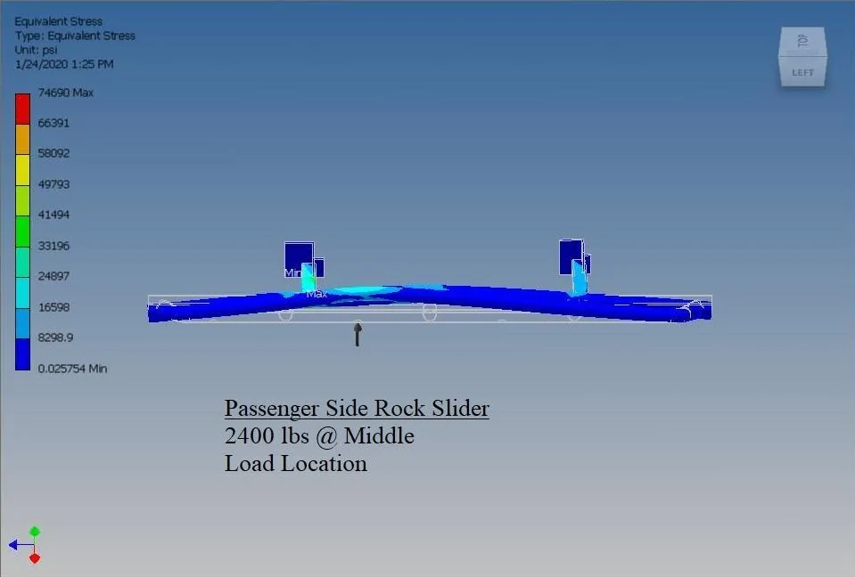

I ran some FEA to determine deflection back in January 2020. Under load pretty much everything deflects... it's just a matter of how much. Here's a LINK. Where did you lift on the slider at?
There are 2 issues at play here.
1.0 The frames on todays trucks are very thin compared to back lets say 10 or 15 years ago.... and that's by design. Frame flex is the bulk of the deflection issue.

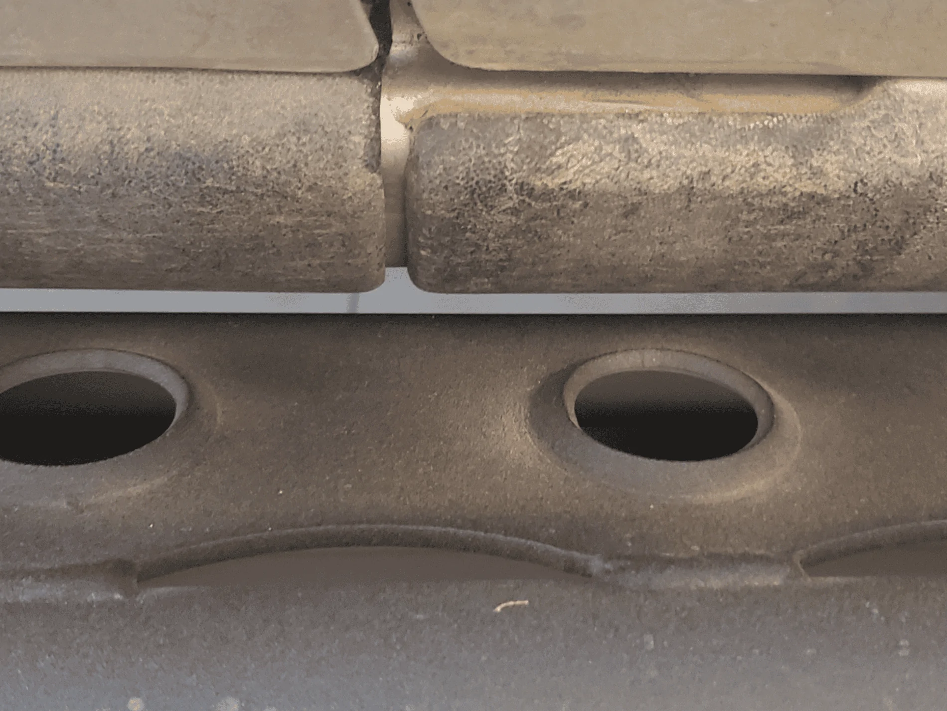

2.0 The other issue is the dimpled plates are crazy close to the rockers. I posted early in the year how ice buildup between the sliders and the truck creates a banging noise... since the cab being rubber mounted moves independent of the frame. Here's a LINK
If you are wanting to jack the truck up by the sliders..... don't buy the dimpled plates.

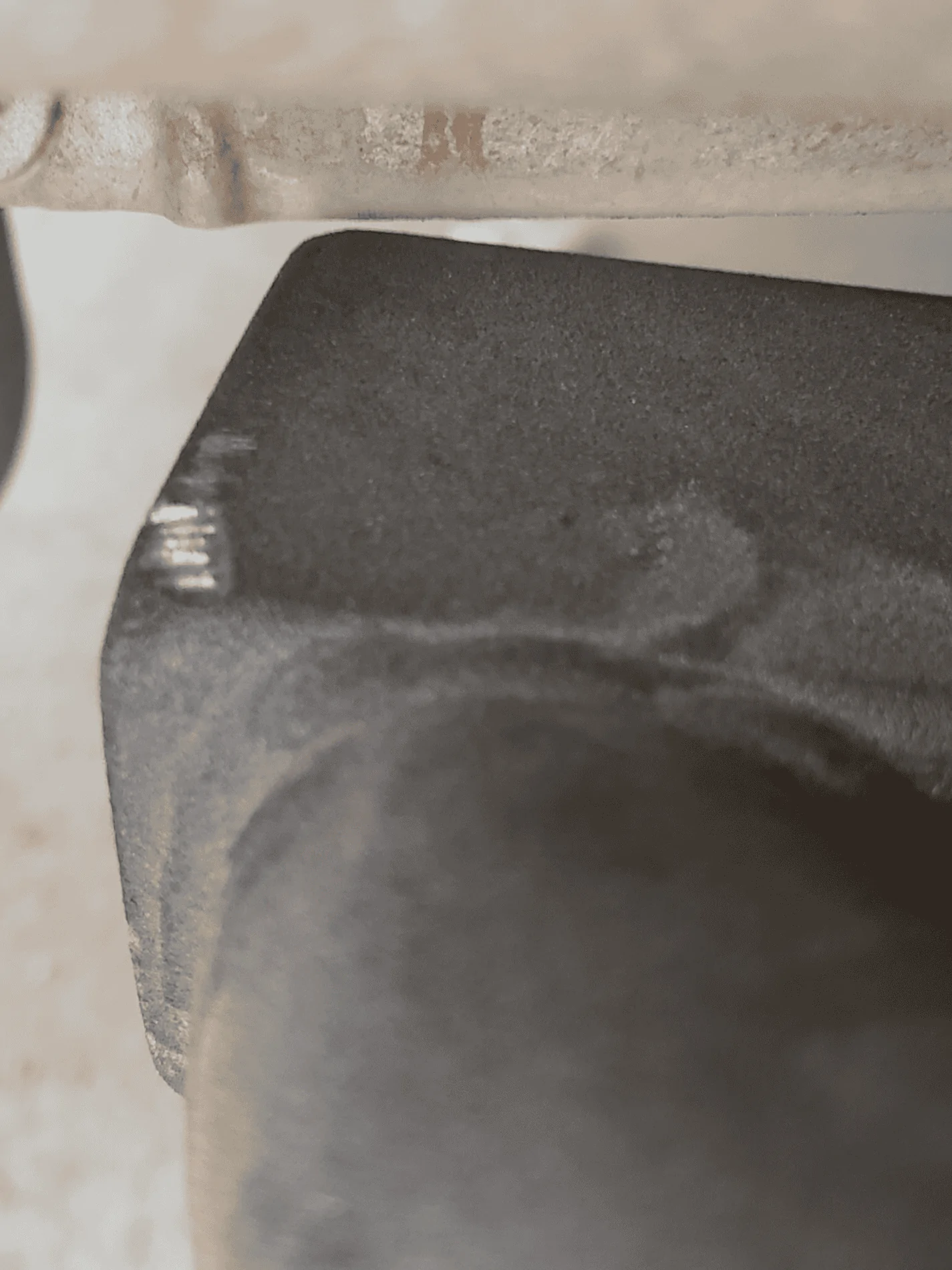

Upon further inspection my body does have a dent from where they've hit it in the same location you're talking about.

I just did a little experiment and if you jack it up from the center of the slider it doesnt flex hardly at all but the closer you get to the ends it starts to flex more.

Curious: Did you jack up on the round tube, or the square tube?
And that real world test verifies the FEA. Deflection lifting at the end of the slider is about 3/16" lifting 1,200 lbs. Deflection lifting in center is less than 1/8" lifting 2,400 lbs.
Lifting between the supports is the best method.... which of course makes sense.
I'm still curious what location on the slider that @Andy was lifting on?

I'm going to send Shrockworks some pics - after seeing the latest thoughts in this thread, I inspected the install a little more carefully. Found driver front end to be only an eighth of an inch from the pinch-weld. I don't think that will do the trick with all this flexing y'all are talking about.
kinda concerned about the space midway too:
on the passenger side, I can slip my fingers in there a bit - not on driver side tho.
Yeah. Definitely post what they say. Mine have made contact with that pinch weld but barely.
weird, on mine the longitudinal square tube sits out past the body pinch weld. the only part close to the pinch weld is the two short extension tubes, and they're about 1/4" down front the pinch weld and show no signs of contact.
