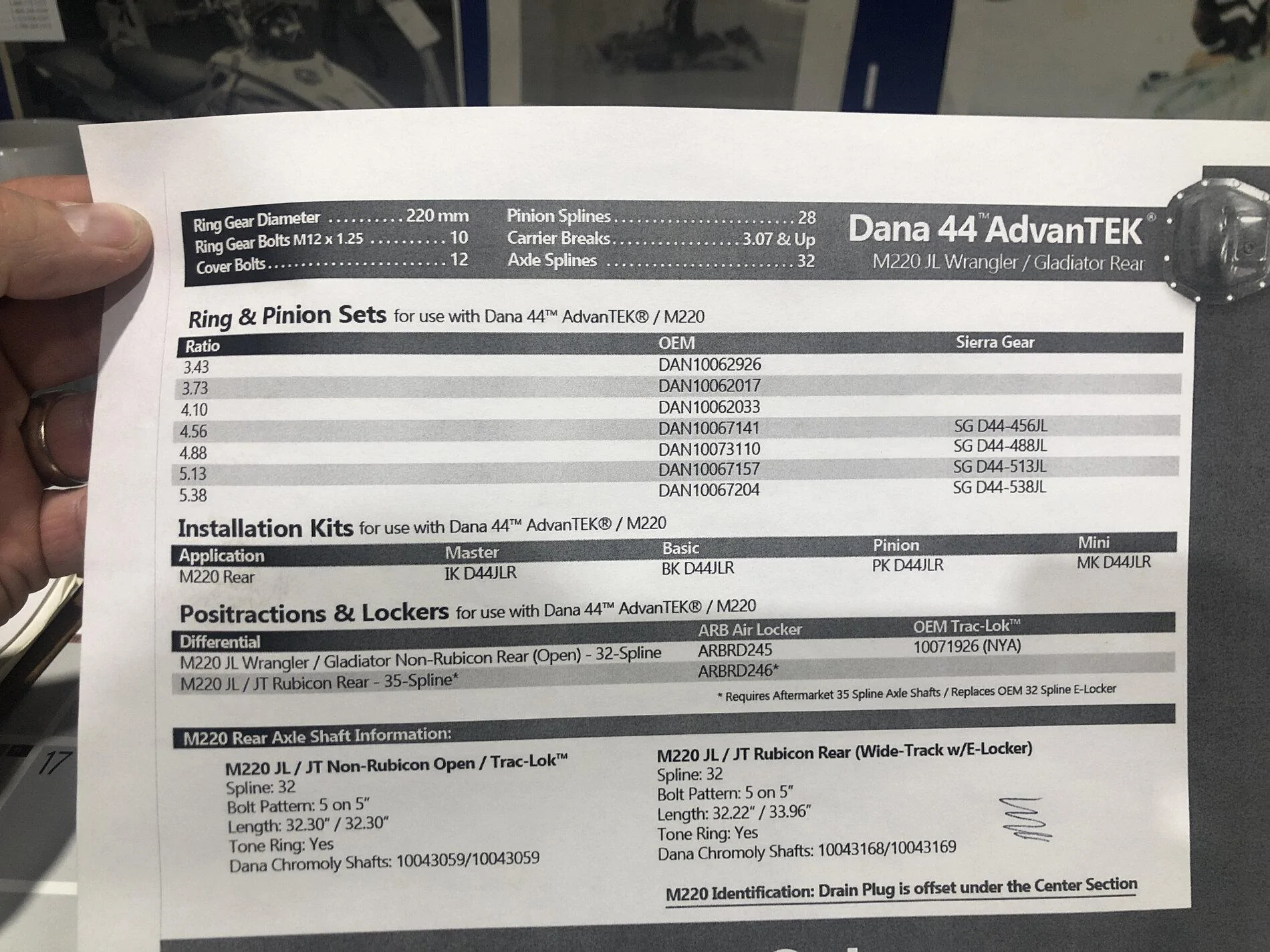

Im ready to make a gear swap in the ranger to 4:10. I’ve really exhausted my self over the past week attempting to find the correct part number. Reaching out to several places and hours of internet time. I’ve come up empty handed. It’s been suggested by Stage 3 motorsports and the pinion shop. That the stock 3:73 replacement gear set is identical to the Jeep Gladiator. Stage 3 even lists the stock replacement as part number. DAN10062017. Quick search and it’s the same as the Jeep’s Dana 44. Tempted to order the 4:10 gear set from the same PN list. But trying to avoid down time if it’s not correct. Not to mention returning it ect. I’ll post the part number list that I’ve seen. Thanks

Those gears will work, but there's some HUGE issues right now.
Technically, yes, Dana Gears for the M220s will fit the Rangers with an M220.
However, there are currently no install install kits for the Rangers as of yet, and from our understanding, there are some differences in bearings/shims/crush sleeves/pinion nut between the Rangers.
Secondly, the rear gears are welded to the carrier, to they will need to be cut off. We STRONGLY recommend a professional install and budgeting for a replacement diff in case things go pear-shaped.
Most importantly, there aren't 4.10 fronts for that 29-spline Ford Clamshell IFS yet, so if you have 4WD that you actually want to use, doing gears probably isn't in your best interest.

Jason, very pleased to hear that the gears will work. I had a good feeling but definitely wanted to confirm. I did measure the ring gear and bolt spacing. It’s identical to the Jeep. But have not removed my pinion. I was concerned that the machining on the pinion may have been different between the 2.
There is a ton of conflicting information on the welded differential...... This is what I have personally verified.
-The standard non locking differential has a welded ring gear from the factory. ( fuel mileage was apparently the reason. Less rotating weight along with less drag from the bolt heads splashing thru gear oil ) Or cost savings?
The optional factory E locker does have a removable bolted ring gear. So swaps should be straight forward. Again, this is my 2019 and I have confirmed this when measuring up the stock gear. ITS POSSIBLE... that some of the E lockers are welded? I’ve been told both ways by reliable sources. But in my case, it’s bolted.
I have also ran into the same issue locating a install kit. In time I’m sure it will be available. But as of today the only way to get the install kit is to buy a new E lock carrier from Ford. I’ve already have one here ready to go. It’s comes with everything. Install kit, new magnet, wire brackets, ring bolts, ect.
I’ll get a gear set ordered up! Thanks

Great question. Currently Ford does not offer a install kit. . I’m sure in time there will be an install kit available. If you’re looking to swap gears now. My suggestion would be to buy another Dana gear set. Most of the Dana gear sets are produced with 0 etch on the pinion. 99.9% of the time you will not need to swap out the pinion bearing shim. Mine was identical on my 3:73 set up. If you do need another size shim. Go to your local Chrysler dealership and order shims individually from a newer Gladiator jeep. This also is true with side carrier shims. Ford does offer a shim kit but it’s severely overpriced at like $500 and only includes carrier shims. Our ring and pinion is identical to the gladiator. So all the shims will work perfect. However the carrier bearings and pinion bearings are Ford specific. So you will need to order those directly through Ford. My only other suggestion would to use some grease on the pinion nut when seating the new crush sleeve. Like always it a pain in the bum to get started. Rather than take a chance at stripping the threads. I slightly started mine in a press about .010 It helped a little. But was still in the 350-400 ft lbs to get started!!
If you have swapped gear sets before and are familiar with them. You’ll find the Dana’s to be very easy to work with. Their machining has come along way. There will be very little shimming required to get the proper pattern. ?
