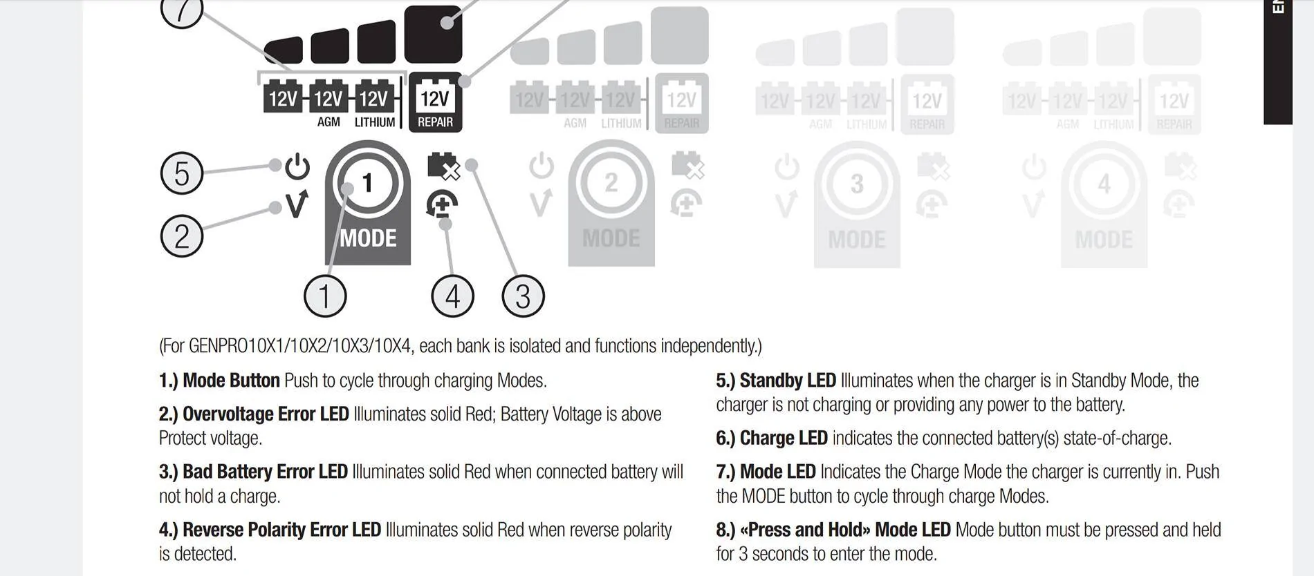

Better yet, looking at the user manual, is icon 5 the one thats.lit up when repair.mode completes?
Yes, 5 comes on with a dull yellowish color. I would have assumed it would automatically go into charge/maintain mode.
Just for kicks, run the charger on normal mode and see what it does. Perhaps it is to indicate it is complete?
If I run it on normal mode, it cycles through the charge status LED's (I think 6 in your pic) and the last, biggest LED stays lit green, along with the white 12V mode LED.
Interesting ?. Assuming you can't get the answer soon, I would recommend reaching out to NOCO about this. I suspect normal operation, but knowing normal operation can be tricky sometimes.
Agree, from everything I have seen, it looks normal. If I find out differently, I'll update the post. Right now I have to deal with installing a new dash cam.
