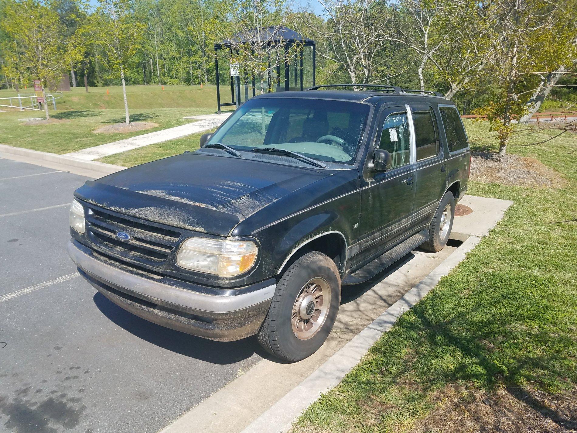

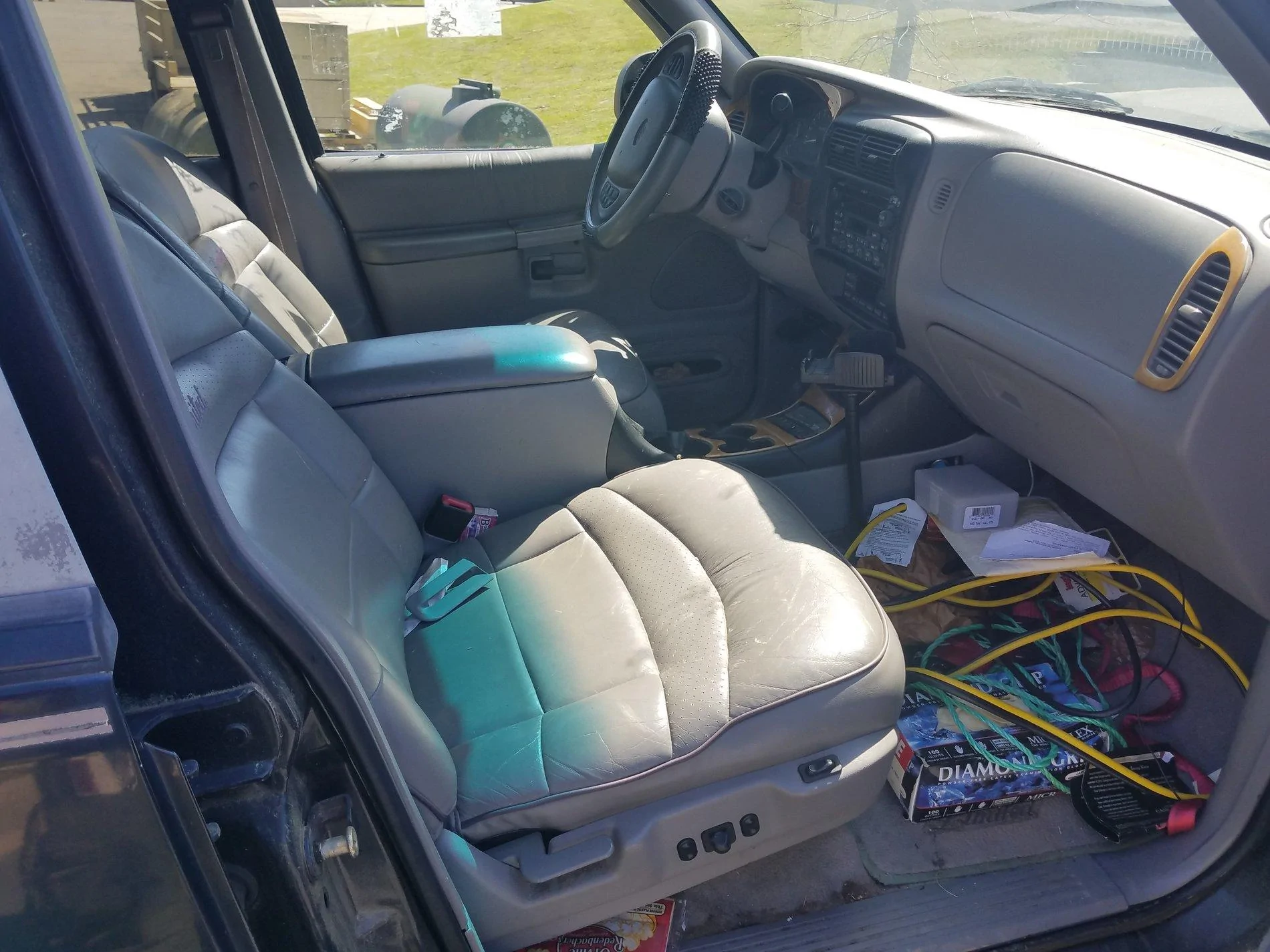

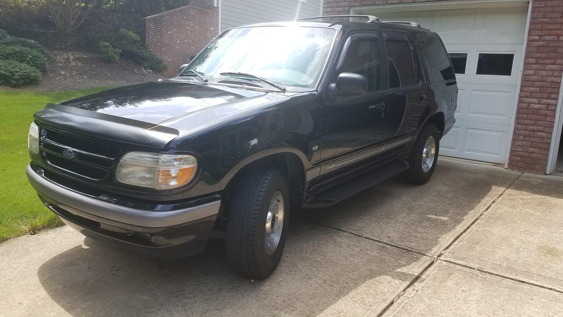

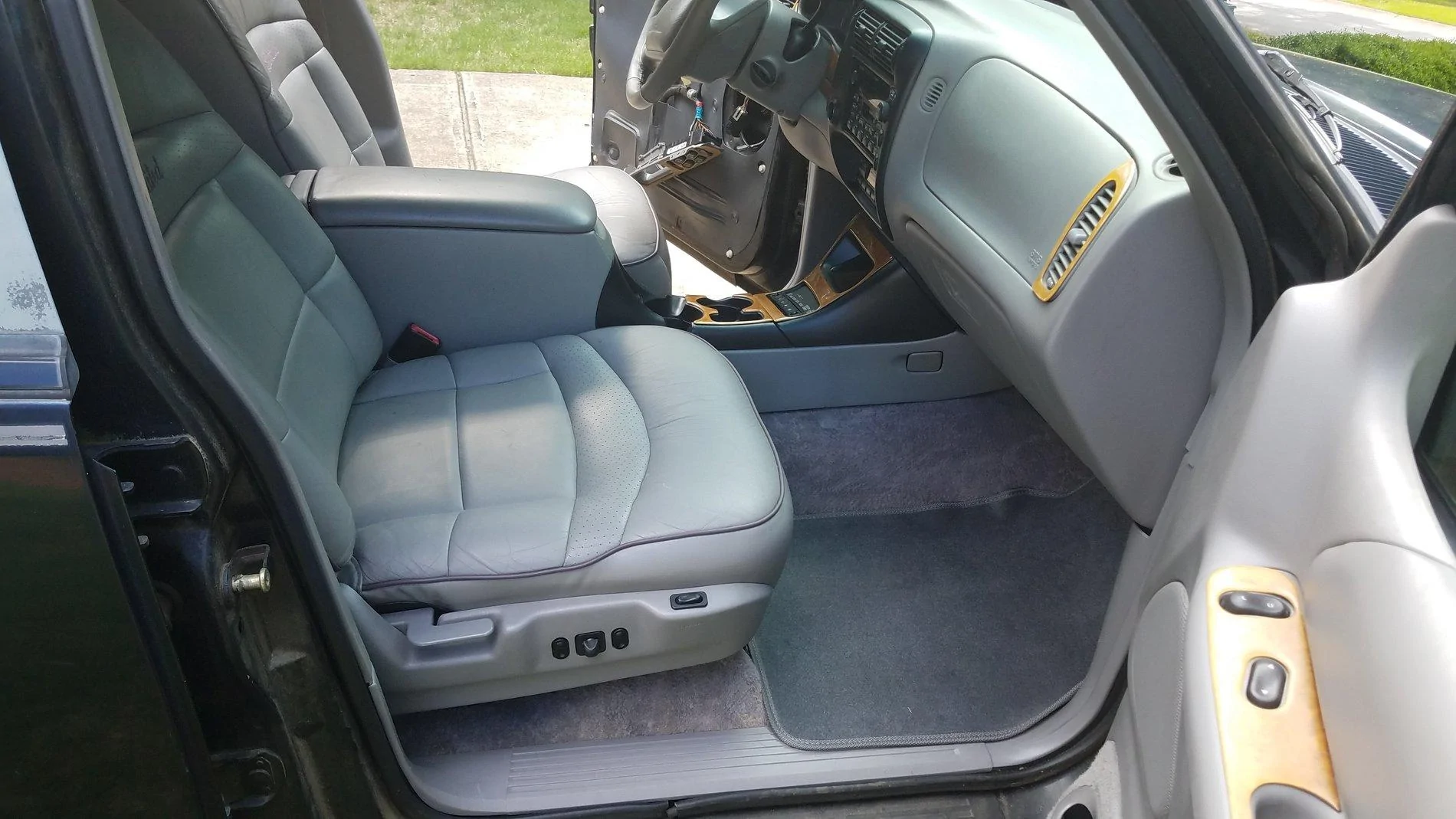

Wow! I thought I had the last one on the planet :) I had a '91 with a six and a four speed, drove it for 220K miles.... When you go to tow with your Ranger, you'll notice right off the bat, when you leave a stop, it just goes off the line. The combination of the 1st and 2nd gear (very low in the 10 speed tranny), the low end torque with the 2.3L, puts the torque curve right where you need it for towing. Even on the ramp, it just pulls the boat right out.
I bought this thing for $50 and fixed it up. It was fun but I was ready for an adult car that wasn't 22 years old and didn't rattle all of the time!
Before:
After:
And now!
