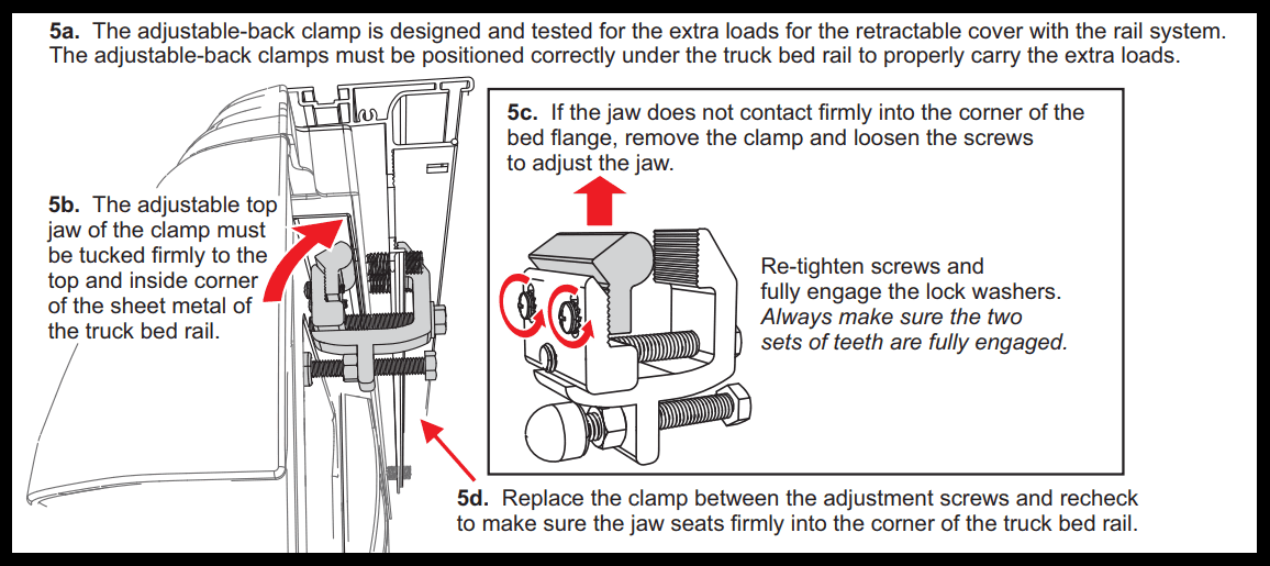

I installed mine this week. The part of the Retrax clamp that is closest to the edge of the truck bed is far too short to maintain a solid grip. As you tighten, the back jaw will eventually slip off. Even with the 1/8” shim they provide and clamping down the track from above/ below with other clamps @BHunted mentions to push the track further down ... I ended up using a makeshift shim that was the same thickness but but longer/wider and it allowed the clamp to get a solid purchase. I reported to Retrax that they need to redesign the clamp or allow for a different configuration to resolve this.

The nylon shims sit under the clamp between the metal bed rail flange and plastic bed rail cap. This helps prevent the nylon spacing/adjustment screws from deforming the bedrail edge and plastic cap.
Did you adjust the clamp jaws upwards so they tuck up tight under the bed rail ? IIRC I adjusted mine up 3 notches for a firm fit.
Right. I never got the top jaw to take, even after adjusting. I went ahead and said to hell with it and removed the adjustable top jaw so that my makeshift shim would work... but you’ve got me thinking I need to take another look. ?

+1 on adjusting the clamp jaw to sit higher. All of mine fell off after an aggressive bumpy ride. They are staying on now after moving them up (+3, maybe as much as they would move).
Just be careful to not overtighten the clamps when you put them back - this will pull the rails away from the rollers which may cause impingement, and may prevent the lock pin from slotting correctly when closing the latch.
Here's what mine look like after adjusting the jaw . . .

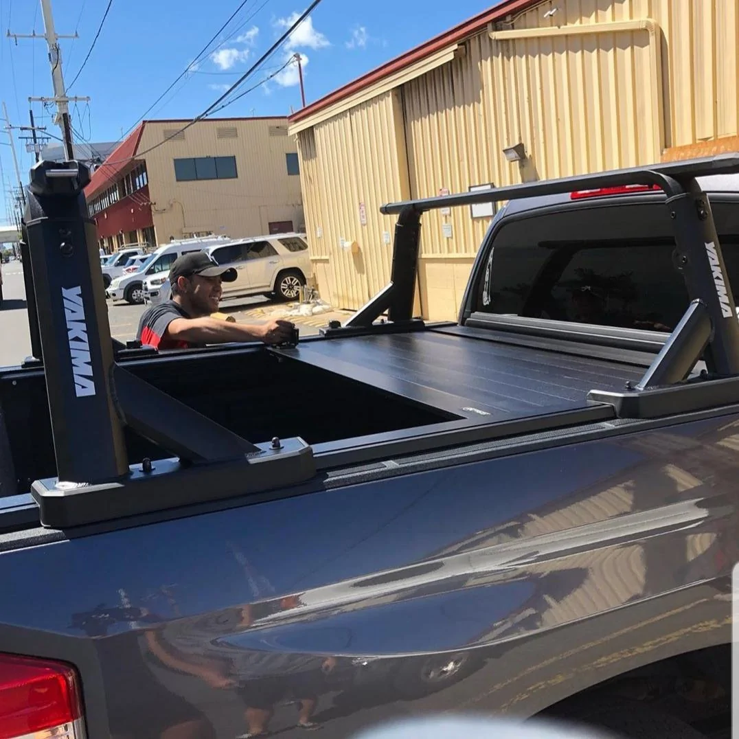

Anyone using the Retrax or Embark cover WITH the Yakima tonneau kit? If so, do you have issues with the bolts pulling up the T rails and deforming them? I've read reviews of this, and the possibility that Yakima has a redesign in the works.
I have the Embark version of this cover on order, and plan to use a Yakima rack with my RTT. However, I want to be able to remove the rack for ~1/2 the year. I don't want T rail damage showing when the rack is not on the truck. If damage is likely, I'll wait for a possible redesign from Yakima, or look at other options (maybe cancel the Embark order). Thanks.
EDIT: Yakima rep confirms the redesign has been complete for the Tonneau kit, but it won't be available for >= 90 days.
When you use the T Slot system it reduces the rolling and static weight. I think the Yakima is rated at 200lbs rolling. Where others that mount differently like the XTR 1 system is 350lbs and 1200lbs.
This should be considered if you are going off road. Some RTT can be as heavy as 200lbs.
Although The Yakima does have the convivence of coming off quickly.
EJH
Ed
Oct 7, 2020
794
1,484
Subarus, 2021 Ranger
This should be considered if you are going off road. RTT are around 200lbs.
No issue for me. The weight is reduced from 500/300 lbs on/off road to 300/180 lbs on/off with the toneau kit. My RTT is 115 lbs so no worries for me off roading with it. When parked (inside the tent), the 300 lbs rating would be in effect, which is more than adaquate for a couple and dog (remember 1/2 the weight is on the ladder)

Dont quote me on this but I think the pro is the only one compatible for a rack?? My choice if I go this route
Both the One and the Pro XR are compatible with racks. The difference is the One uses a plastic for the cover and holds 250lbs directly on it, the Pro uses aluminum and holds 500lbs directly on it. Both versions support the same on the rails.
