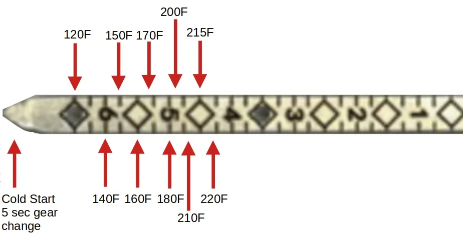

Like others have stated, it is very easy to overfill and the truck will run fine until you reach the higher temperature range and the fluid expands enough to begin foaming, then all H@ll breaks loose.
If you haven't yet, invest and install a Fitzstick. His custom funnel is a perfect "hands free" fit with his dipstick. And the addition of this $14 electric transfer pump from Amazon makes life very simple, pulling fluid out the dipstick without spilling a drop!
You can't trust a seat of the pants warm up, you'll never get the transmission in the 206F-215F window without power braking the truck.
If you have a Fitzstick, you can use a cold start level measure that I came up with after I set the fluid to the middle of the range on the dipstick when I was at the top of the heat range (215F). It is really simple to do.
Use the image below. Each reading is the proper fluid level at a given fluid temperature. If you have a way of measuring the fluid this becomes very simple.
If you do not you can use a cold start (letting your truck sit on level ground over night in a warm garage.
I took the measurements at 75F ambient and 77.4 Fluid temp.
Basically start the truck from a cold start on level ground, shift through the gears from park to sport and back at 5 second intervals, immediately hop out and check the fluid level (DO NOT WAIT). Fluid level should just be touching the tip of the dipstick.
Filling to this level will result in the fluid reading at the diamond between 4 and 5 at 215F.
If you have Forscan and the FitzStick, you can validate when the fluid hits 120F, it should be at the center of the 1st diamond. If it is not on the level, add or suck out fluid and validate at the next higher temperature milestone.
I've successfully used this method on my last three transmission fills.
It is far easier than doing this under the truck when hot.

Thanks, I have the Fitzstick installed and I will follow this. I did have the truck running for 15 minutes in park before I tested it but did not shift between gears. I have a lot of good info in this thread to check it properly tomorrow.

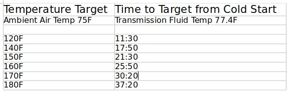

15 minutes from a cold start would have put your fluid temperature at less than 140F. If you filled to between 4 and 5 your transmission was way overfilled.
It wont exhibit any strangeness until the fluid heats up, then all manner of craziness occurs.
A good fluid fill at that temp (~130F) should have been between the top of the first diamond and just below 6.
I clocked the time req'd to reach the temps on the dipstick from a cold start. It took 38:20 for my transmission to reach 180F. A proper fill at 180F is at 5. (as measured on my truck).
See the charts below.
