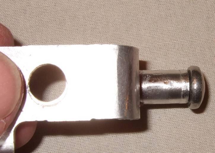

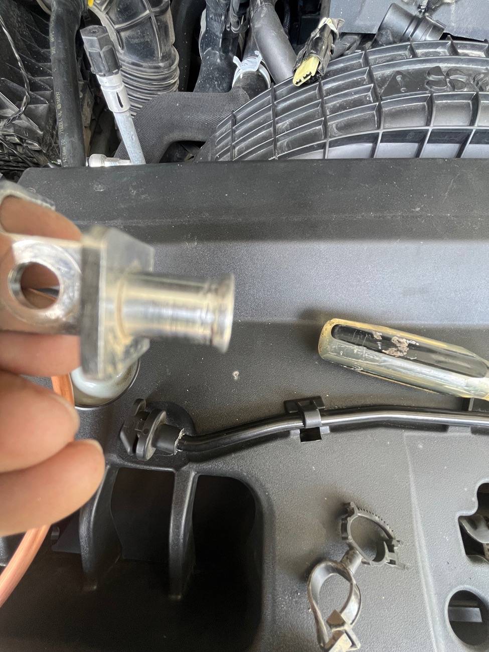

You also have this option from @TJC
Grind the end off of the support and (Tap & Install) a button head screw to get rid of the sharp edges on it - that appear to play a partial role in the hose splitting this puts a rounded edge on the end of the support.
Ref:
It has happened to me! (Dreaded Fan Sensor - Crumbling Hose!) | Page 11 | 2019+ Ford Ranger and Raptor Forum (5th Generation) - Ranger5G.com
I took my dremel and chamfered the sharp edges of the nub.

I used a silicone hose with a 90- degree bend and inserted a 1/4" section of soft copper tubing into the center section of the hose, leaving both ends flexible. I then formed the hose to the same shape as the original by bending the copper tubing infused hose.
This copper tubing gives the hose strength across the bridge while still allowing the hose to flex when under load as the clutch cycles on and off.
It was more expensive to do, but I am more comfortable with this option over fuel line. My goal was to put the least amount of pressure on the sensor to keep wear to a minimum.
My solution may be overkill. Time will tell. But I am comfortable with it, and that is what counts. Peace of mind has intrinsic value.
