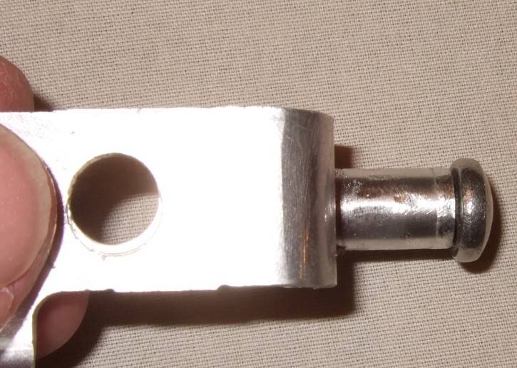

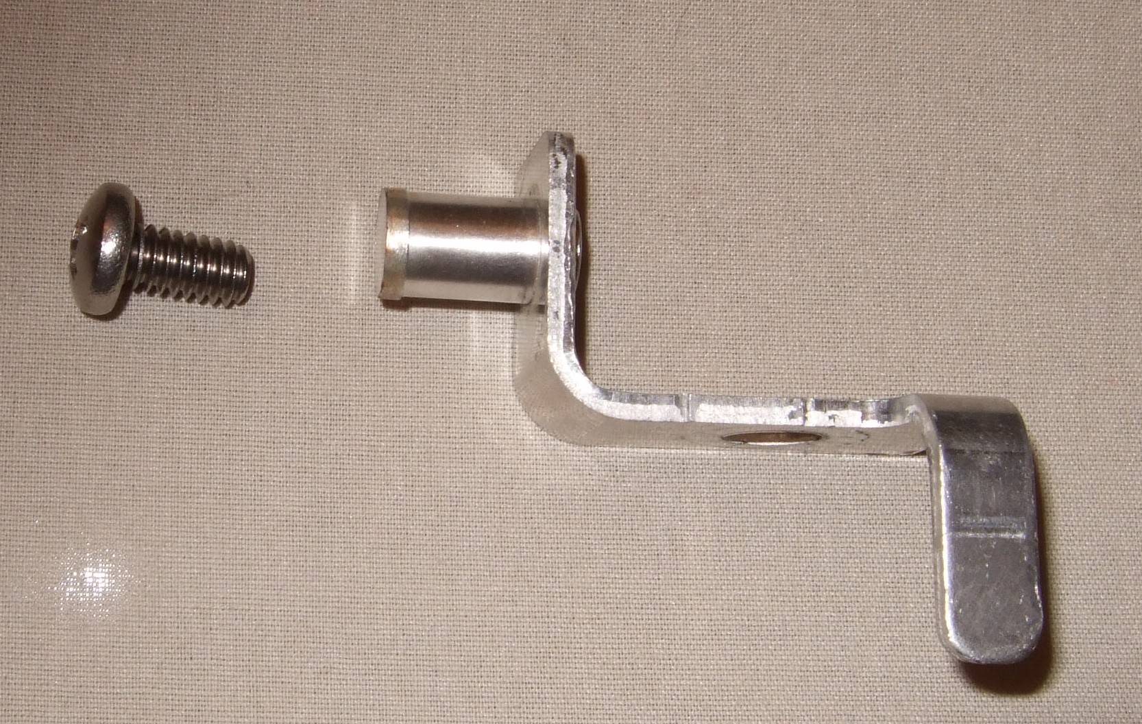

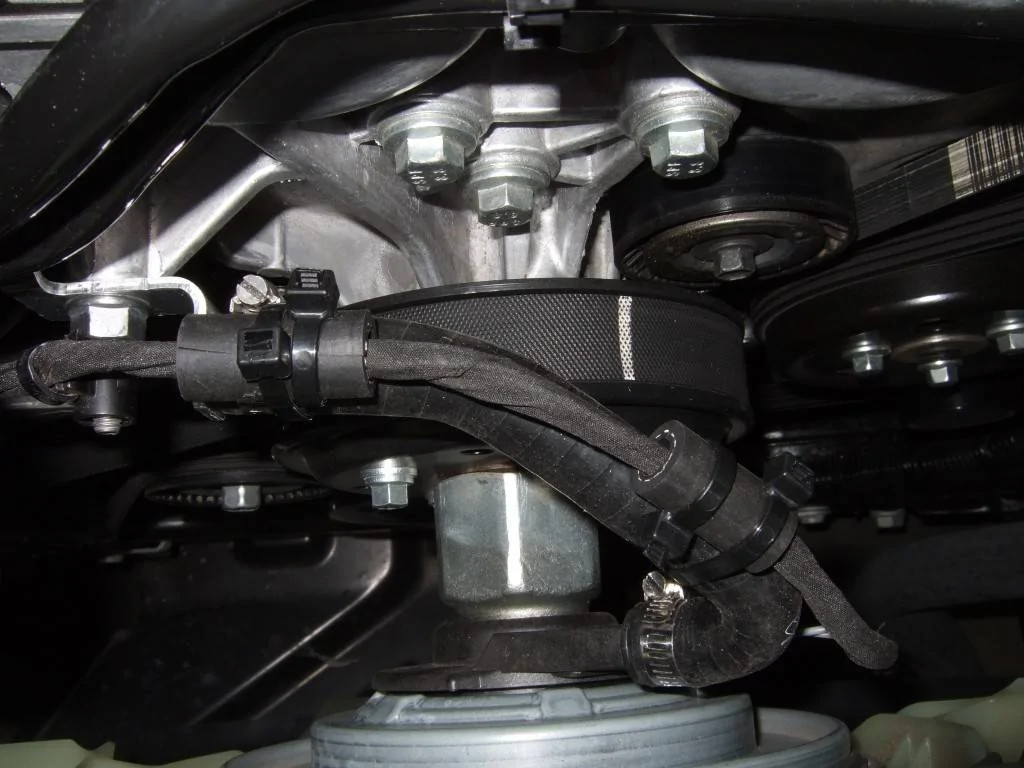

I woke up this morning with what I think is an inexpensive and elegant solution to fan clutch hose issue that I believe corrects the problem. It is quick and easy to do if you have a tap and die set.
I removed my old first pass attempt and the engine stud bracket. I then ground down the lip on the original stud, filed it smooth with the stud surface and then polished the edge with a cloth wheel.
I then drilled out the stud and tapped it to 1/4" 20 threads 0.4" deep. I found a nice stainless steel button head bolt and screwed it into the stud. The stud is a solid piece so only drill as deep as you need to to secure the bolt. If you have a long bolt, the easiest way to cut it to size is to use a portable grinder, but before beginning, screw a nut to the top of the bolt and insert into a vice tightening on the nut. Be sure the bolt end is protruding right up against the nut. Then make the cut. Removing the nut will clean the threads.
Here is the bolt used and the stud bracket removed. The bolt head is the same diameter as the original lip, but has a very nice smooth polished radius to it, perfect for a hose dual flare replacement.
Here is the bolt installed into the stud.
And here it the completed project. I wanted to protect the cable from the hose clamp edges so I used 1" section of fuel line hose to route the cable much like the original cable standoffs. I still have a bulge in my silicone cable where the head of the screw is, but I am confident that the stress to the hose has been minimized. Hint: The stud bolt on my truck had never been removed and it was only snug. When I reinstalled it, I was careful not to over tighten the bolt. it is going into aluminum threads.
If the retainer lip on the stud is part of the problem, (as well as the cheap hose), and I think it is, then the problem can be put to bed. I guess In a few years I will know if this has worked.
I then drilled out the stud and tapped it to 1/4" 20 threads .4" deep. I found a nice stainless steel head button bolt and screwed it into the stud. The stud is a solid piece so only drill as deep as you need to to secure the bolt. If you have a long bolt, the easiest way to cut it to size is to use a portable grinder, but before beginning, screw a nut to the top of the bolt and insert into a vice tightening on the nut. Be sure the bolt end is protruding right up against the nut. Then make the cut. Removing the nut will clean the threads.
Here is the bolt used and the stud bracket removed. The bolt head is the same diameter as the original lip, but has a very nice smooth radius to it, perfect for a hose dual flare replacement.
And here it the completed project. I wanted to protect the cable from the hose clamp edges so I used 1" section of fuel line hose to route the cable much like the original cable standoffs. I still have a bulge in my silicone cable where the head of the screw is, but I am confident that the stress to the hose has been minimized. HInt: The stud bolt on my truck had never been removed and it was only snug. When I reinstalled it, I was careful not to over tighten the bolt. it is going into aluminum threads.
- T
I was thinking of something similar but I was thinking of having a through bolt with the nut on the other side with flat washer to spread the load. I do like the addition of the fuel hose to route the harness through. I'm going to do that too! Oh, and good to know that's a stud bolt and not just a nut you can pull off. Interesting that they do that as I'm not sure what the stud is for especially since it has to have that rubber piece on it, seemingly to protect it or protect something from it?

The stud holds the wire loom in place. You need it. Don't cut the plastic cable retainer (rubber piece). I used a pair of curved needle nose pliers to assist in removing it from the stud. It slides back on easier than it comes off.
If you look closely at the image below, on the left edge center you can see the cable and the plastic retainer on the stud.
Ah thanks. Yea I never looked that carefully at that as I was to going to remove it. Makes total sense why it's a stud bolt now.
