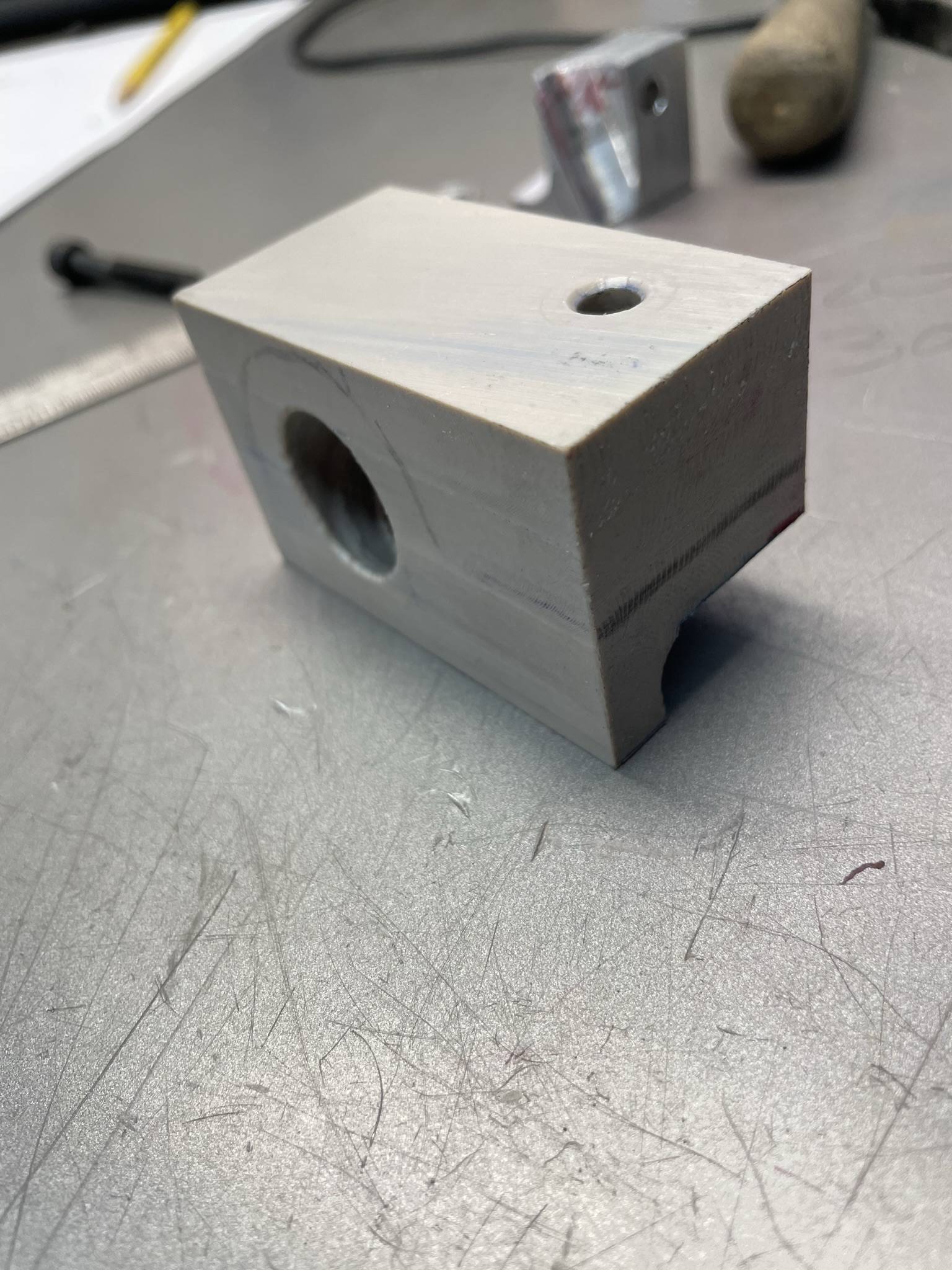

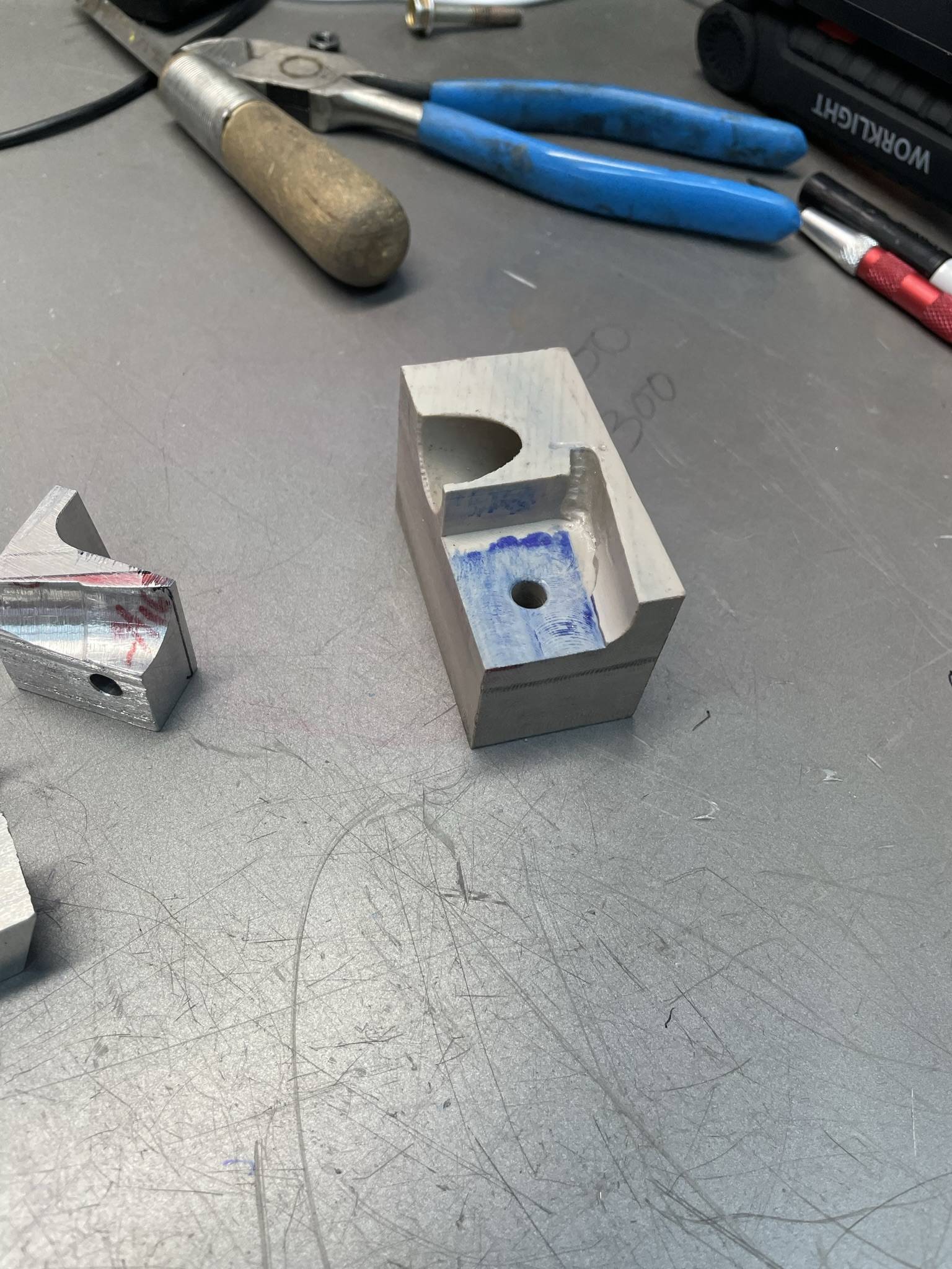

Still working on the bracket, taking a bit longer than I hoped, my ribs are so sore from laying on the core support and my hands are nice and scratched up from the cowl clips, I'm on the 3rd version, I realized in order to clear everything it has to be just below the engine bracket level, and angled outward, I think I have it sorted now, the shavings pile around the mill is pretty funny, I made the 1st two, they were close, but they got band sawed in half and became templates for the next version.
I sure wish someone had a model of this engine/trans/firewall so it could just be whipped up on a computer screen, despite previous posts CAD is only a option when you have the correct models, otherwise you have to manually make the first one, then scan it in to use CAD, then the tool paths have to be written for the CNC machine.
I should have gone with the P clamp, it fit pretty darn well, but I cant stand the thought of a nice aftermarket dipstick with a 25 cent clamp.

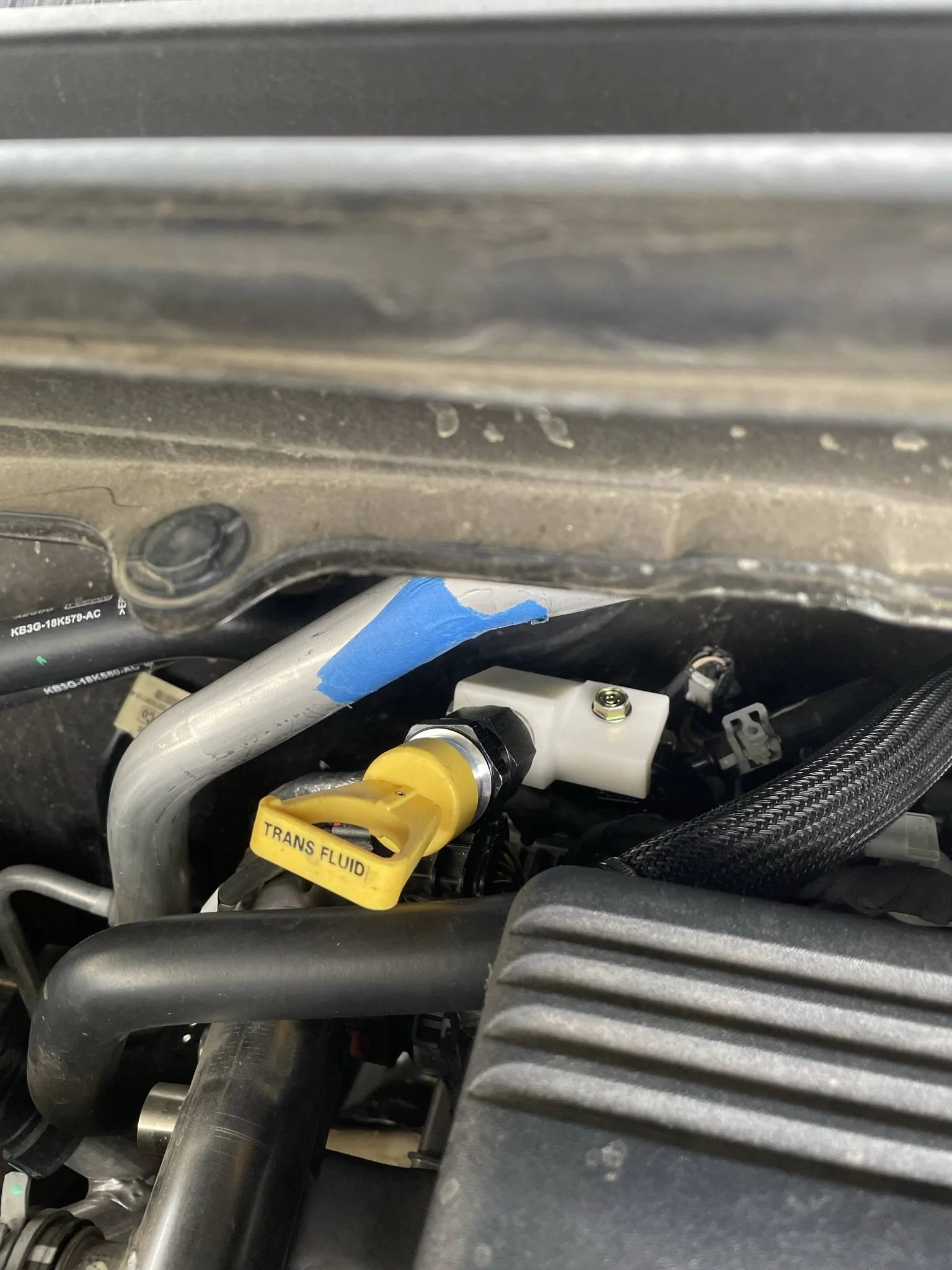

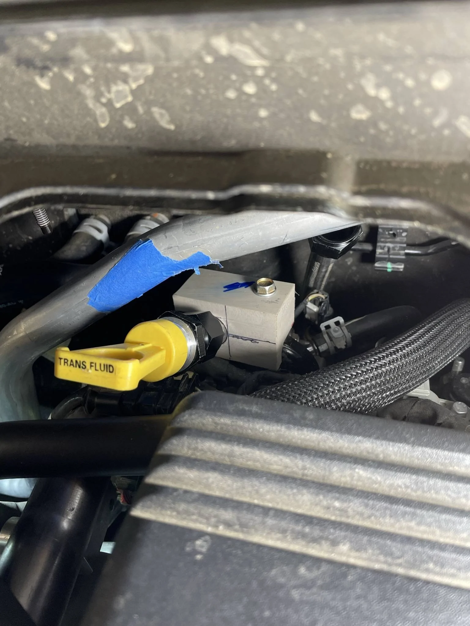

I think I got it, now it's off to get it scanned, shaped, radiused in a modeling program and turned into a file, then it's out for quoting to write the tool path and machining, it looks like nothing now, just a big block, but after two almost good aluminum brackets I switched to PEEK material for ease of machining, the only details that matter are where the holes are, the angles, heights and diameters.
The difference of just a couple degrees of angle was the difference between a scrap bracket and a good one, you can see one of the fails off to the side, hopefully it all goes smoothly.
It actually looks kinda crappy when I look at the pics up close, the angles were a challenge, very difficult to mark the mock up bracket under the cowl, good thing it can be contoured virtually and made to look like a proper slender shaped bracket.

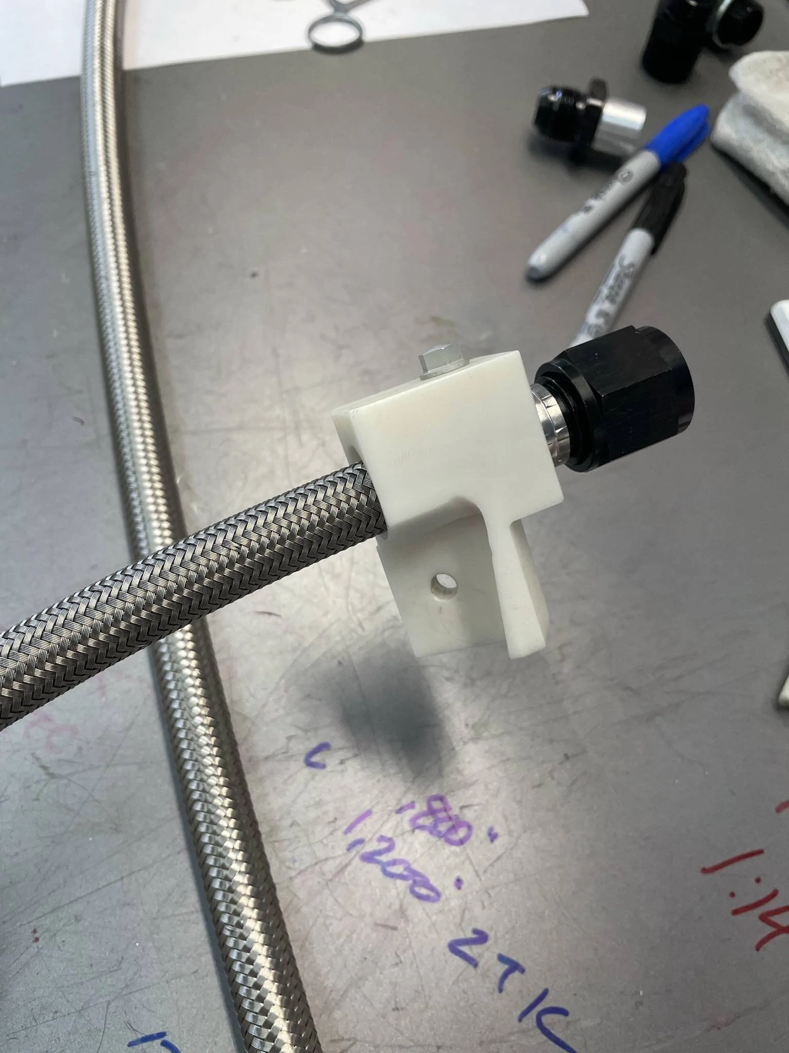

Update:
I have the bracket in the final form, I also got a preliminary drawing.
I now know why the B&M stick has to be marked by the end user, the hose mfg has a +- tolerance of .250" so that means there can be up to .500" acceptable difference in length from one hose to the next.
I found this true when he made a second one for me with the bracket on it, it's short .200"
I also found the dipsticks can vary .125"
So the only way to make a pre-marked stick is to hand make each one, match the hoses with the sticks and machine the end fitting to final length.
I will see as it goes along if I car realistically make a pre-marked stick.
