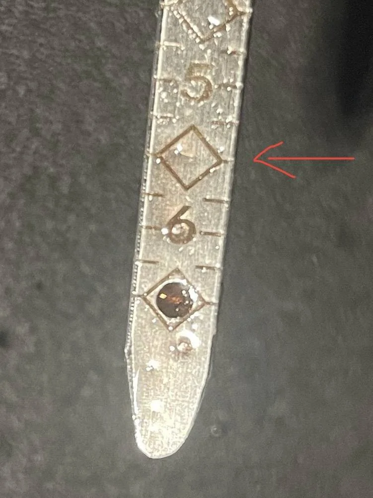

Alright, got a solid read after a 2 hour drive. It was down at the 5.5!! Poured in about 14 oz so far. That seemed to have brought it up to 4.5. But, the fluid I put in was cold and it was dark and pouring rain. It was hard to get a good read with the fluid in the hose.
The ease of maintenance on this transmission is gonna be next level. Thanks for your masterful construction Mike. I can’t wait to get the new pan on now.
I had several hours behind the wheel this weekend.
I am constantly driving in sport mode because I get a weird hesitation in some gears - mostly uphill - unless I lean into the skinny pedal. Sport mode seems to alleviate that.
I had one moment - actually in sport mode - that seemed like it wouldn’t upshift getting off an exit. I put it in drive and back into sport and it didn’t do it again.
