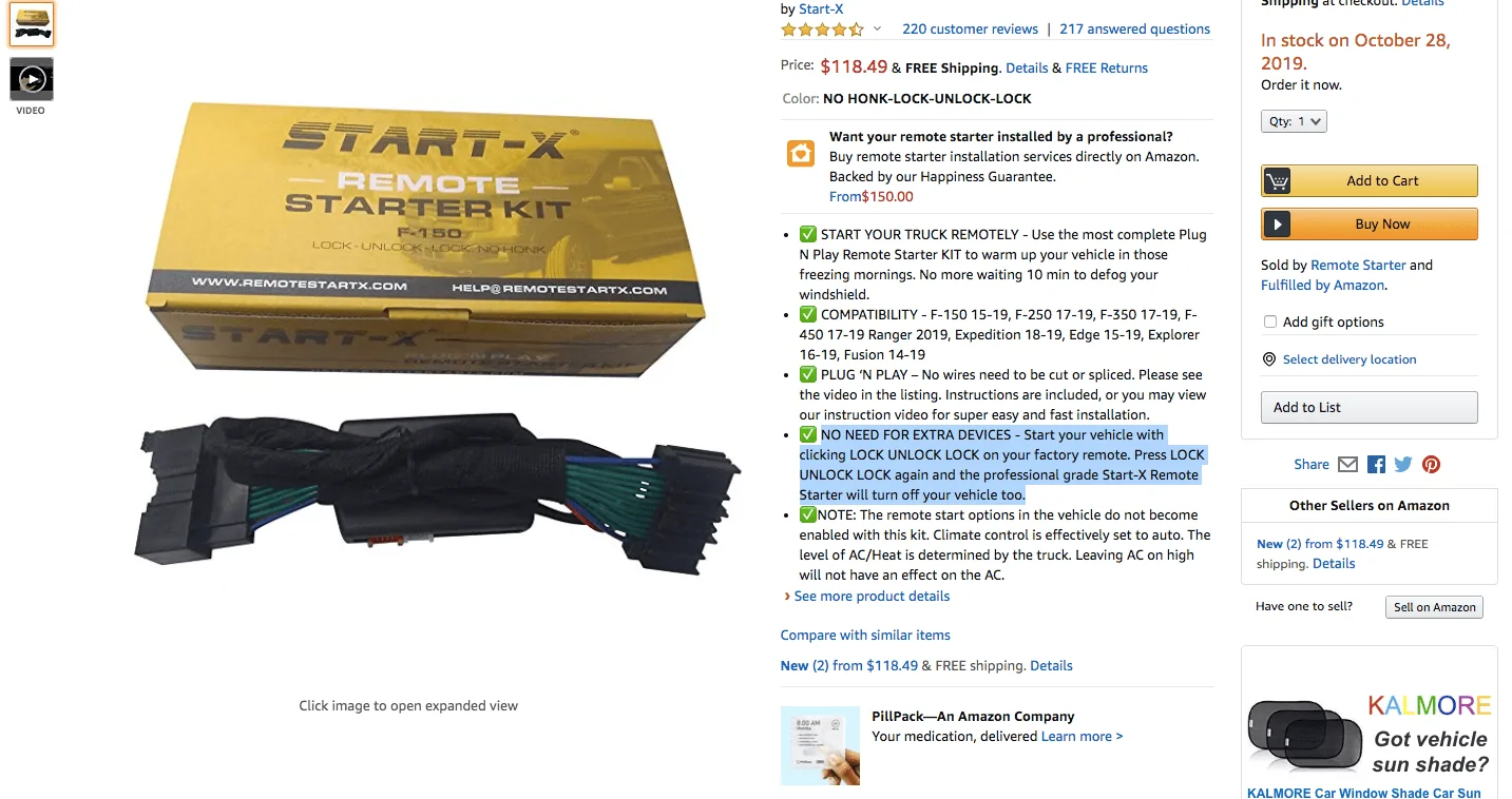

Will the start x kit work on the Australian 3.2 diesel 2019 push button start ranger
I wonder if it would work, We can enable everything in forscan. In fact, I already have the remote start settings and stuff on my display. We just need the device to communicate with the unit. Im tempted but $118 plus shipping is a costly gamble.
280
21,289
101,276
Arizona
CEO of DeeZee
The good thing about Amazon is they will take it back if it doesn't work. I don't think they've ever denied anything I've ever tried to return. Just make sure there's no fine print saying anything specific about returning it.
