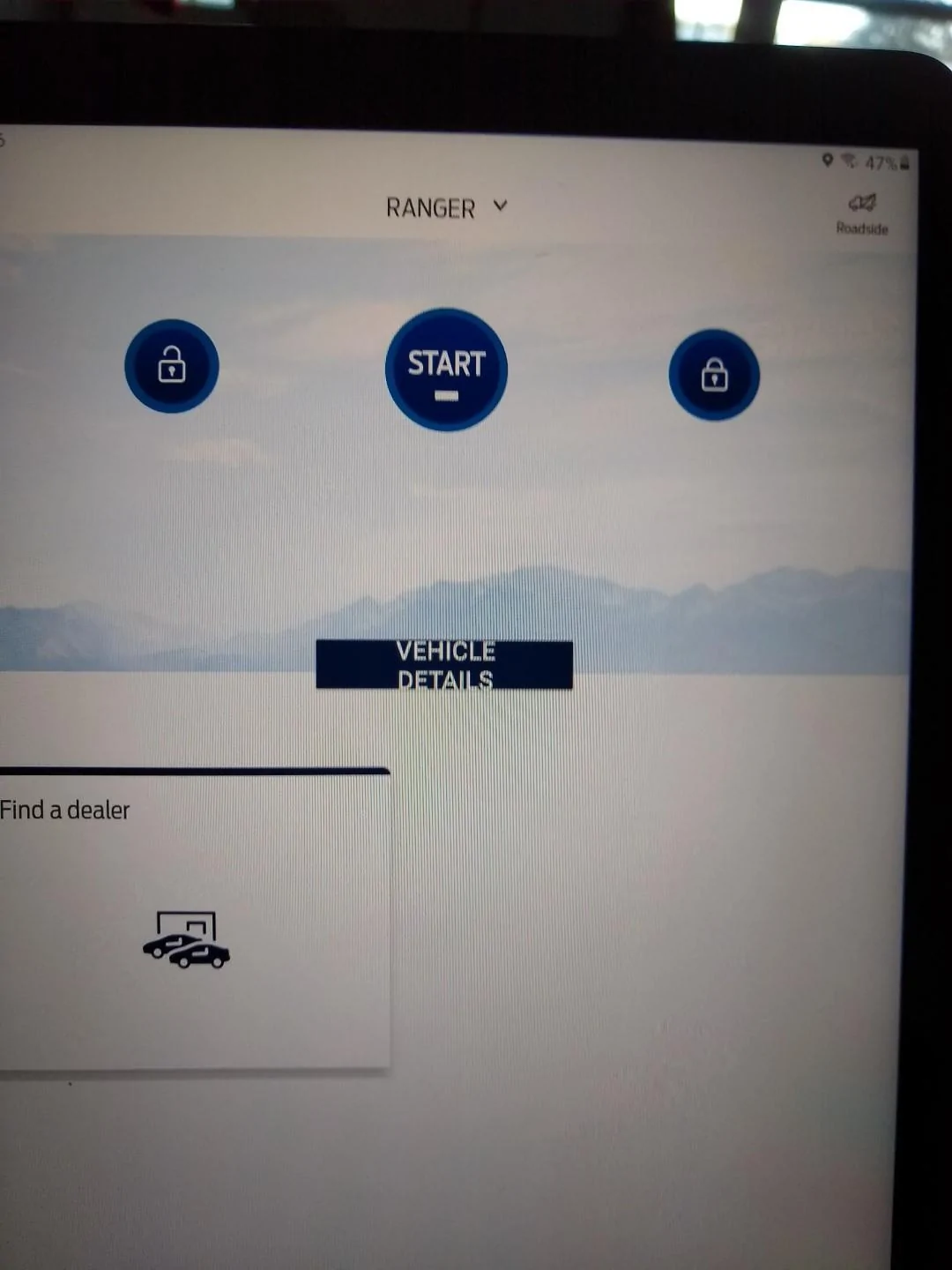

So my 2020 Ranger has remote start but only through the app, no button on the fob. Is it possible to purchase a new fob that has the remote start button, pair it, and have it work?

yeah you dont have the auto start.
im sure you need a different key fob, but im not sure if its that easy. might have to contact the dealer
Actually I do, but as I said in my OP I can currently only start it from the app, I want to start it with the fob as well.

I'm thinking I don't need that, it includes remote start, I already have remote start but I can only start from the app.

Not yet but I'm going to guess it won't work for that reason as it wasn't mentioned in the manual that I could find. Seems kind of silly that it wouldn't be on the fob to begin with, but I'm wondering, it is already receiving signals from the fob for lock/unlock/panic, would it recognize the remote start button from a fob that had it? I think I may end up having to but one and try it to find out. I'll be trying the mentioned method today.

Remote start is already enabled and working via the app from the factory, I want to program a fob that has the remote start button (mine doesn't), I know forscan can do the programming, I'm trying to find out if a fob with the start button will work.

Getting a factory remote start fob won't work for you.. The frequency for remote start fobs and vehicle receiver is 902 MHz, while your remote and receiver w/o remote start is 315 Mhz. People found out about this when ordering the Keyless entry pad. See post #55 https://www.ranger5g.com/forum/threads/ranger-keypad.1778/page-4
