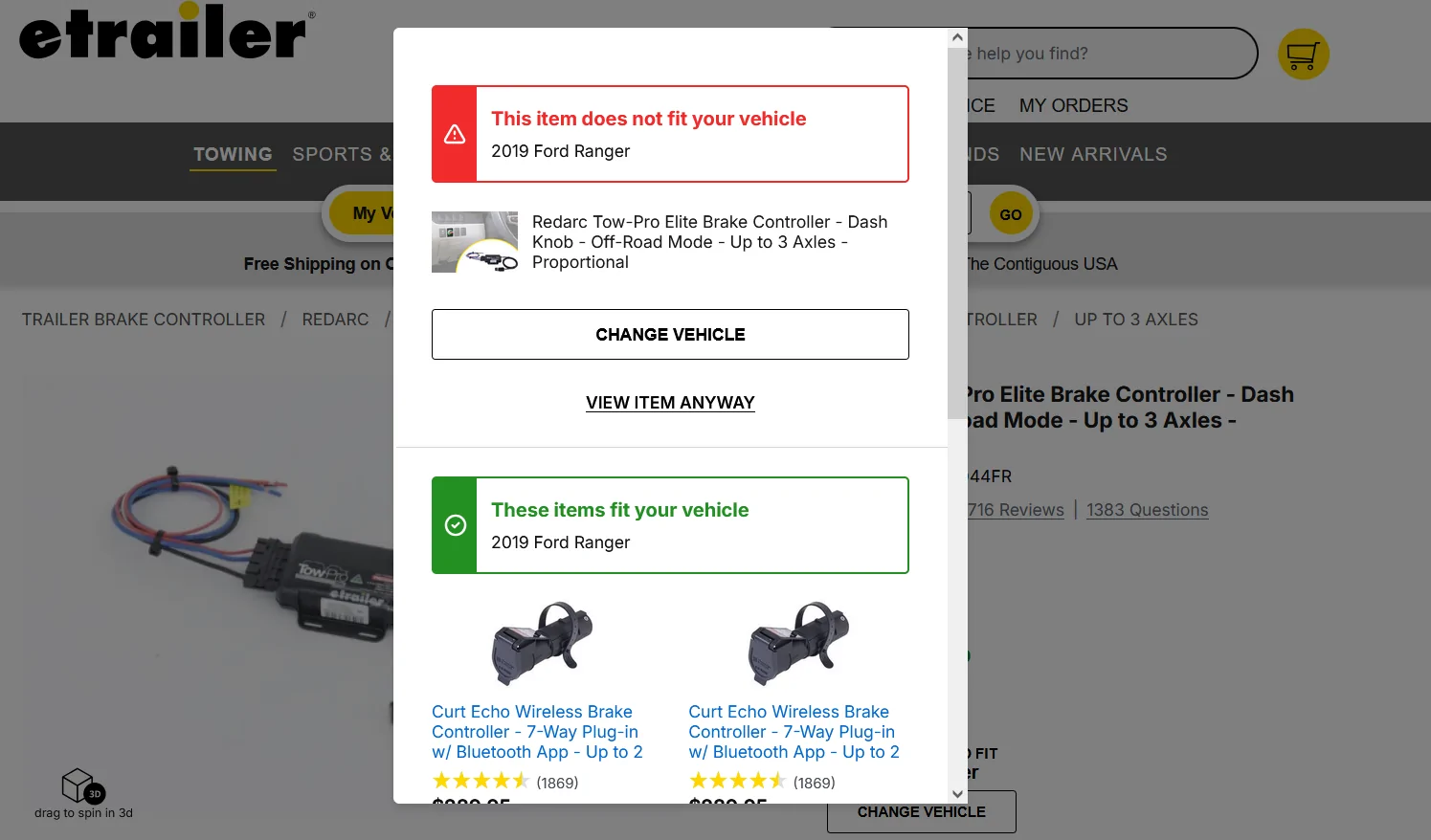

Please forgive me if this was asked earlier. Reading 19 pages...whew...that's too much right now. Just got back driving 1700 miles and this was it's first use for me. I wired as indicated here earlier and the whole time driving home it flashed green every second. What might be wrong?
ControlNode
1,739
3,766
Eastern NC
Computers
Out of the box I think that is right, when Ford had this controller as an option it also included the brake light interface module that allowed it to see if the truck was applying any emergency braking. Odds are they found the "liability" in claiming it will work if it doesn't work with emergency braking. All of the recommended plug-in ones are the easiest to work as they already have the brake light signal there.
