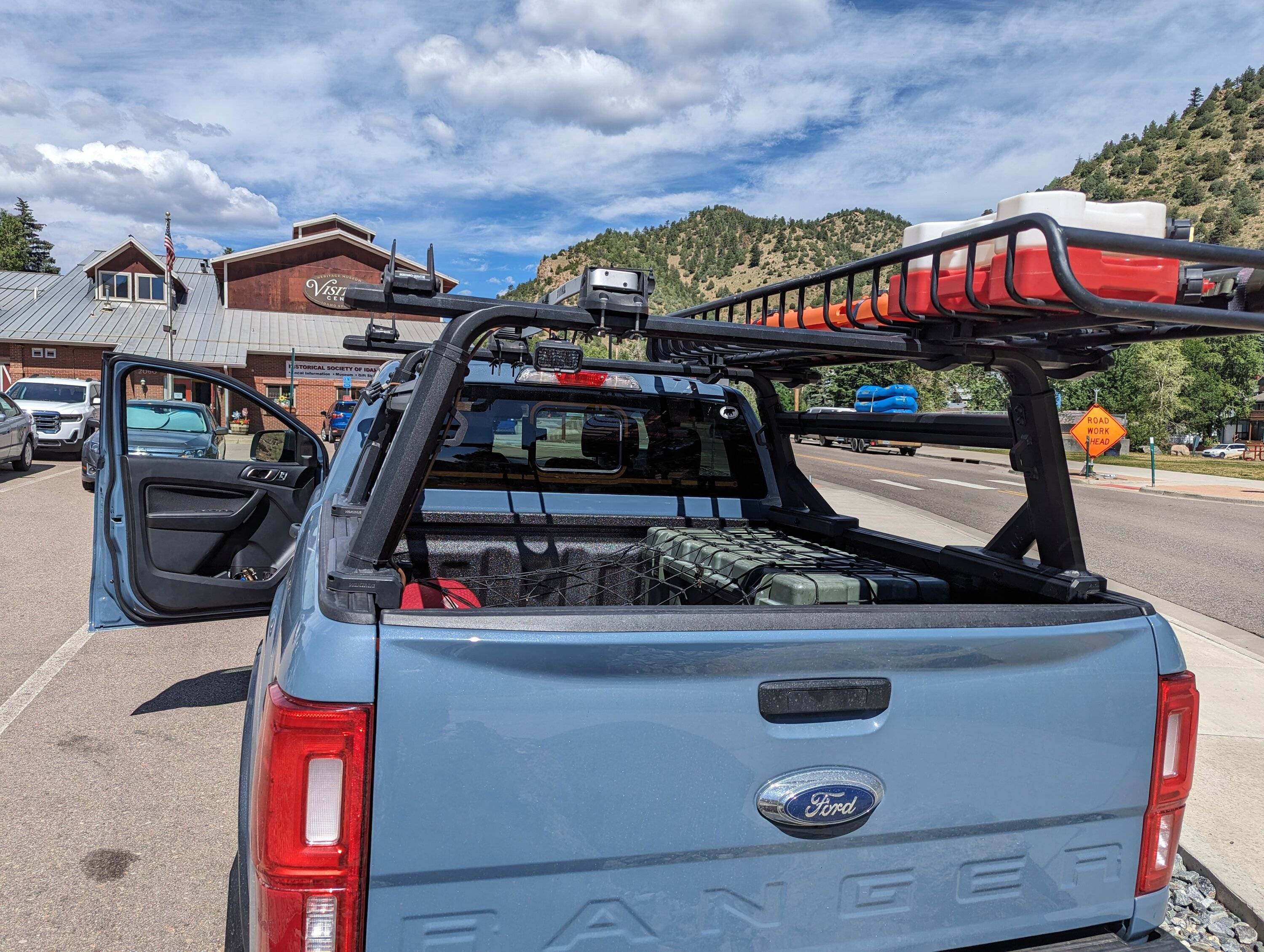

I mounted rear facing lights on the back of my yakima crossbars.
I bought a deutsch connector kit so I could make custom ends to the back of my lights and have a single run of outdoor multiconductor wire from the front box to the lights.
One switch for the rear facing lights one for the left flank lights, another for right flank and a 4th for back lighting all the lights....
I ran the wiring up the inside of the yakima upright, I bought self tappers and those cable holders so I can run it cleanly up the inside... Once we get a house and settled....

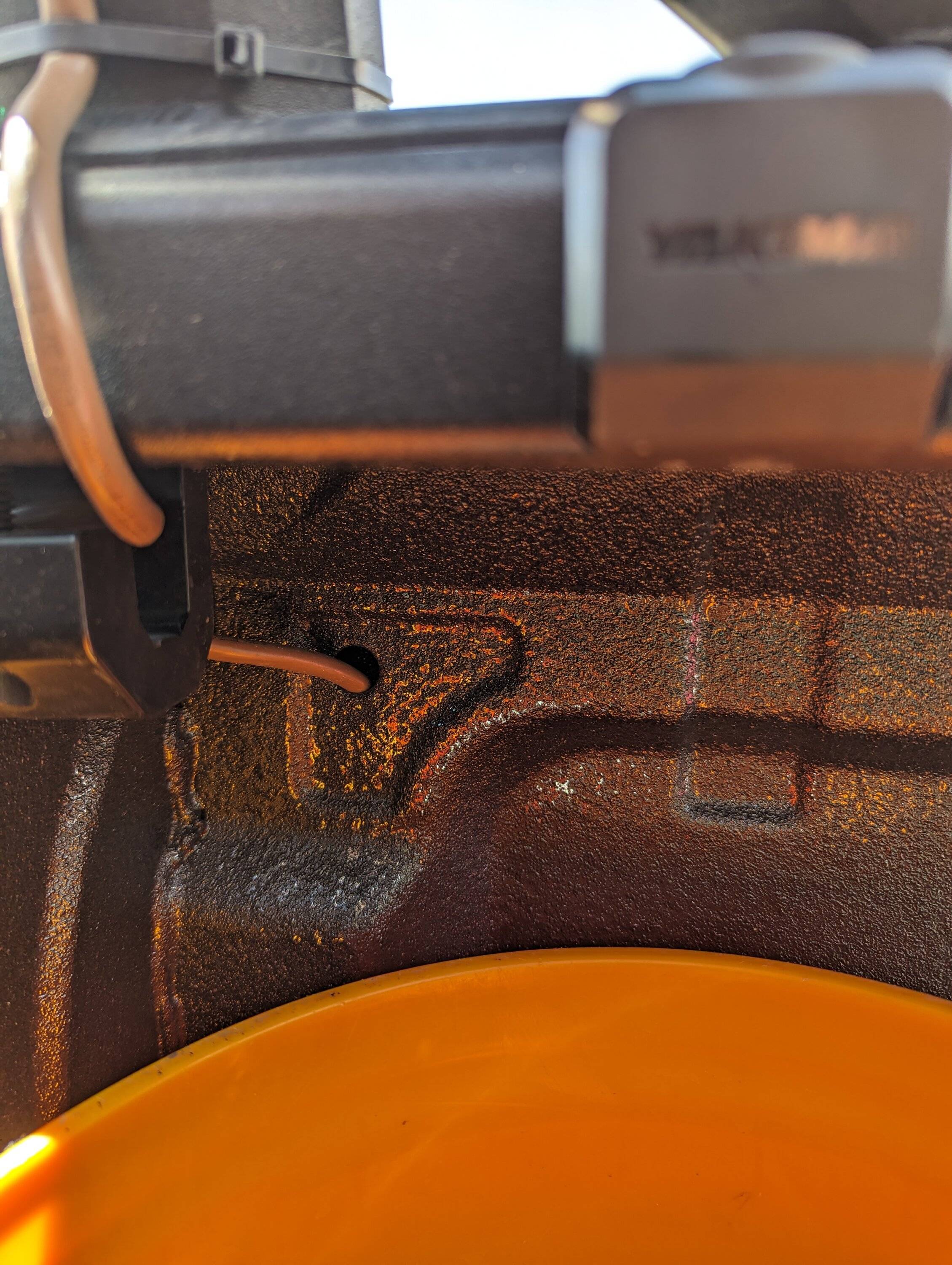

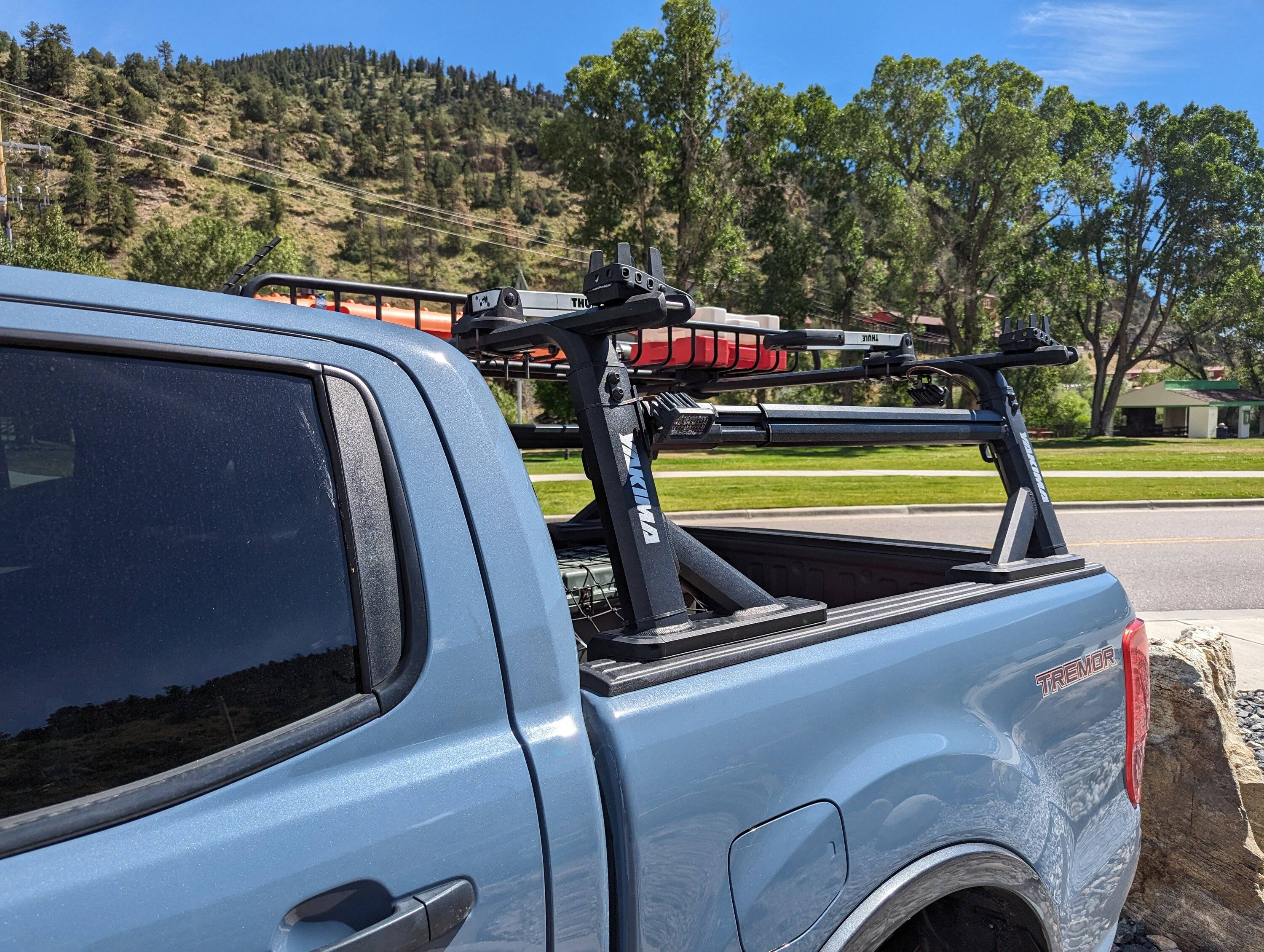

Here are a few quick pictures...
I got it half wired before we moved, so just the drivers side is connected.
I ran the wires down the uprights and through a hole under the bedrail, there is at least one at all 4 corners.
I contemplated having a splice behind each light so I don't have to run more wires from the engine bay, but didn't like the way it looked - not clean and I wasn't convinced I could waterproof it.
Maybe a solution would be to install a junction box to the top of the frame and pot it so the connections are encased in epoxy... Shrug, long term after I get a garage and a house... ?

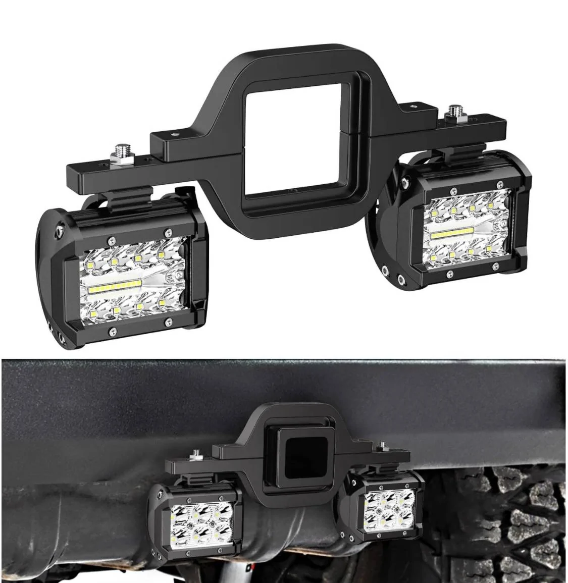

Looking for easy solutions to mount some LED cubes/bar that are rear facing on my Tremor. I want the option to have super bright reverse lights tied into my AUX switch if needed.
I’ve tried a hitch bracket for light cubes, but the one I purchased from Amazon didn’t fit the ranger hitch receiver. The one I purchased was made by Nilight (photo attached for reference ). After seeing that the Nilight bracket would not fit, I decided to wise up and use a caliber to measure the hitch to see if any list on Amazon would fit. No luck, unless I’m overlooking.
Does anyone know of a company that makes brackets for mounting cube lights or a light bar that is rear facing? It can be any sort of solution- hitch mounted, bumper mounted, etc.
