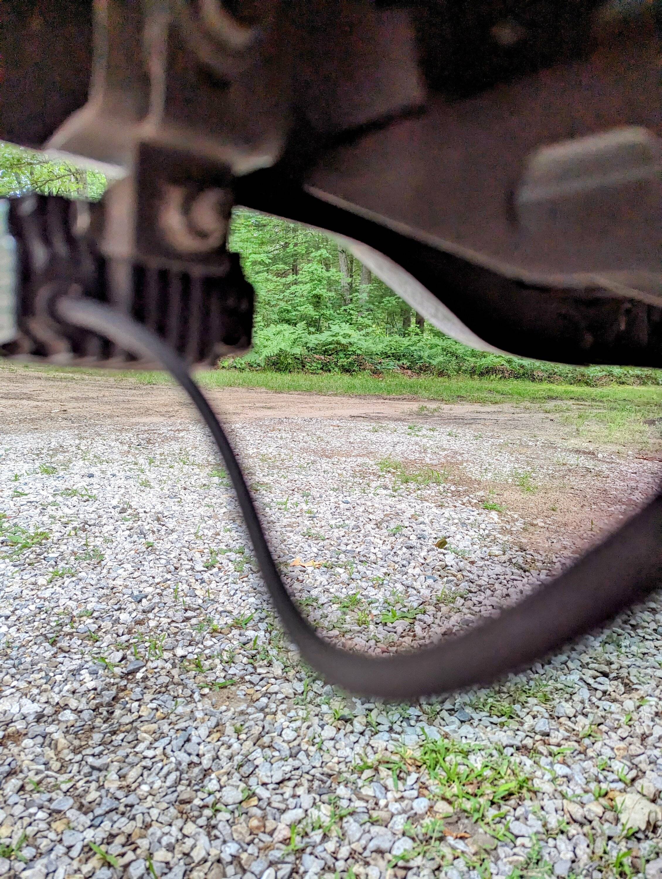

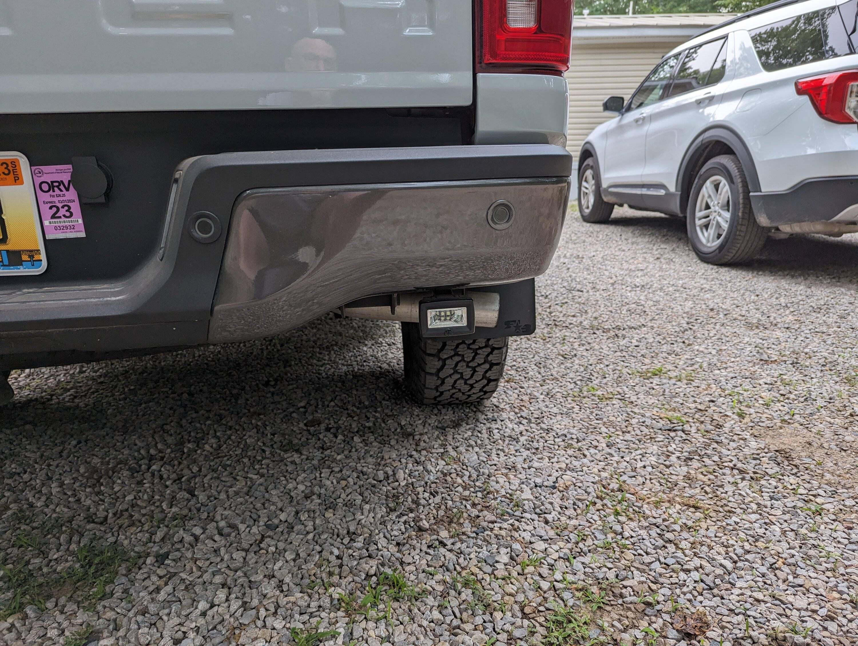

Looking for easy solutions to mount some LED cubes/bar that are rear facing on my Tremor. I want the option to have super bright reverse lights tied into my AUX switch if needed.
I’ve tried a hitch bracket for light cubes, but the one I purchased from Amazon didn’t fit the ranger hitch receiver. The one I purchased was made by Nilight (photo attached for reference ). After seeing that the Nilight bracket would not fit, I decided to wise up and use a caliber to measure the hitch to see if any list on Amazon would fit. No luck, unless I’m overlooking.
Does anyone know of a company that makes brackets for mounting cube lights or a light bar that is rear facing? It can be any sort of solution- hitch mounted, bumper mounted, etc.
