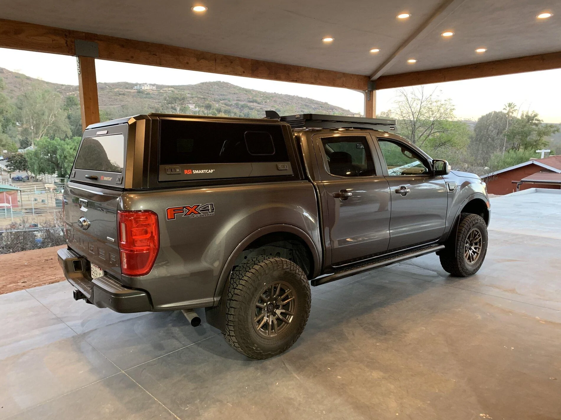

Thought I should update this because I found out the ARB OME extra leaf only works with their leaf springs, not the springs that came with the truck. I ended up going with the Auto Spring Kits add a leafs (I got the standard springs, but there’s an option for less lift)
https://autospringkits.com/product/2019-2021-ford-ranger-rear-add-a-leaf-kit/
No more saggy rear!
Also changed to Bilstein 5100 shocks to add an extra inch of travel. Will probably swap these to Icons to match the front when/if they ever become available. Have some rake back and ride is significantly improved.
