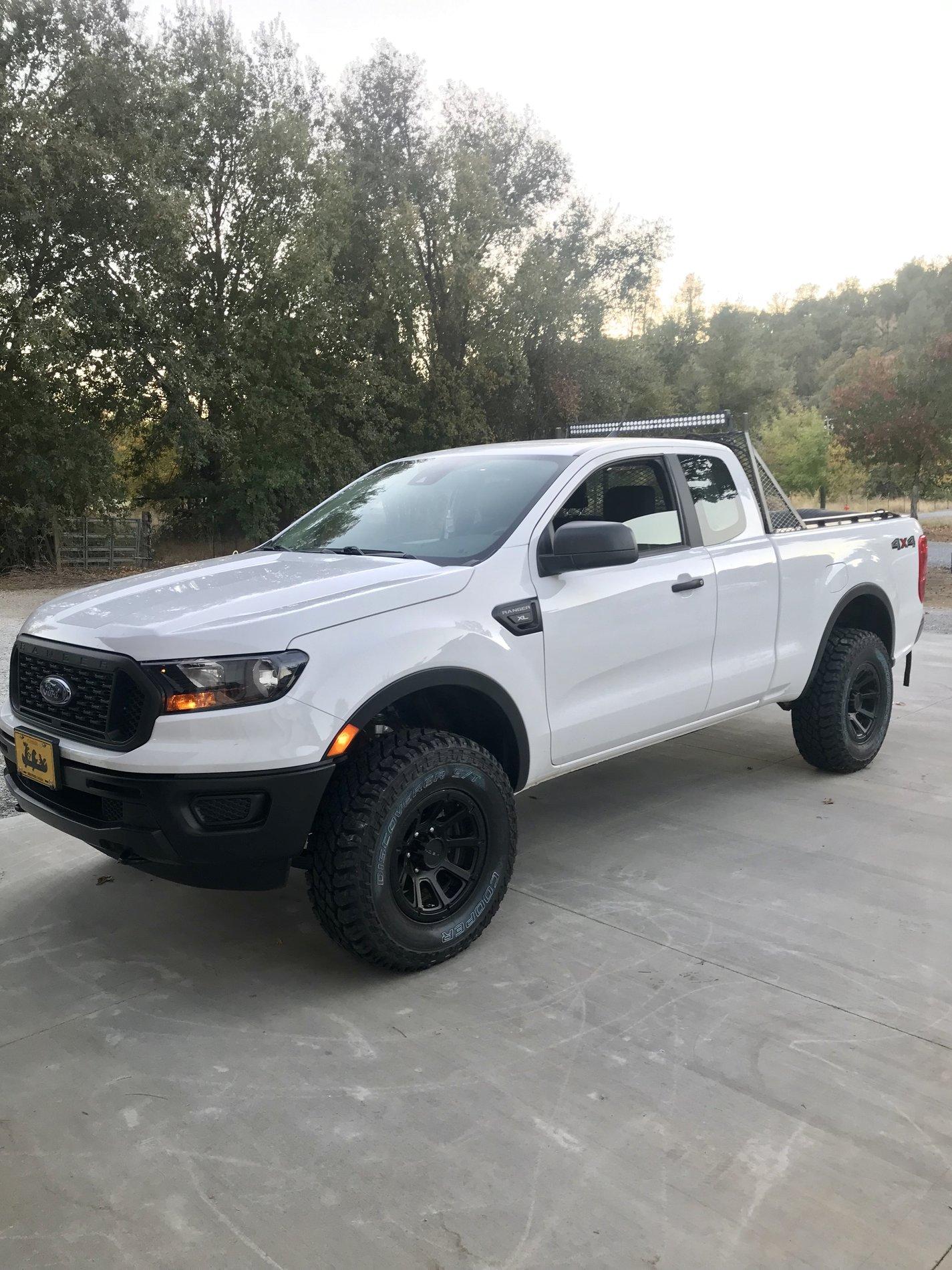

I wanted something similar and ended up with SVC Leveling collars, they ended up about 1 3/4”-2” higher in the front. It looks like the rake a stock truck would have.
That looks good. I just wonder if I'd prefer a better quality struts and rear shocks ( Eibachs?). I don't mind the stock rake as I tow and it levels out when loaded. What size tires?
MTB-BRUH
Tyler
May 16, 2019
27
667
1,390
Shingletown CA
2019 Ranger Base
Shop Manager
Ya maybe.. 265/75/16 32”
