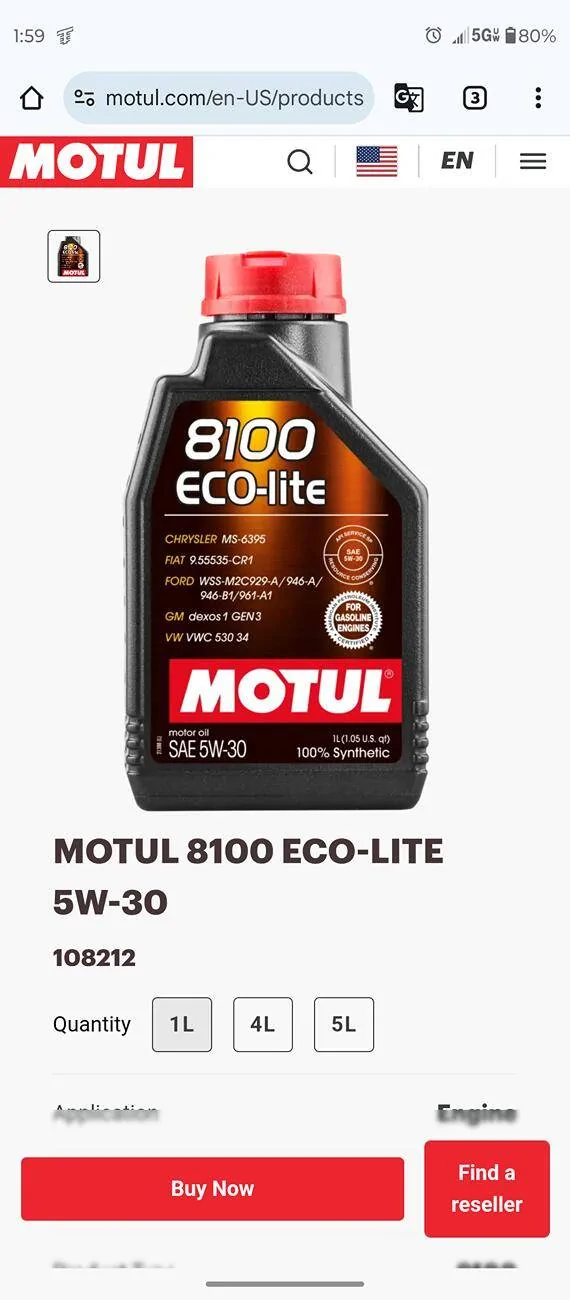

So for fun I decided to do a quick look. Looks like motul does have oil that meets that particular specification you mentioned along with a few others from Ford. Not saying you're going to switch but I did look.
