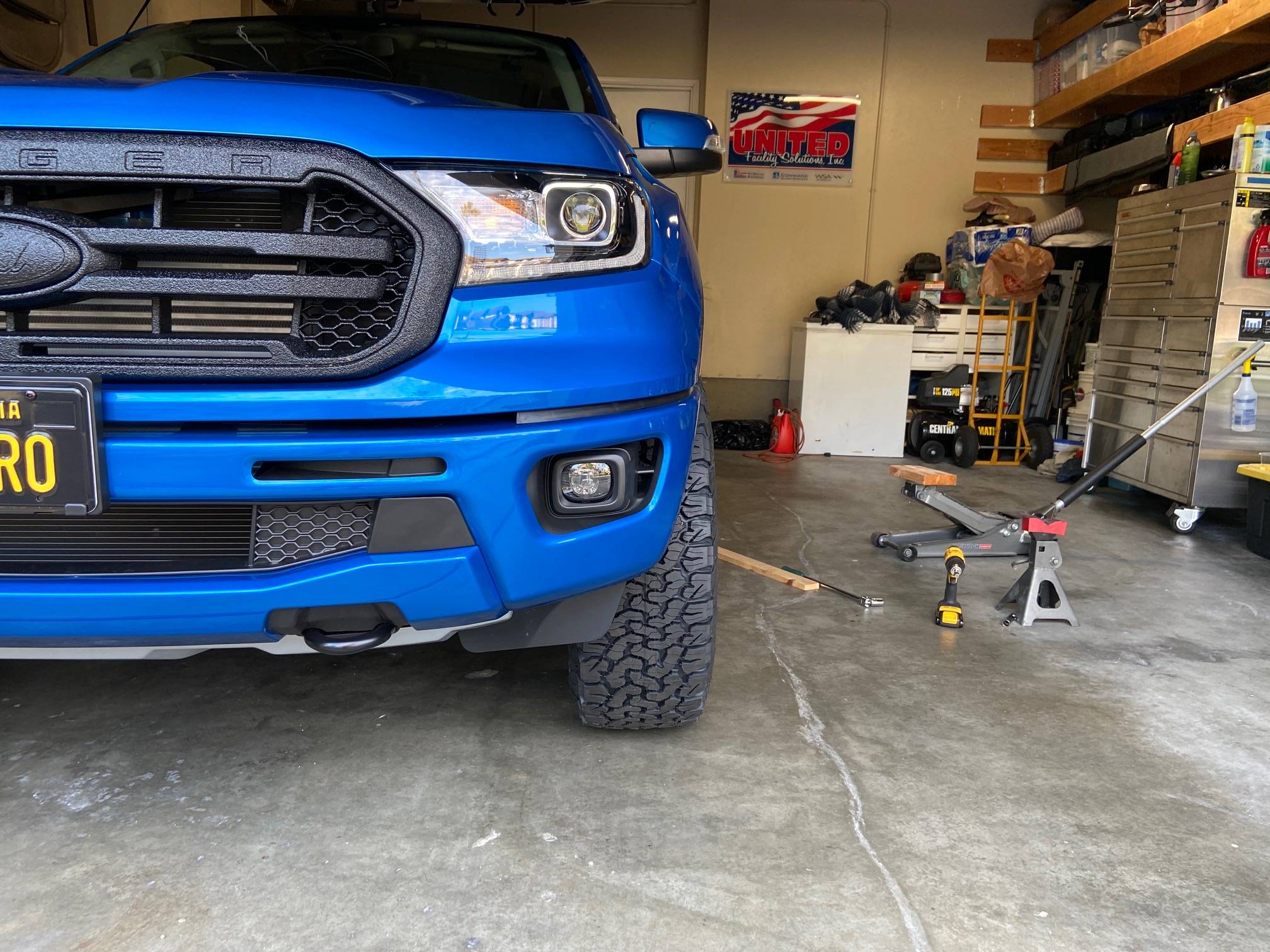

@mike_o44 did you ever figure this out? I've got +6 offset wheels, 285/70/r17 falken at3ws, and a fox 2.5 suspension kit, BDS crashbars. I have tire rubbing, even with the aftermarket bars. I live up in the mountains and rubbing U-turns in the snow are a nightmare scenario for the 4wd and traction control.
Just got back from the shop after trying to get a closer-to-stock offset (+25) wheel set installed to fix the rubbing, but they wouldn't install them because bringing the tires closer to the truck makes them touch the hose for suspension's external reservoir at full-lock.
I'm thinking fixing this via offset is a fool's errand, but I'm also thinking that maybe the ReadyLift crash bars provide more clearance than the BDS ones... thoughts?
@Mighty Little Blue mine's blue too, I'd love some advice here, we're truck twins!

to add to the tire-brands are different I have the load class E wildpeaks and even on their spec sheet they note they're 0.2 inches bigger in diameter than the equivalent C class tire.
what i really dream of finding is somebody who's compared the BDS vs ReadyLift bars, because if the readylift ones provide just a tiny bit more clearance, like 0.4", I can save myself a pile of cash and a roundtrip to the customs guys to imitate your mount-the-fox-reservoirs-closer-to-center strategy.
