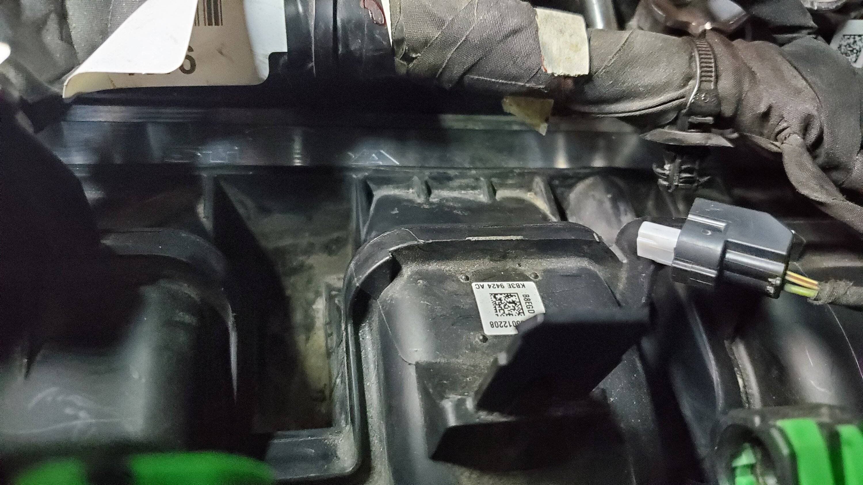

Time to try this experiment. Intake manifold spacer. Testing the general rule that longer intake runners usually help with low speed cylinder filling. Stock intake has pretty short runners. Higher rpm gains are not expected. Looking for more low end for drivability and mileage. If this does what I believe it will the low speed should pick up and I'll need to give it less throttle before getting into boost. It wants to get into boost at the lightest throttle and that helps kill mileage. Have to say that the way the port dividers are machined this should help with the flow over the other designs (orange spacer shown for example) and non divider style with some venturi effect.

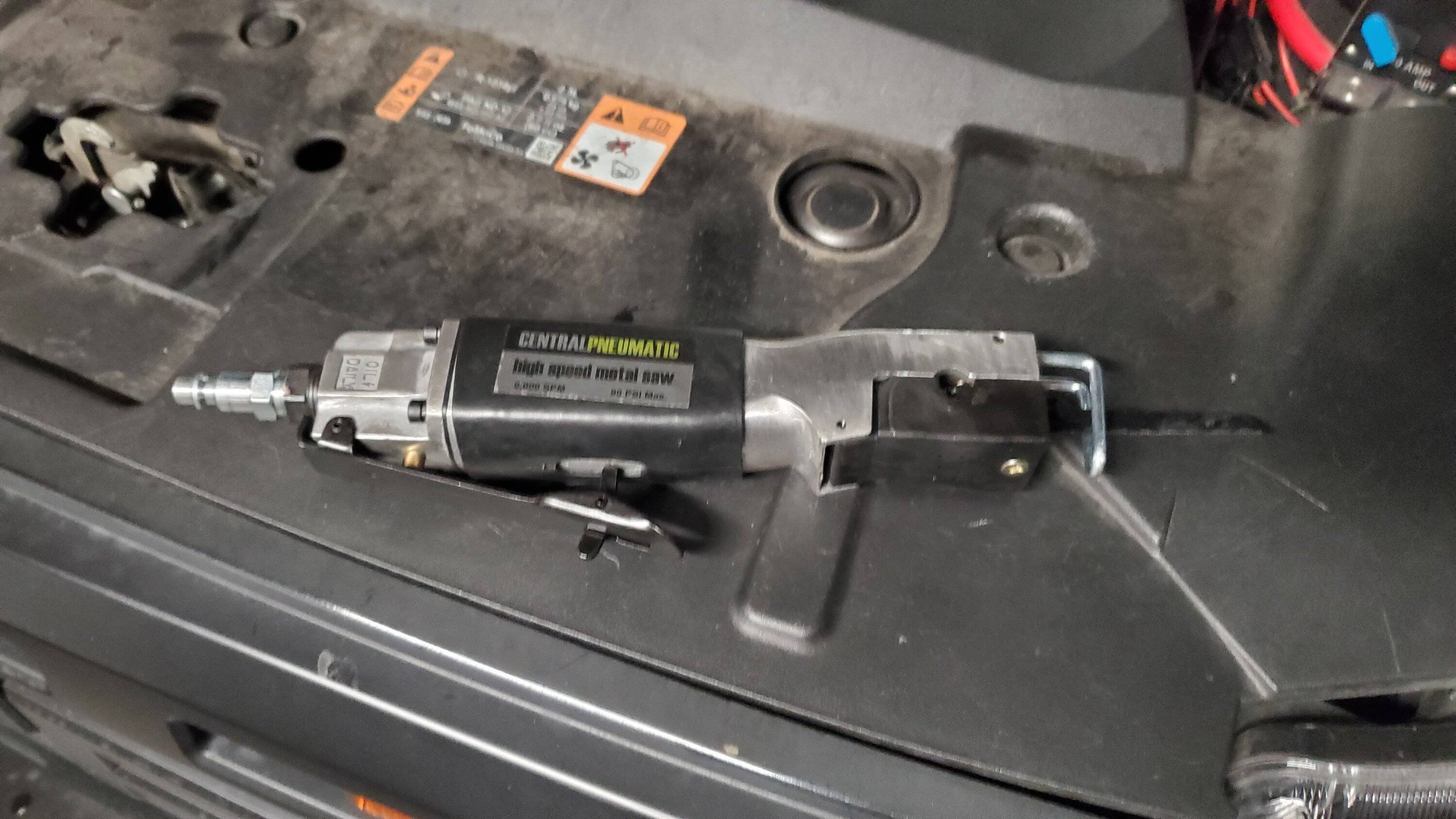

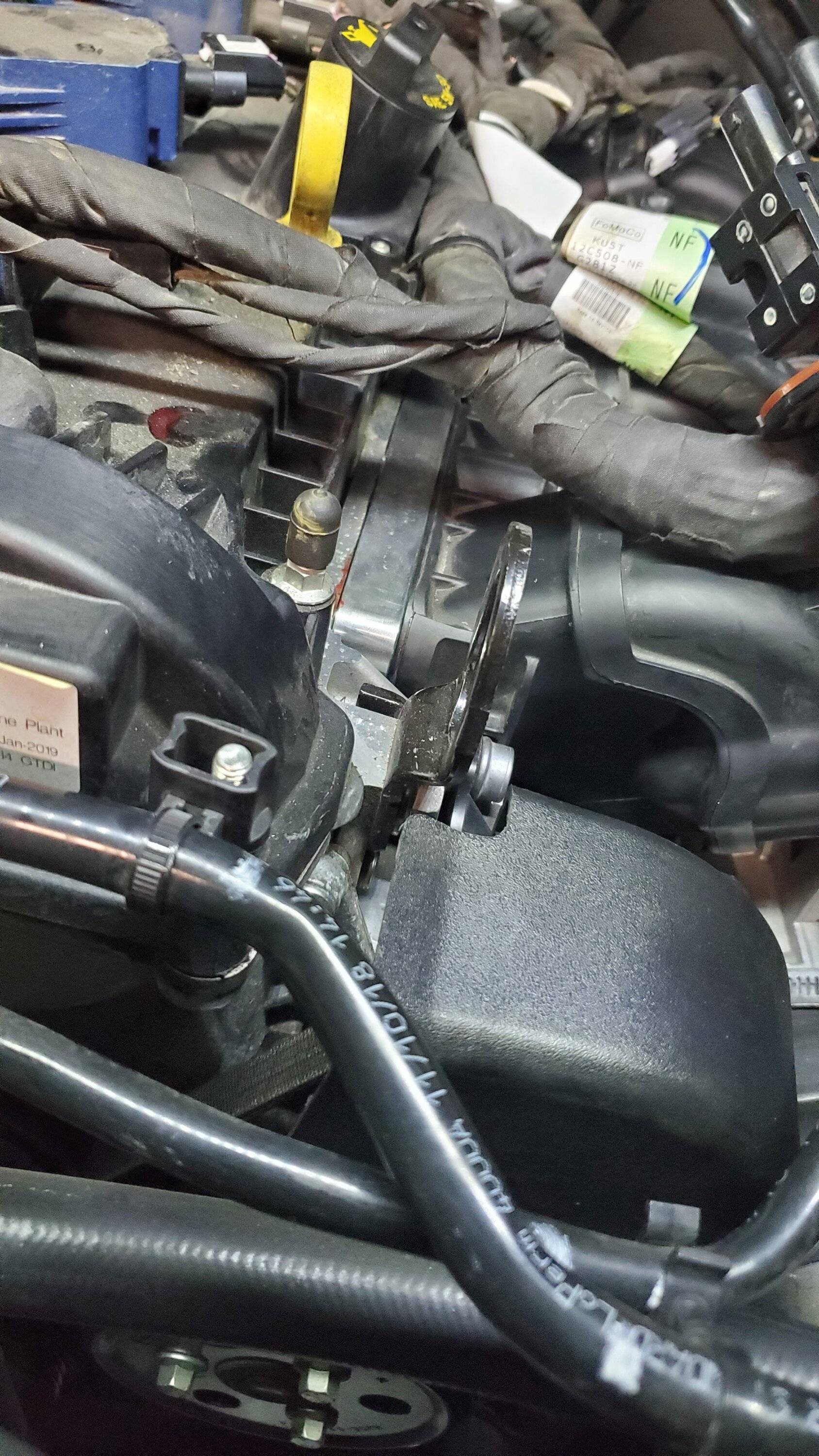

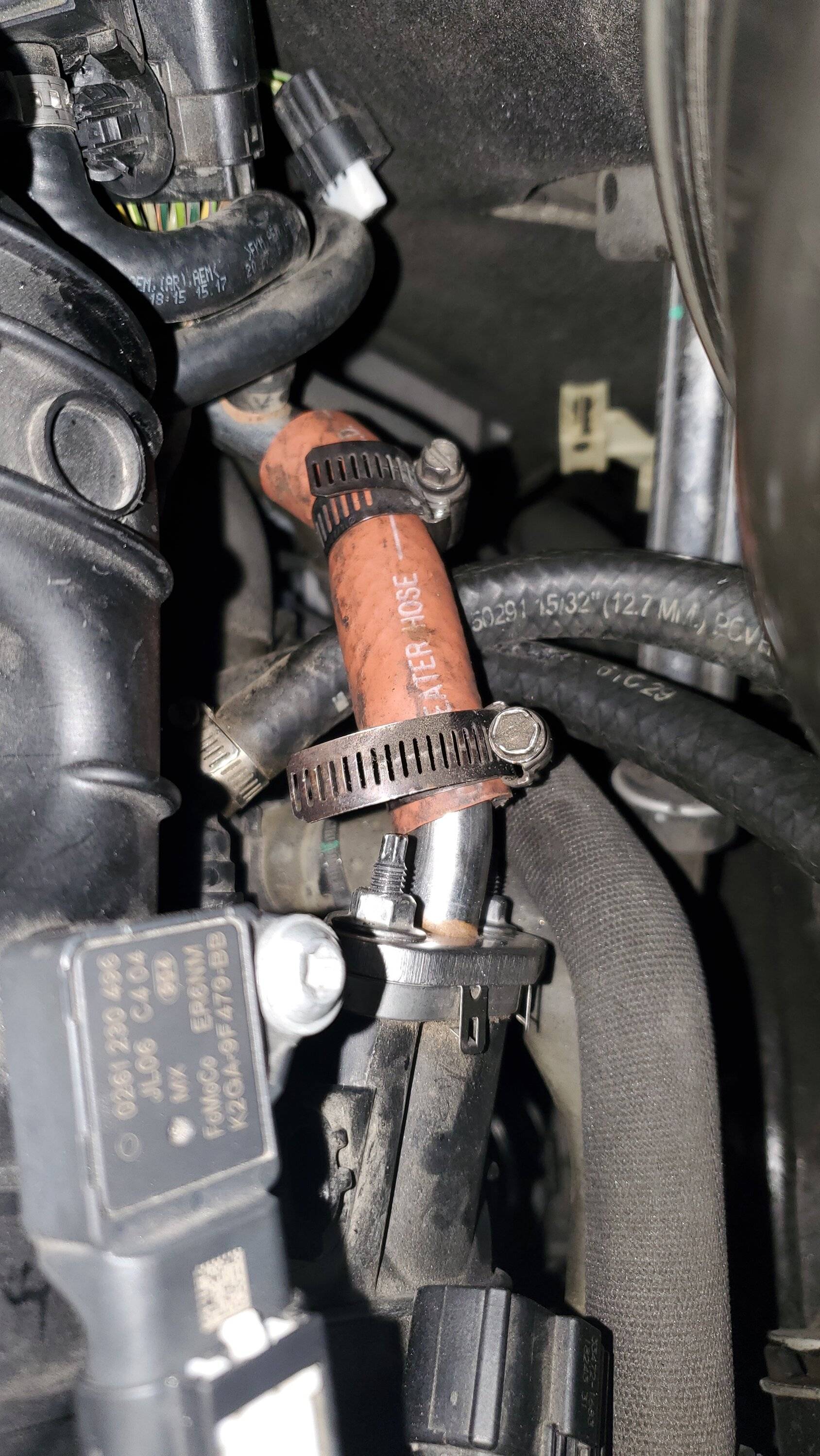

Quite the nightmare project. Found out the hard way there's a tab for the EGR tube at the back of the manifold. It was binding everything up from lining up. You also need to cut and extend the EGR tube since the manifold is now pushed further out. Had to buy a saber saw to get in there to cut the tube. Now to drive it and monitor the mileage and see if there's any gain with the intake manifold spacer. Yes, that's my blood there. So, it automatically gained 25 horsepower.

I can't see that heater hose holding up on the EGR pipe. It would get pretty hot from the exhaust flowing through it.

Makes sense. Maybe if I find a egr tube extension that is metal. I did find one but it’s 20 inch extension.. I’m not too keen on hot exhaust gasses flowing through a plastic tubing, feels like another point of failure after a while. But just assumptions

I also wonder if that tube being plastic will gather more carbon build up due to it being more porous? Hmm, just thoughts. Might not be a substantiated claim

The flow only goes once in a while when the valve opens. I've used heater hose for the air injection tube on fox Mustangs for decades without issue and that's constantly exhaust flow. No idea where you would find metal extension for an egr tube.

Good to know on the past experience with heater hose.
I have read some people are getting it welded with some metal piping but that seems like a bit of work too.
