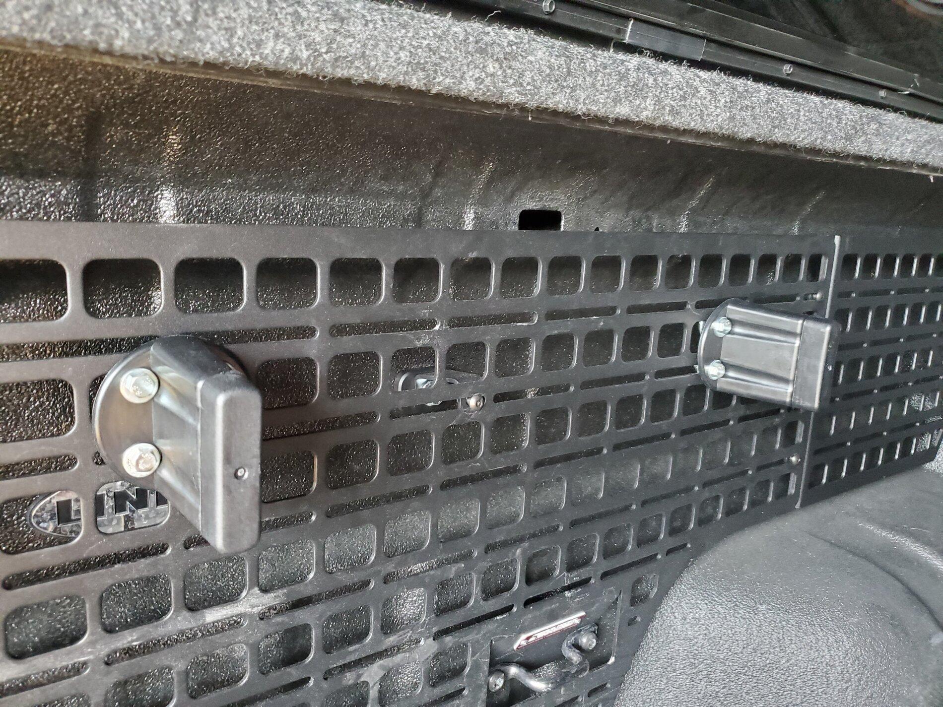

Since my previous attempts at chase lights kept ending up too dim I figured why not use the bright enough stock hazards? Used a wig wag flasher module with diodes so it won't feedback into the stock system. Hazards and turn signal unaffected when off.

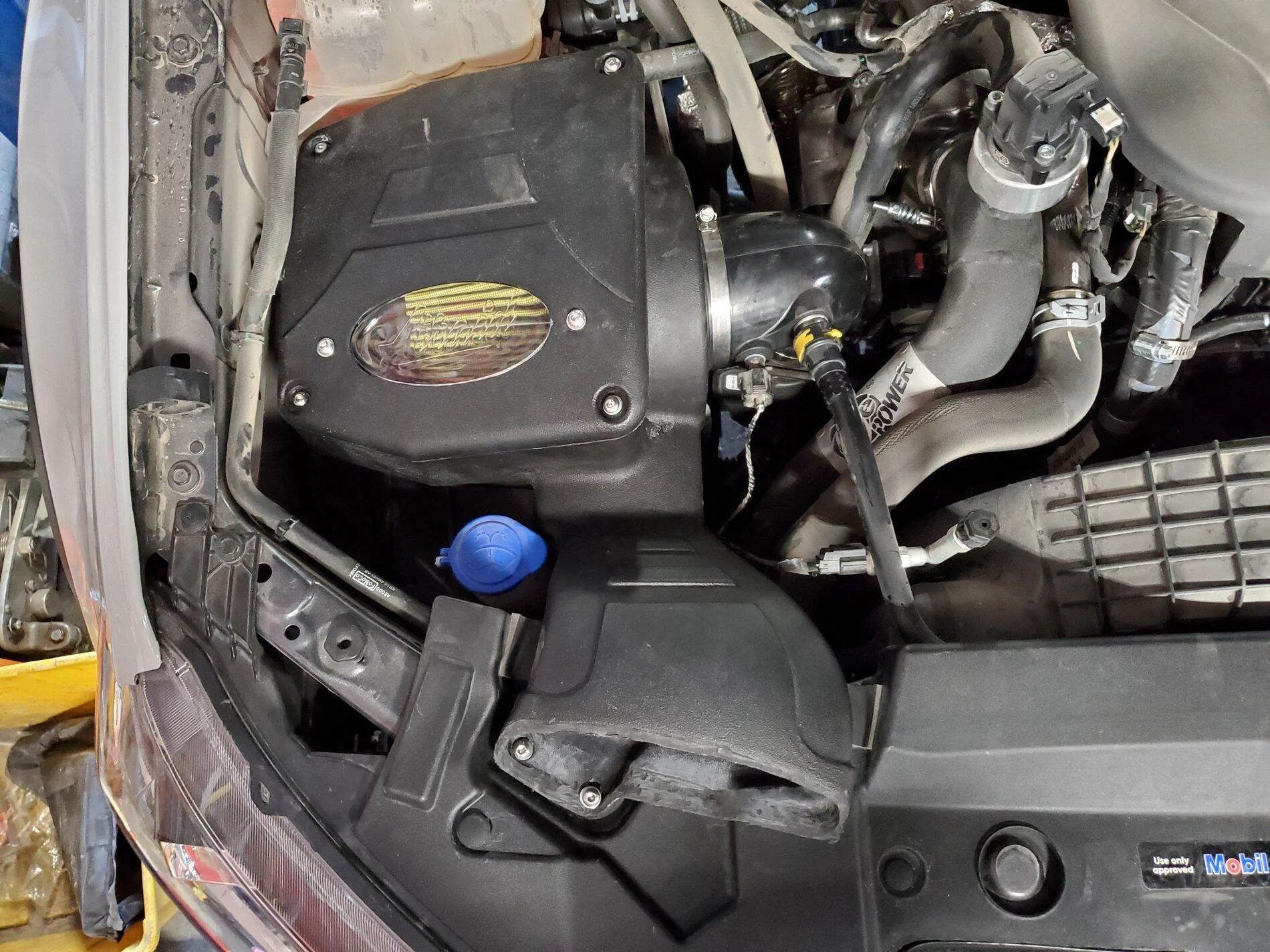

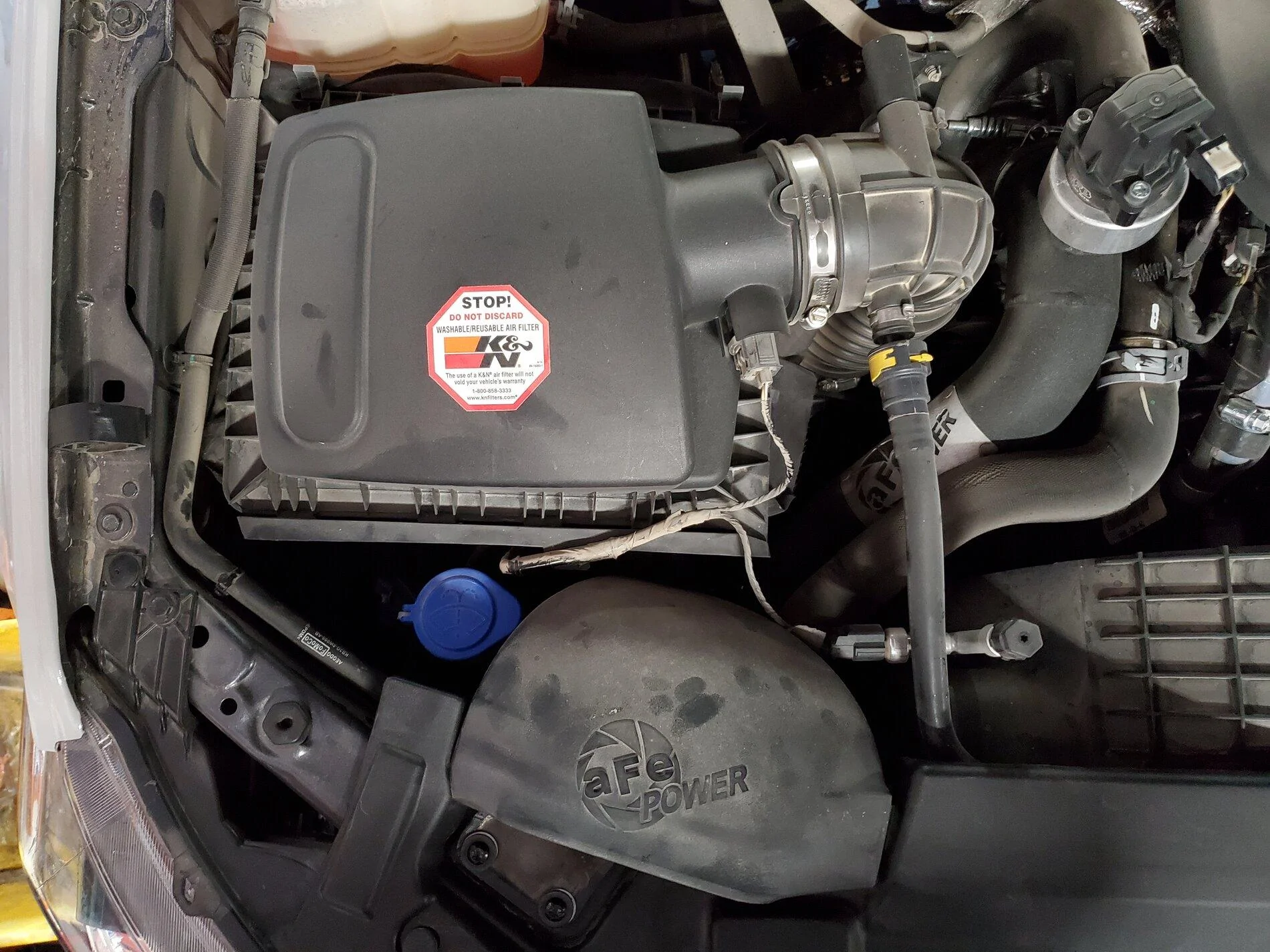

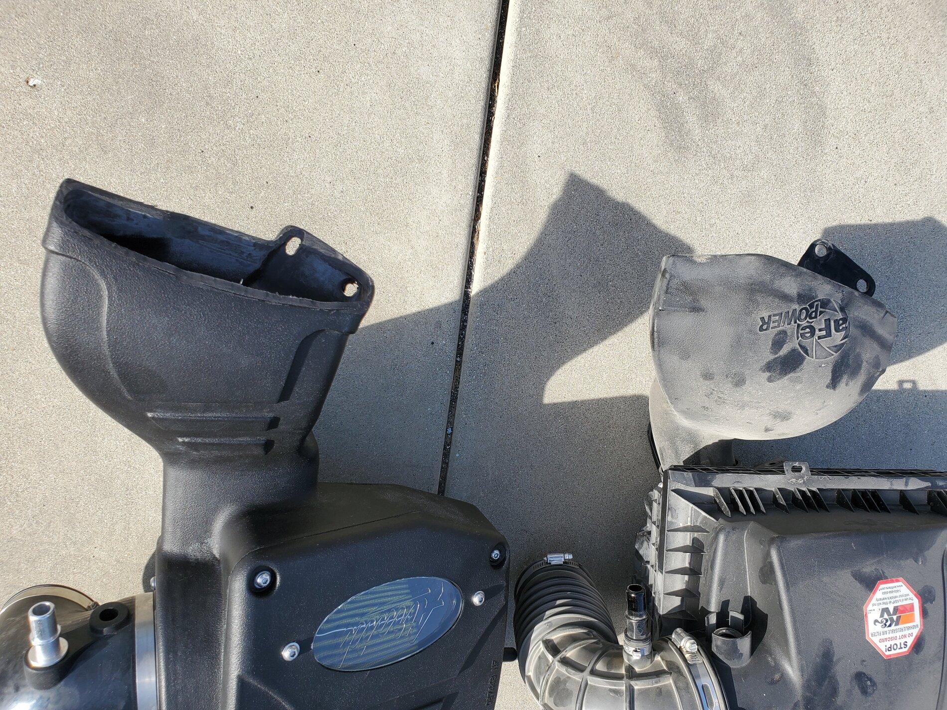

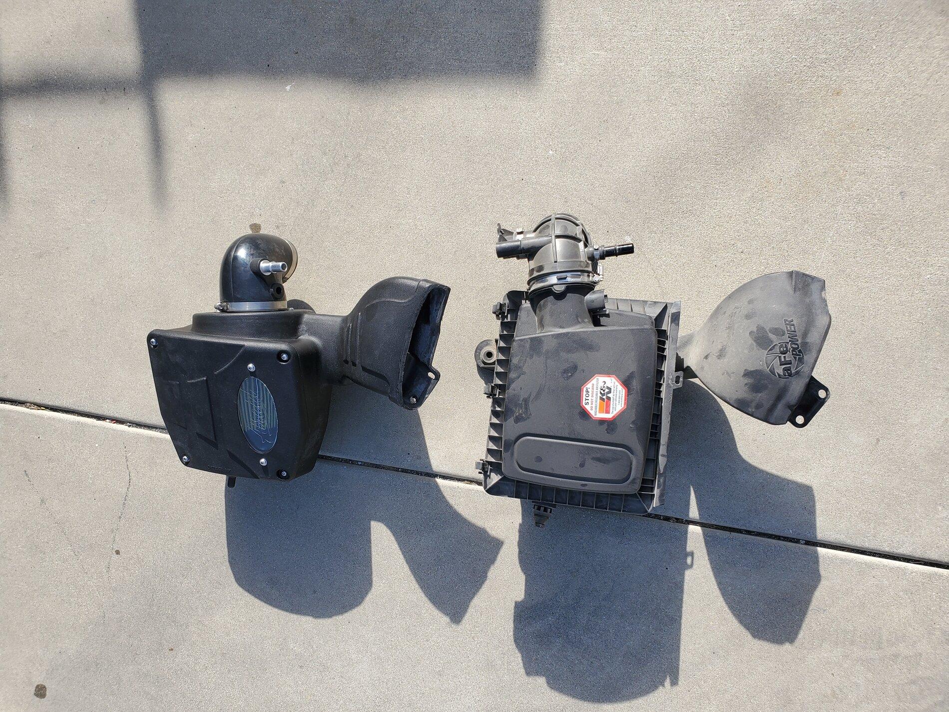

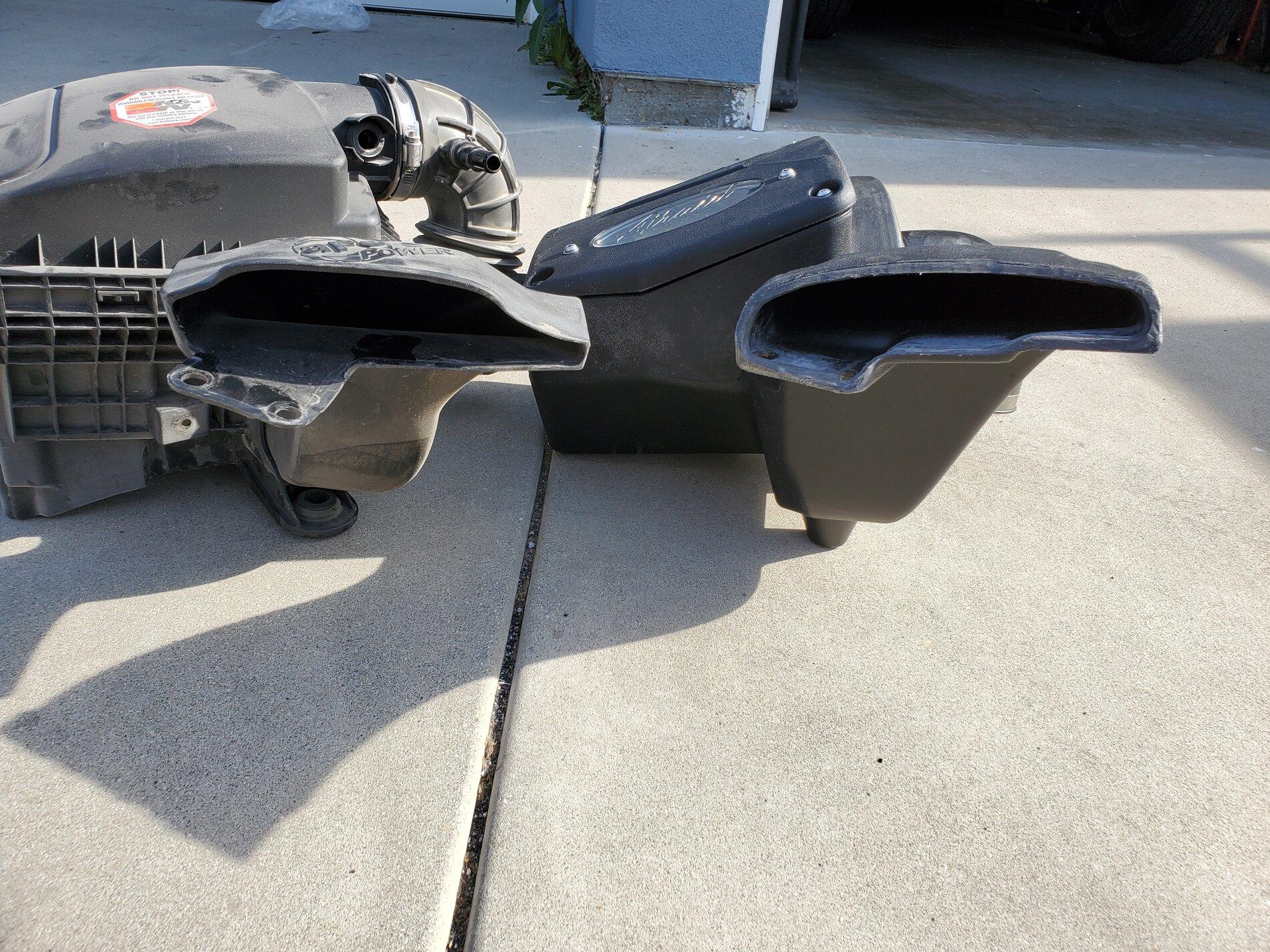

Let's see if the Airaid intake is any better than the stock box, AFE scoop and K&N drop in filter combo. The main opening is a bit better on the AFE scoop but overall the Airaid is much bigger than AFE and stock to the box. The box to the stock half of the hose is definitely better than stock. Now if only someone would make the half of the hose to the turbo side.

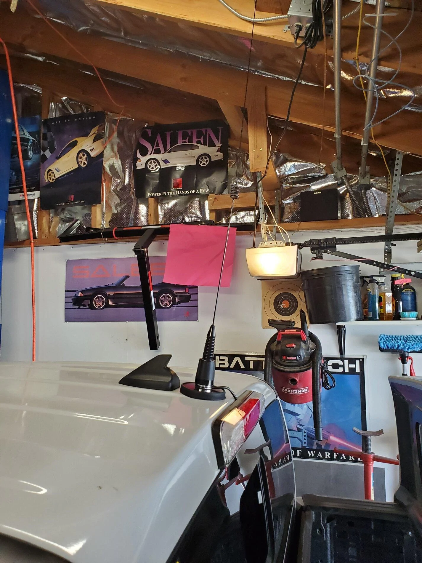

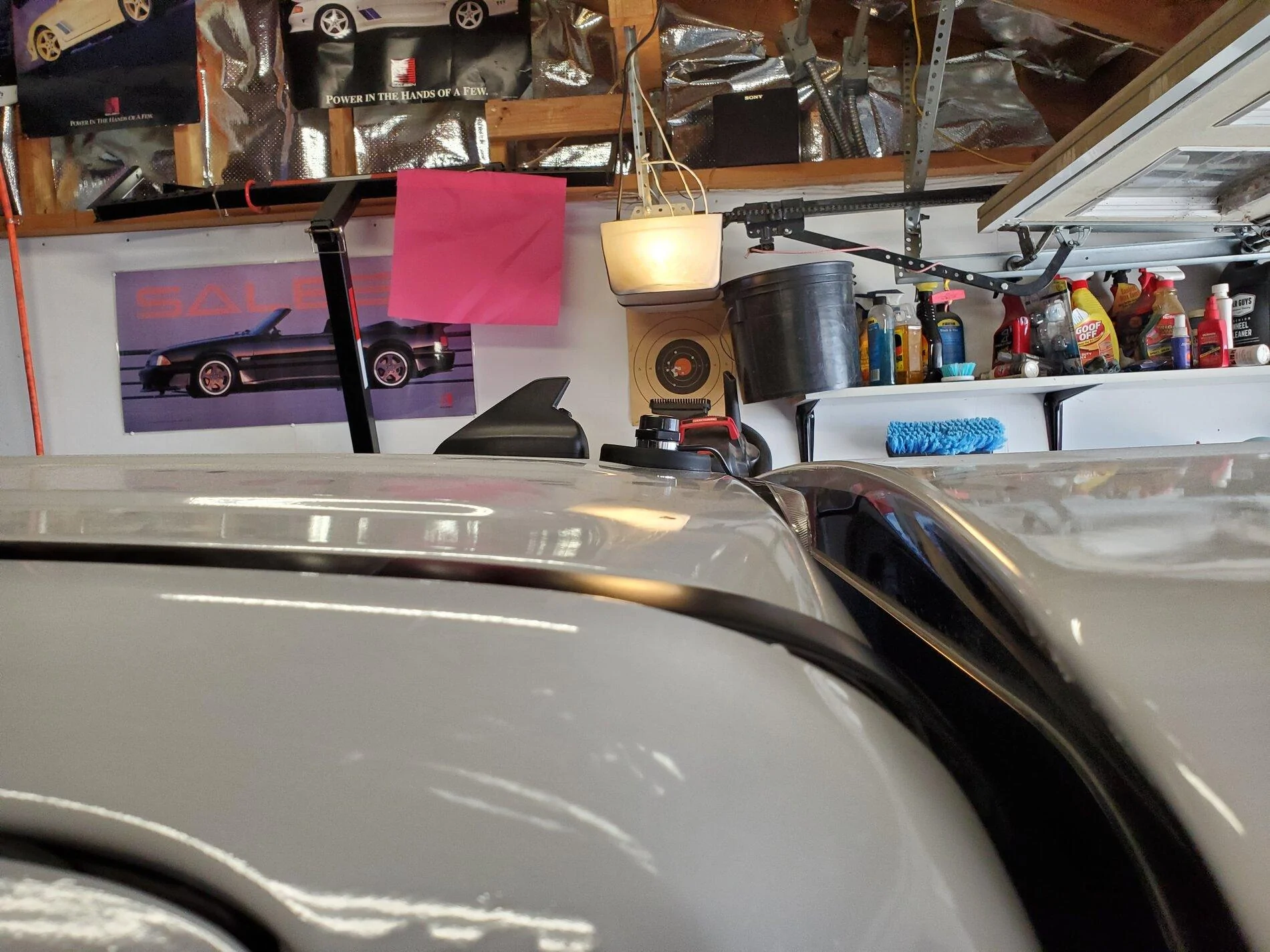

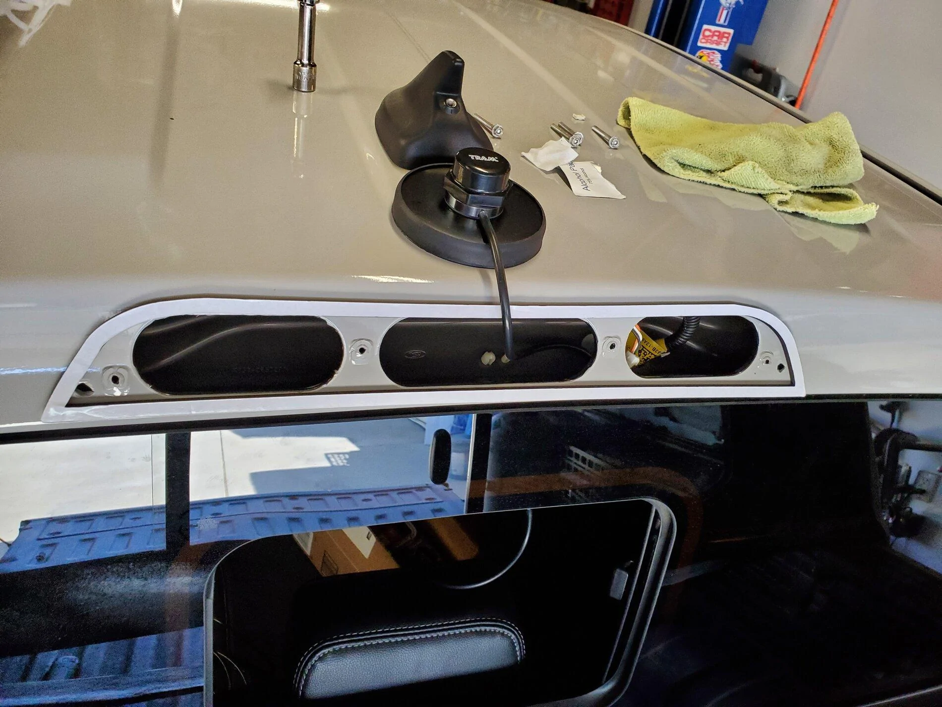

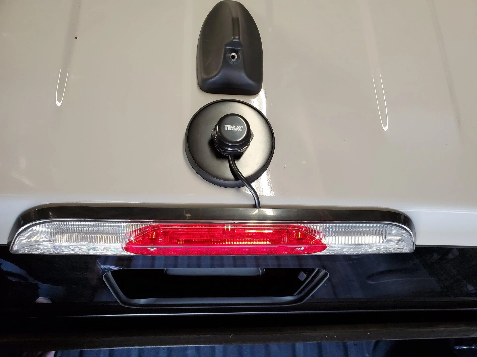

New 6bd antenna and magnetic mount. Added a second gasket for sealing. NMO cover for when I'm not running the radio.

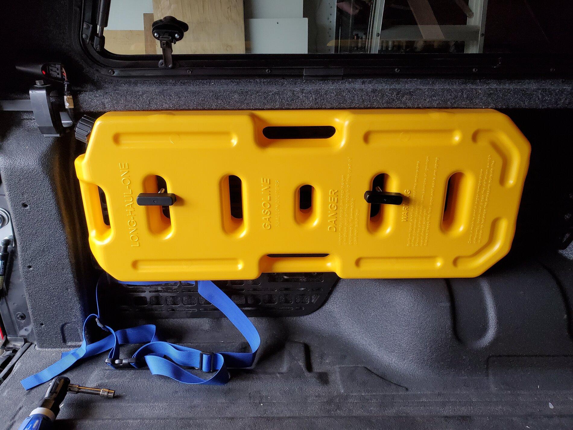

I think I'll keep this setup for emergency fuel. For $91.28 it ain't no Rotopax but I'm cool with that.

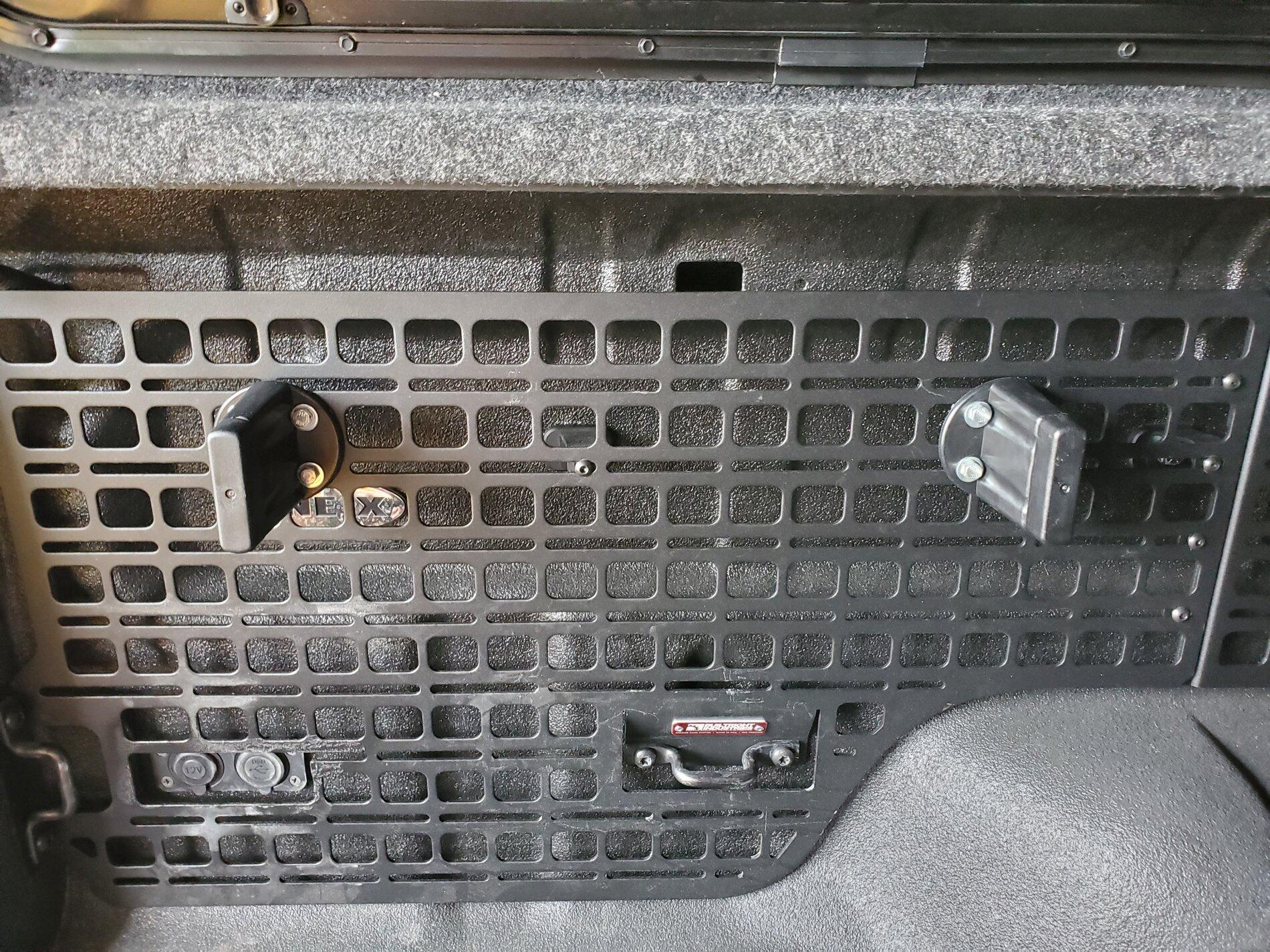

I love this idea, but I wish they had one fitted for the front side of the wheel wells. I already have the swing boxes mounted in the back. I know I could probably buy and cut but that seems wasteful.
Which wig wag did you use, and did you splice directly into to the existing harness?
Cut wires because I had to use diodes to prevent feedback into the stock system.
