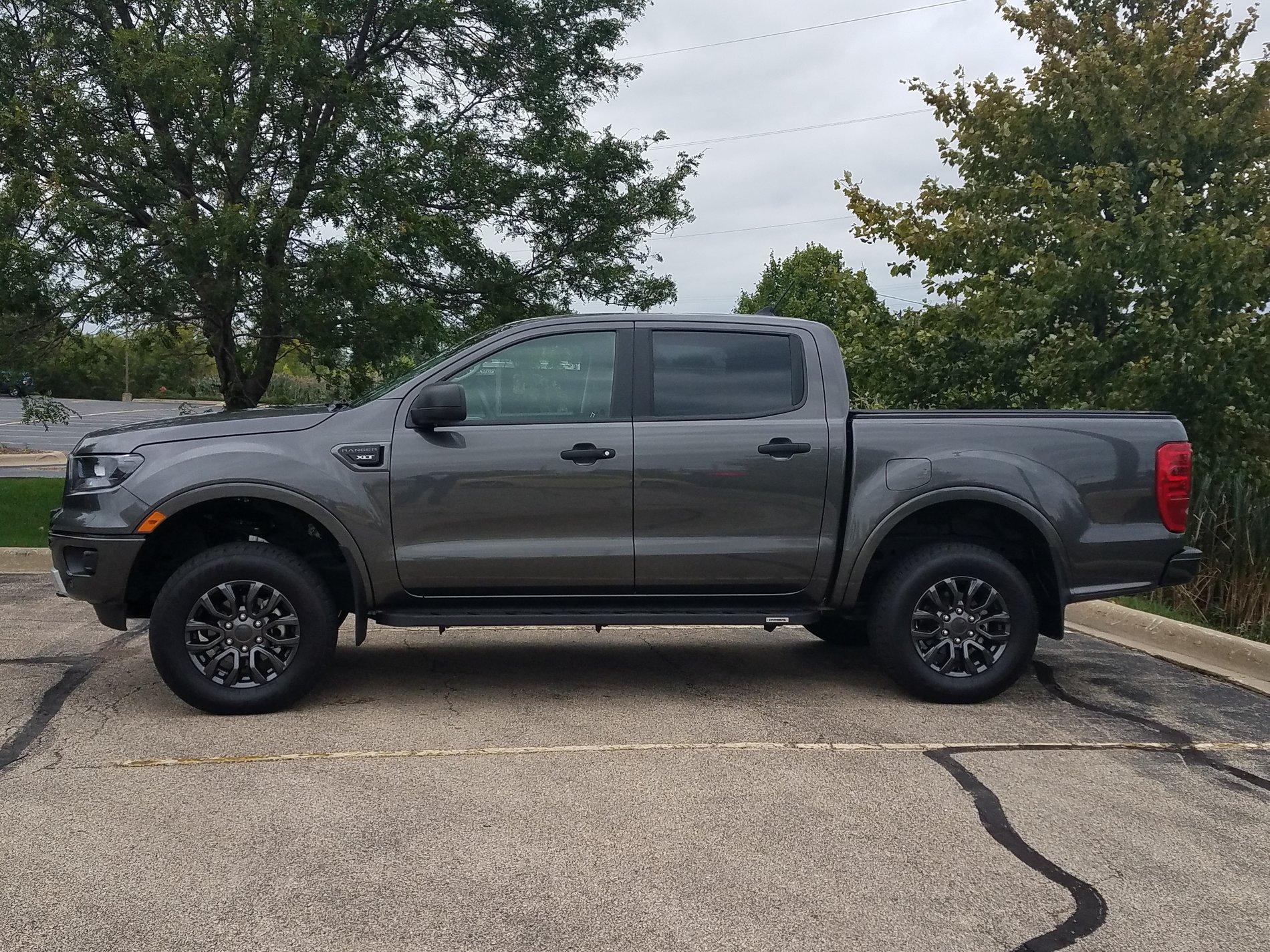

Yes I had an alignment too. I haven't had time to check out the front cameras yet as this took up most of my day. I don't use the adaptive cruise but I want to make sure the front crash assist is properly adjusted along with the headlights.
ok, no worries..mine goes in tomorrow for the frt 2.5" level/lift. Guess I will find out.
BTW looks good.

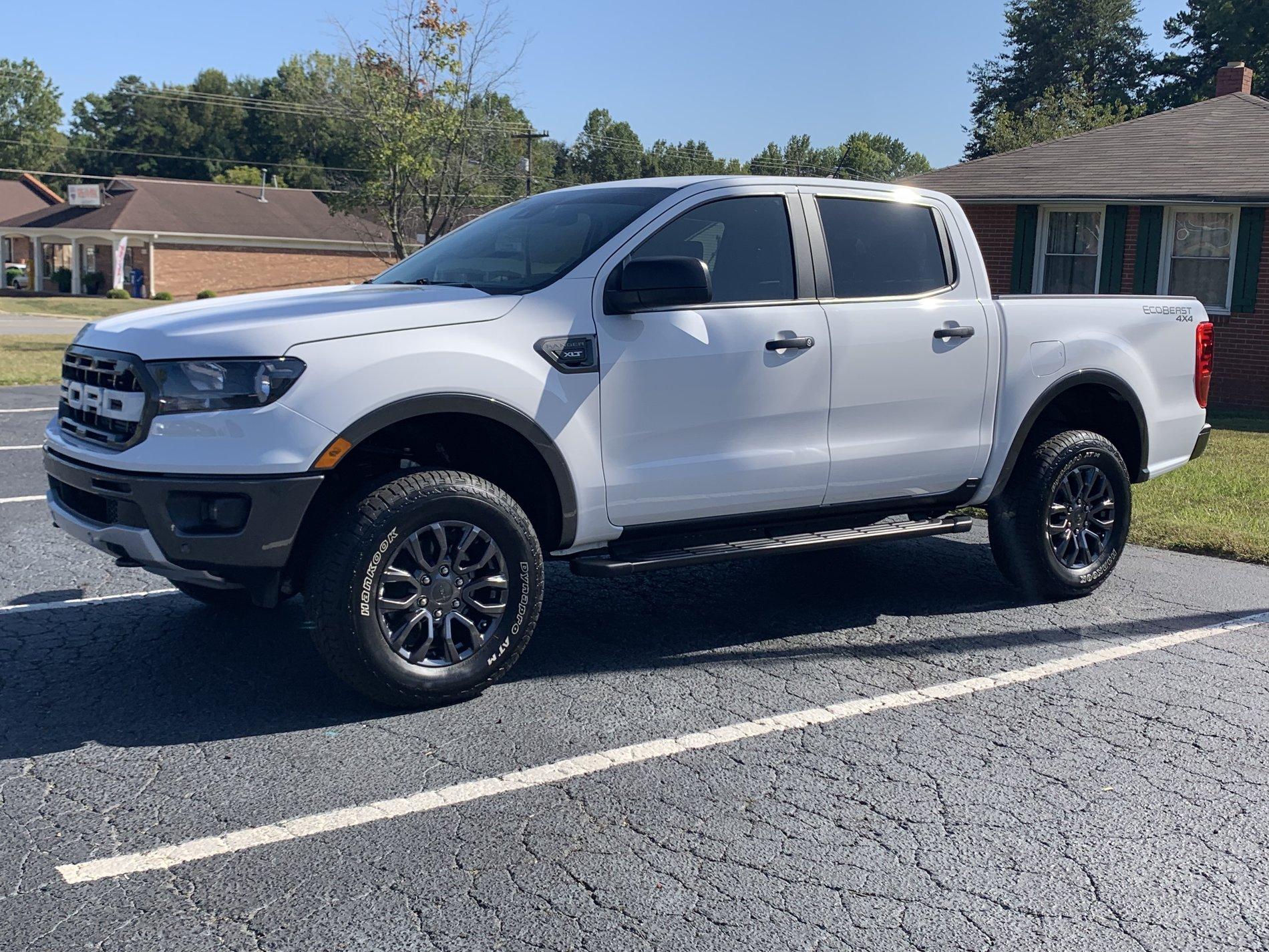

Thanks....I just tried out the crash assist and while it did work I think it came on a bit later than before. I don't do much highway driving and IIRC it use to come on a little earlier, I have it set to high and it went off about 2 car lengths away now. I'll have the dealer look at it when I go in for my first oil change. Good luck with yours and post some pics!

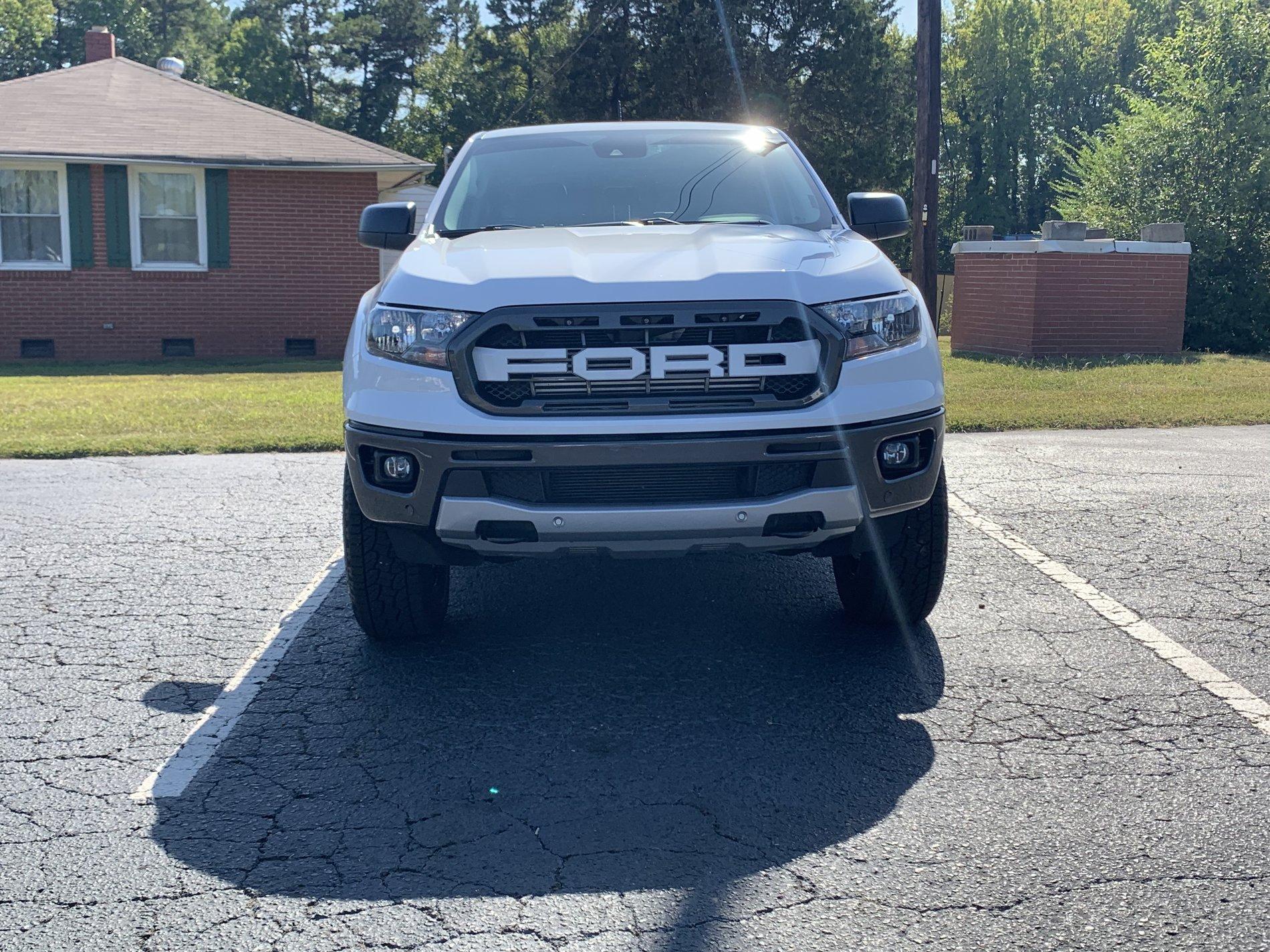

I just installed a Rough Country 2.5" level kit from @PandaMotorworks along with 265/70R/17 Nitto Ridge Grapplers and there's NO rubbing or cutting. Very quiet street tire and aggressive for off roading. Took the advice from others on here who have this same set up and could not be happier. Unless you're going to be towing or hauling heavy loads I see no reason to go with the 3" level or LT tires. :)

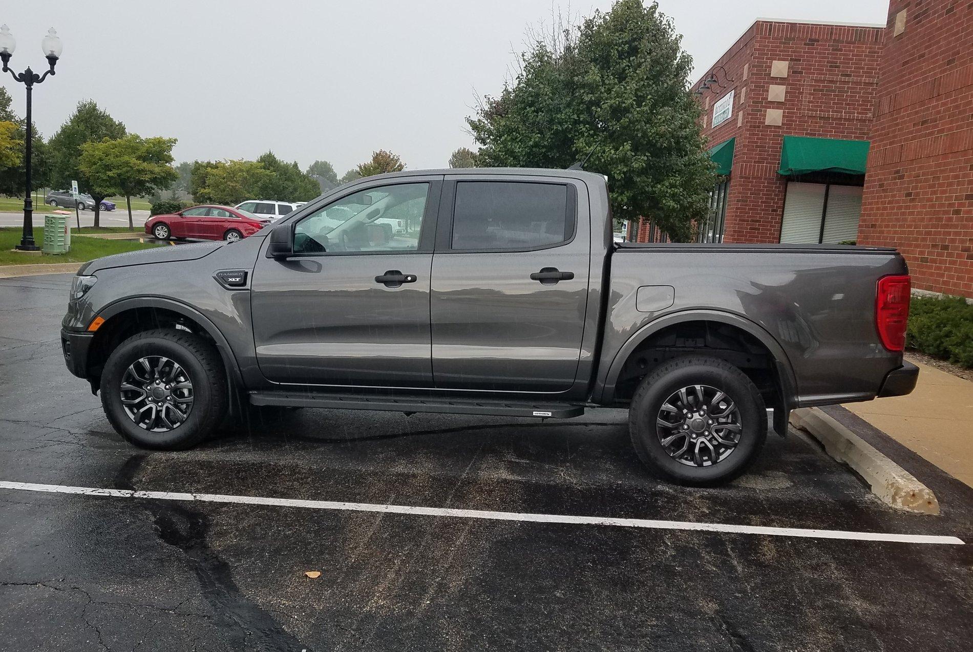

Looks Great! I can't remember are going to do tires too?
not now, ive only got 2800 and a lotta life left in the oem hoops.
i will be interested in a +1 size whn time comes though, been happy with cooper street treads on my ram [last two sets].
really like the height. local 4x4 truck parts did it for $380 w/align. seems like a great deal.

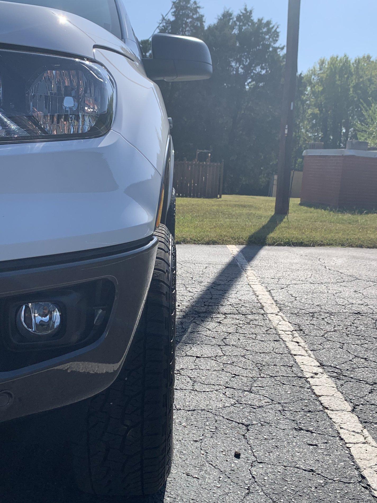

does the tire stick out past the fender?
340
26,717
134,858
No it does not. Using the stock wheels and no spacers the Nittos are the exact same width 10.4" as the stock Hankook tires. Only the diameter change 1".

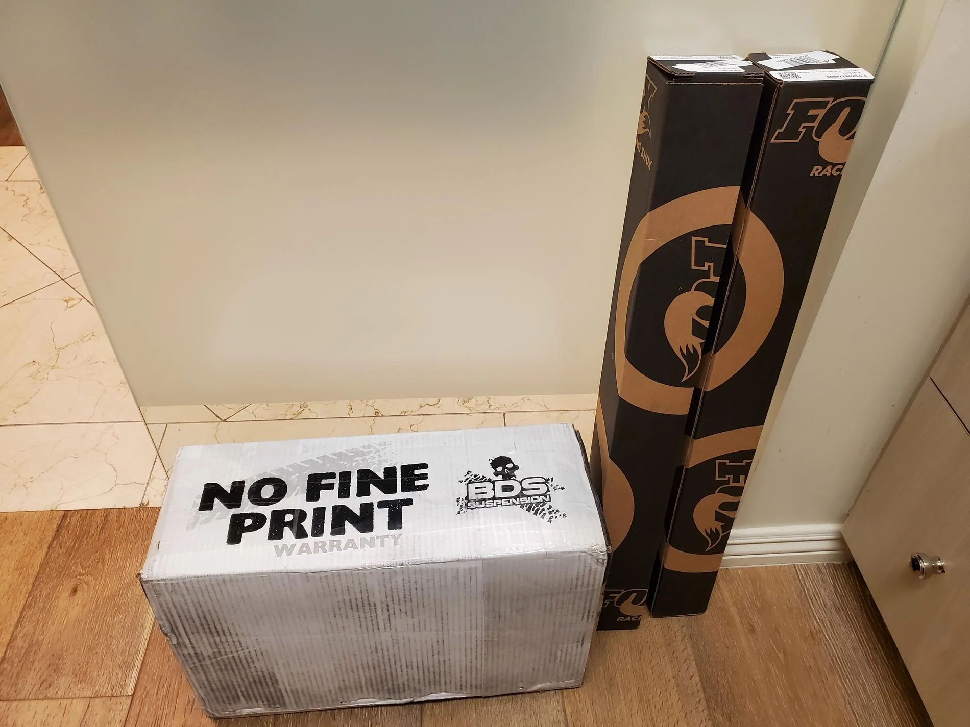

So... My 3.5" BDS lift just showed up! Guess I'll take tomorrow off work and get crackin...
