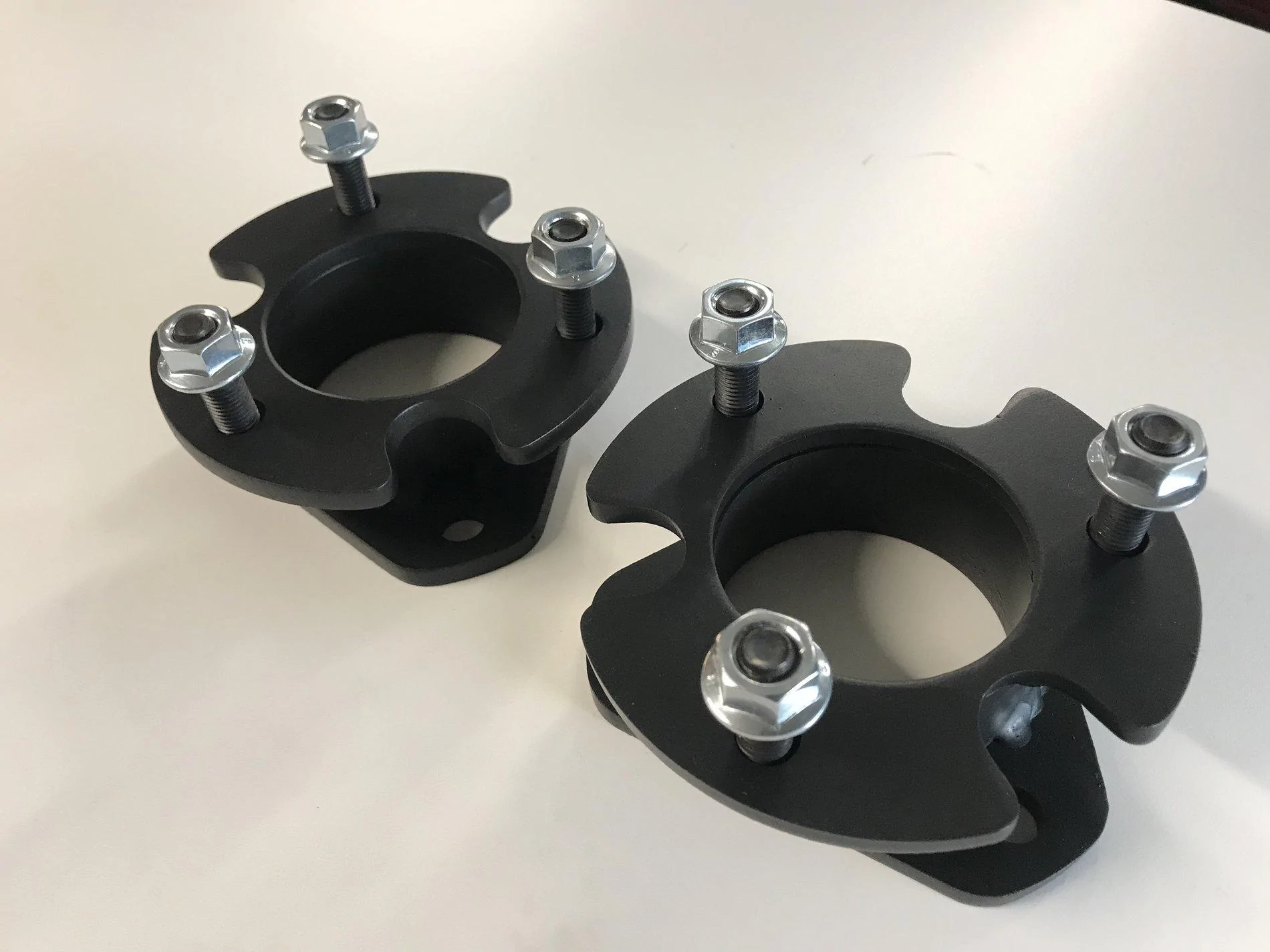

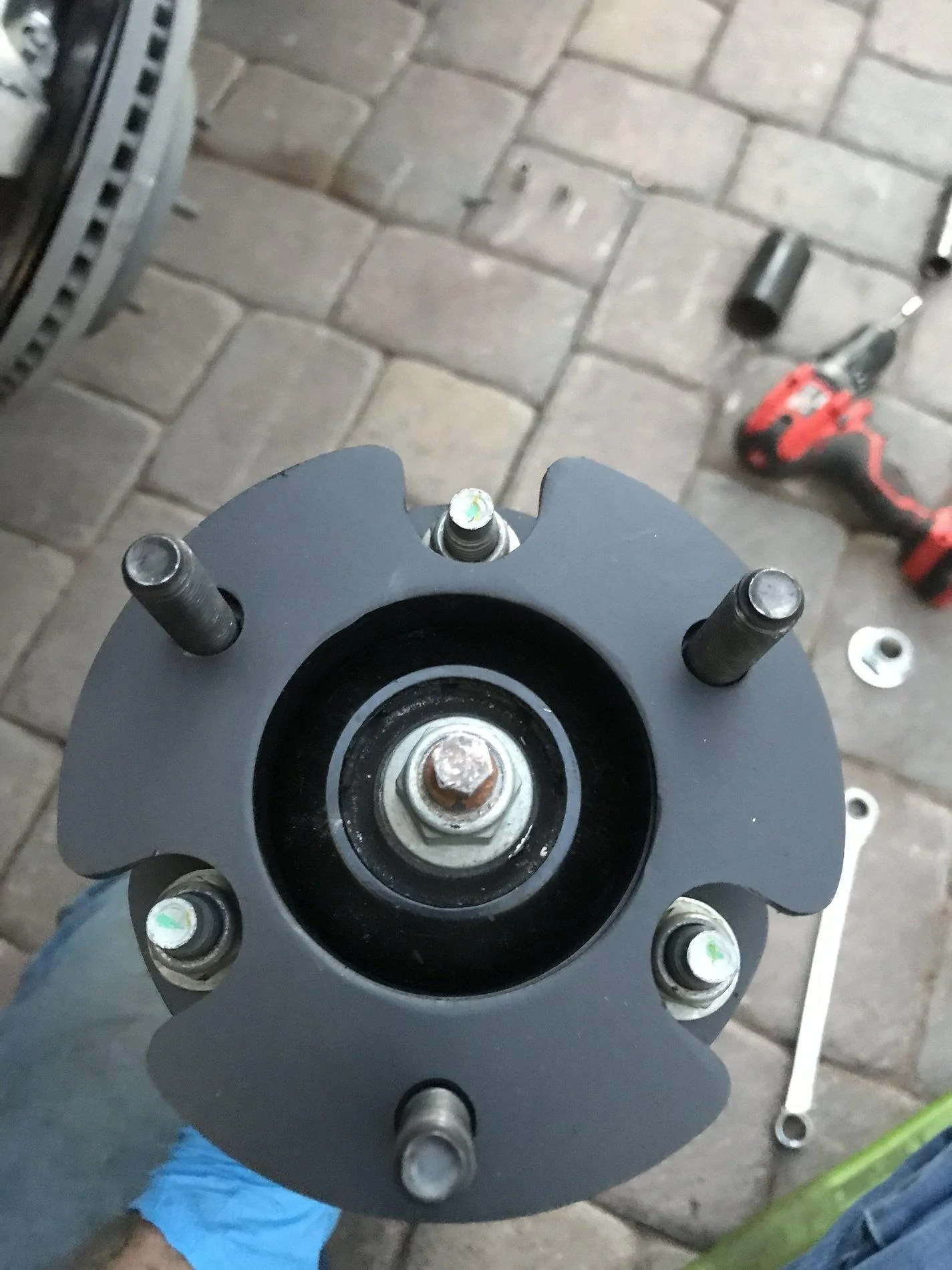

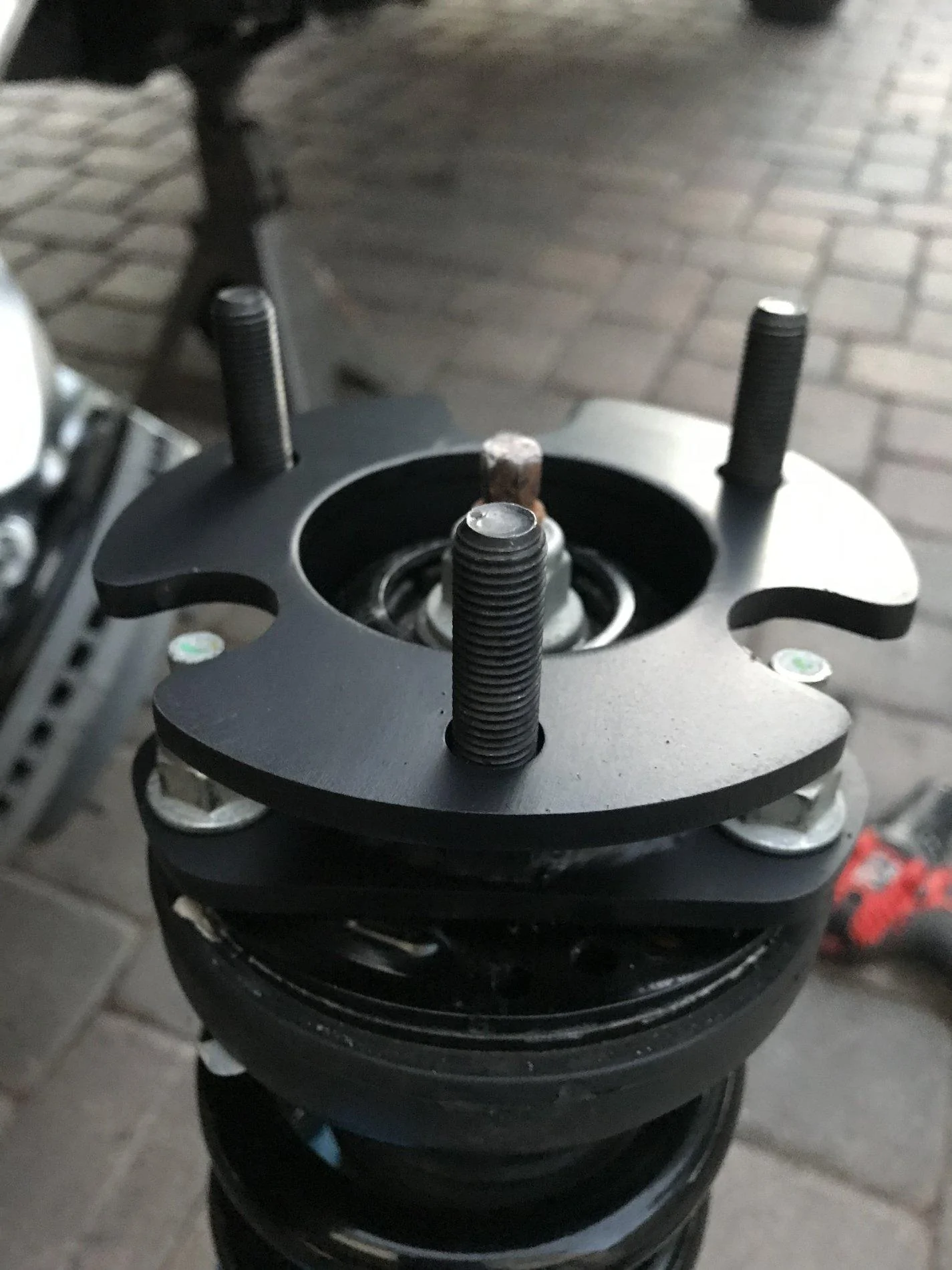

The reason for the split spacer is to reduce hardware. They are using only the extra space available on the threads to reattach a nut. If the spacer was taller, then they would need longer studs sticking up through the strut mount. They are going max on top and then whatever space is leftover to get to 2" they are adding to the bottom of the strut. There are many kits like this, but either way the upward travel and downward travel will be same. Neither one does more or less travel than the other. The 3" kit however adds preload to the spring. That will change ride quality more than a regular spacer will.

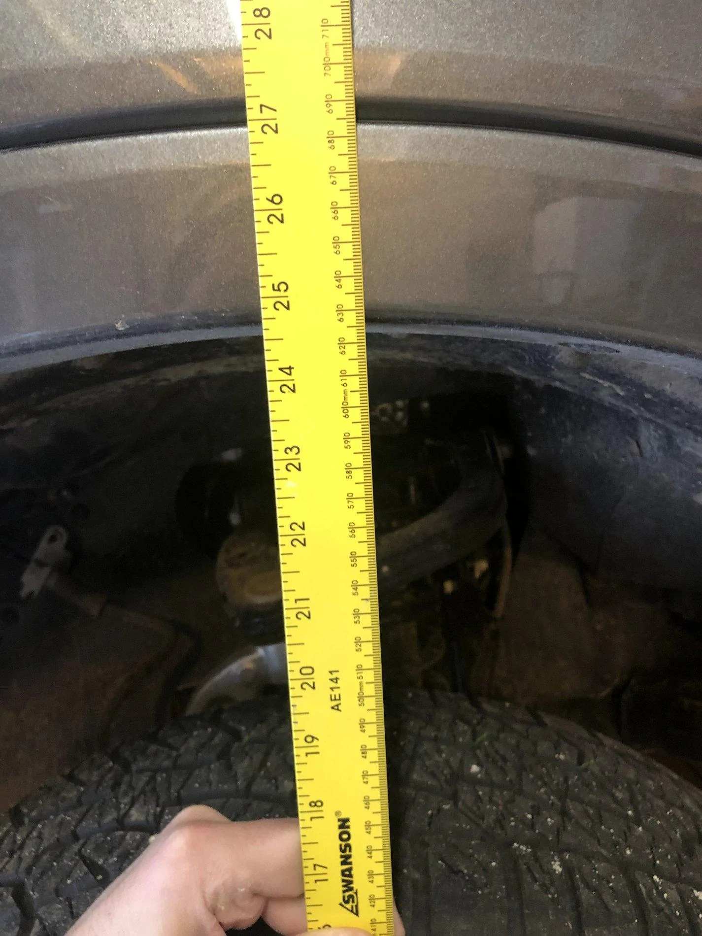

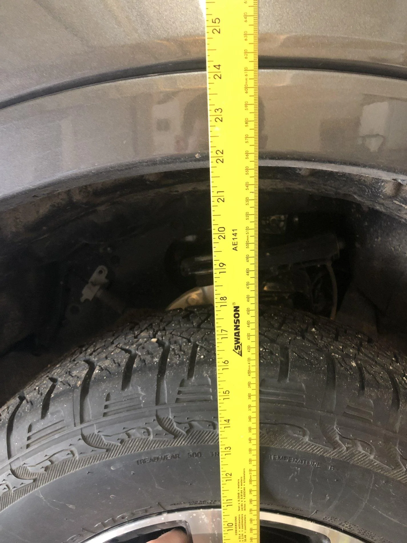

So just for my own amusement I measured from the center of the hub cap to the top of the fender with the weight of the vehicle loaded on the front suspension, then I jacked up the front end and re-measured.
Itā€™s 2.75 inches difference.
How much did you jack the truck up?

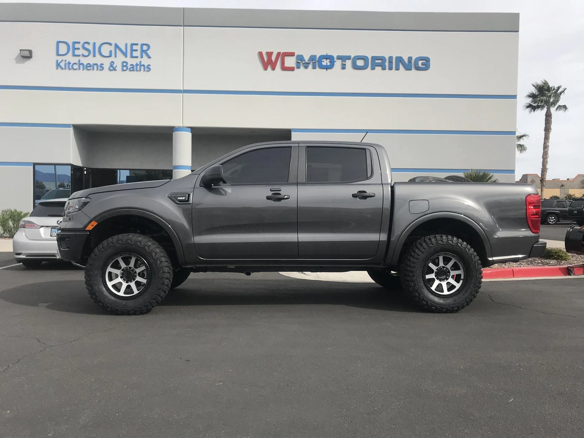

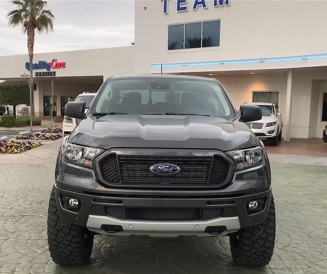

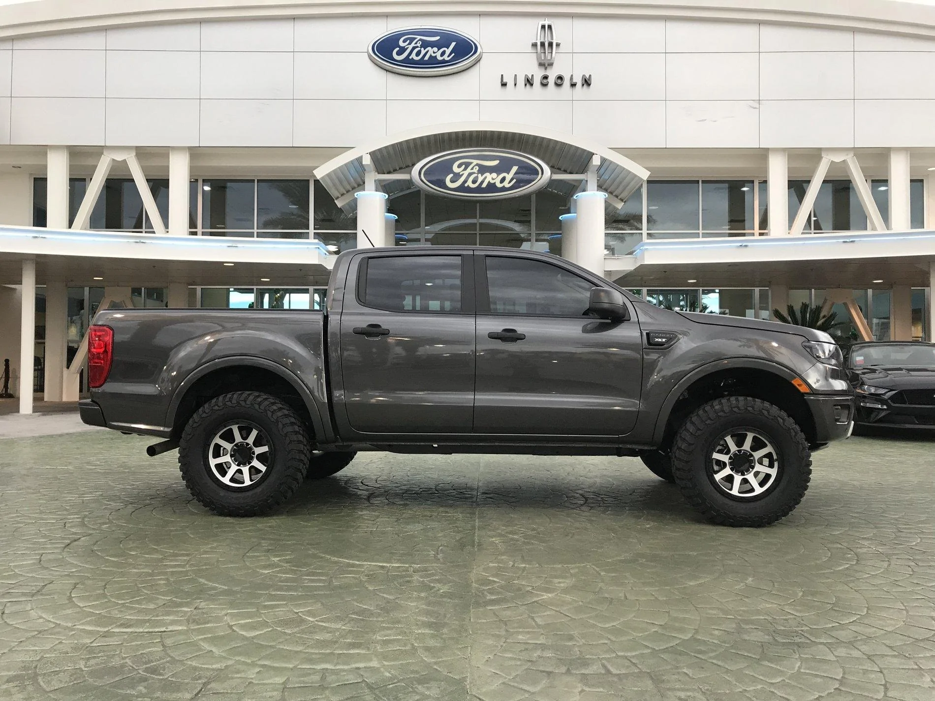

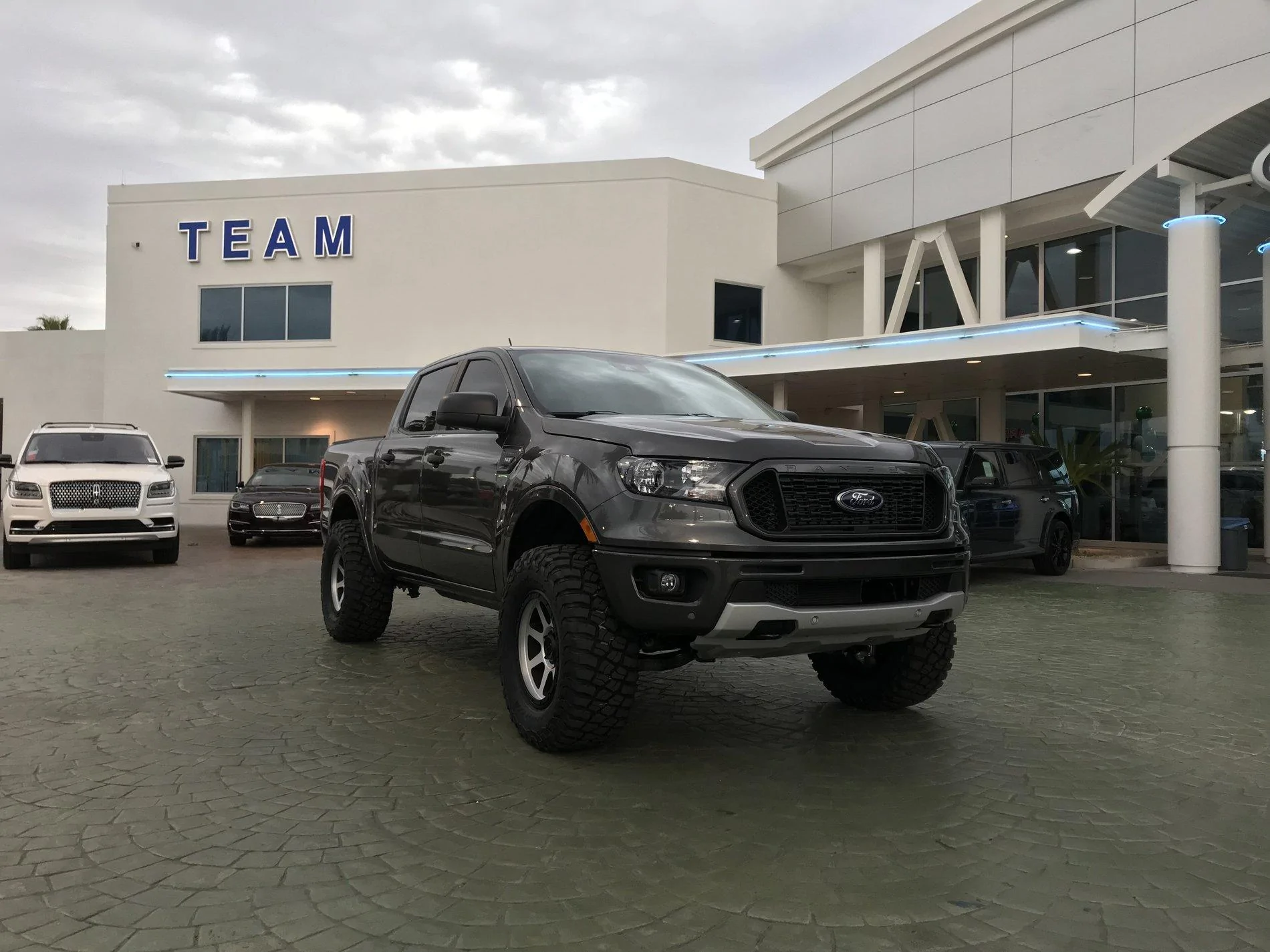

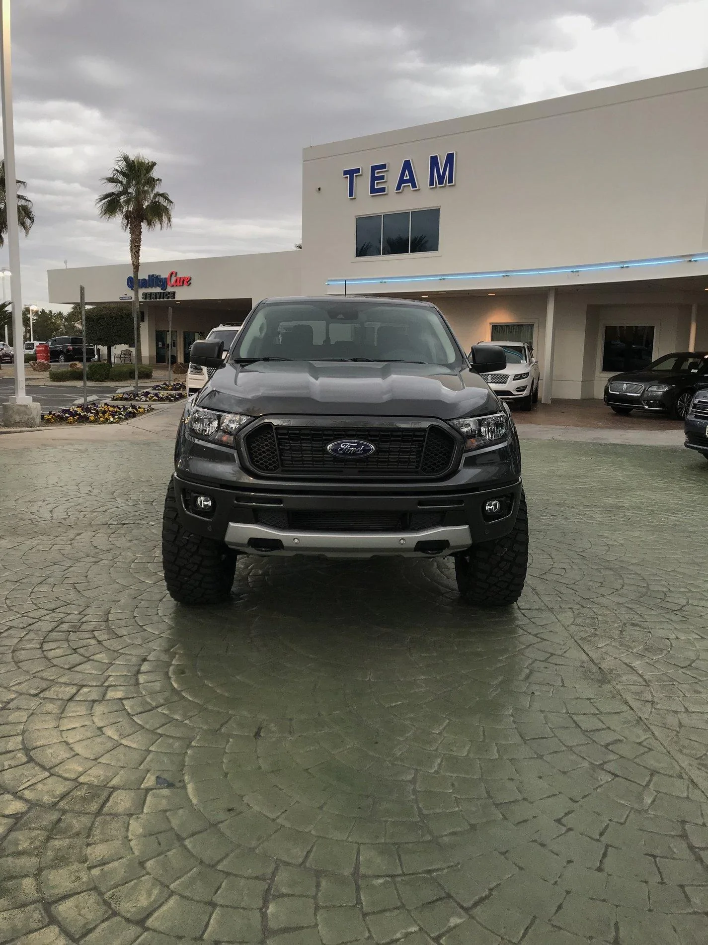

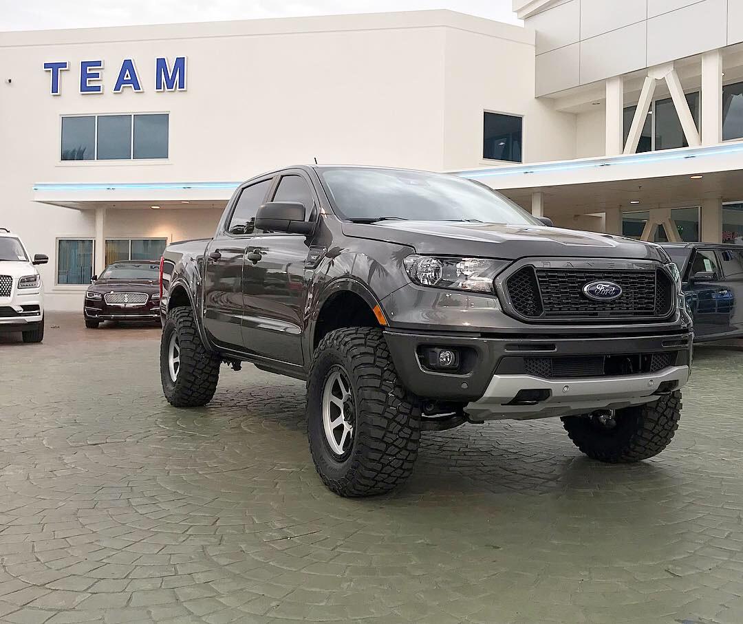

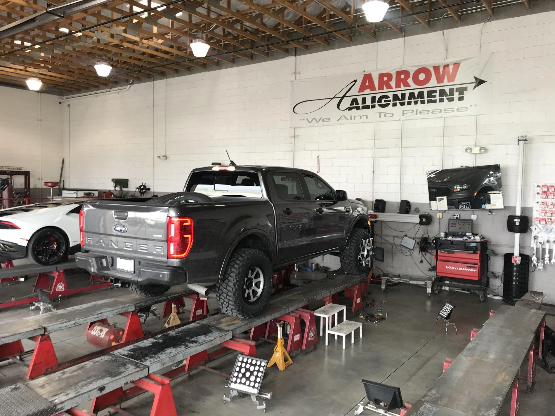

Woolworth Motorsports built true 3ā€ level lift with 33x12.50x17 bfg km3. 17x8.5 KMC wheels with zero offset and 4.75 back spacing.
Have you taken it over some bumps at speed to see if it rubs? What if anything did they have to remove?
Yeah, what @Andy said. I can see the front air dams are gone but what else? Crash bars, trimming.? Personally, it looks like too much tire for my taste but I am sure that I will be in the minority as far as that goes. Nice truck!

Took it out full lock to lock over bumps. Only removed crash bars no other trimming. You canā€™t even feel the power difference with the 33ā€™s. Itā€™s a 1/2ā€ taller then all other current kits on the market right now. It will easily fit a 285 with with factory crash bars and zero trimming. Plus my design allows you to gain access with a socket instead of a open end wrench and is stronger. It took me 20 min per side to install.

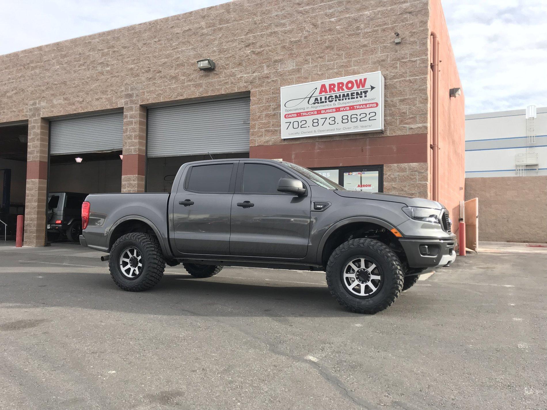

17x8.5 with zero offset and 4.75 back space with a 3ā€ true level lift with 33x12.50 bfg km3. No trimming just crash bar delete. Perfect wheel gap and stance. Yours should look similar.
