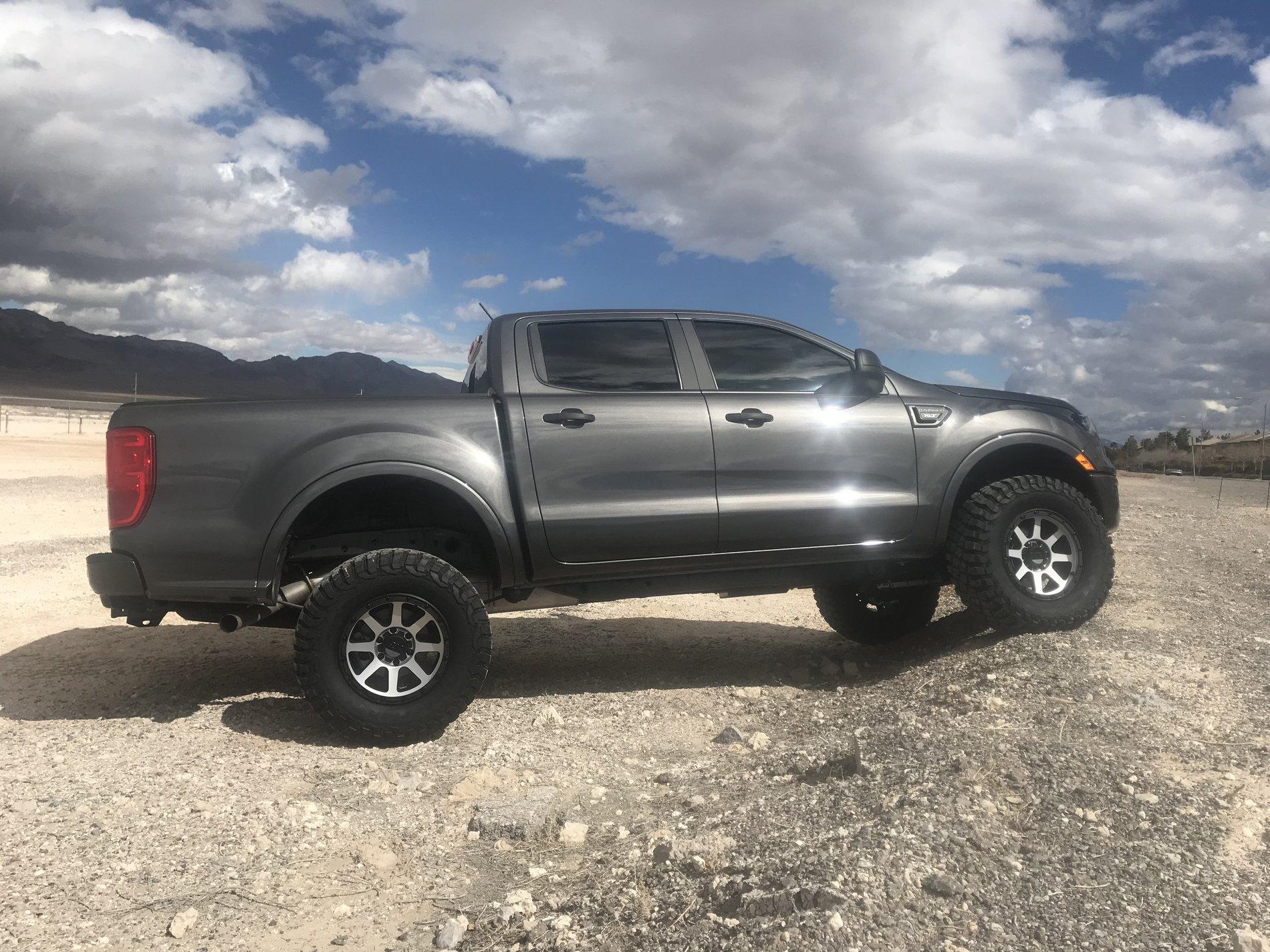

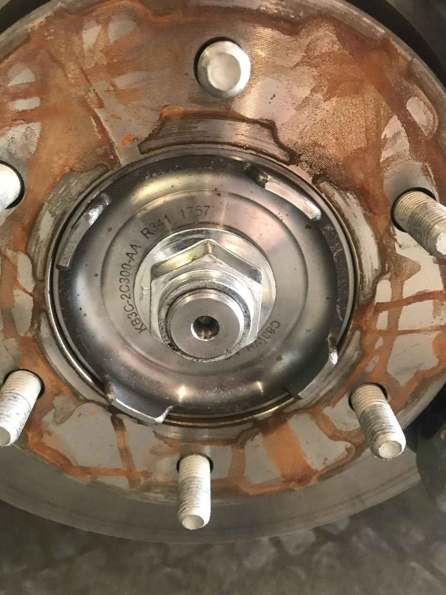

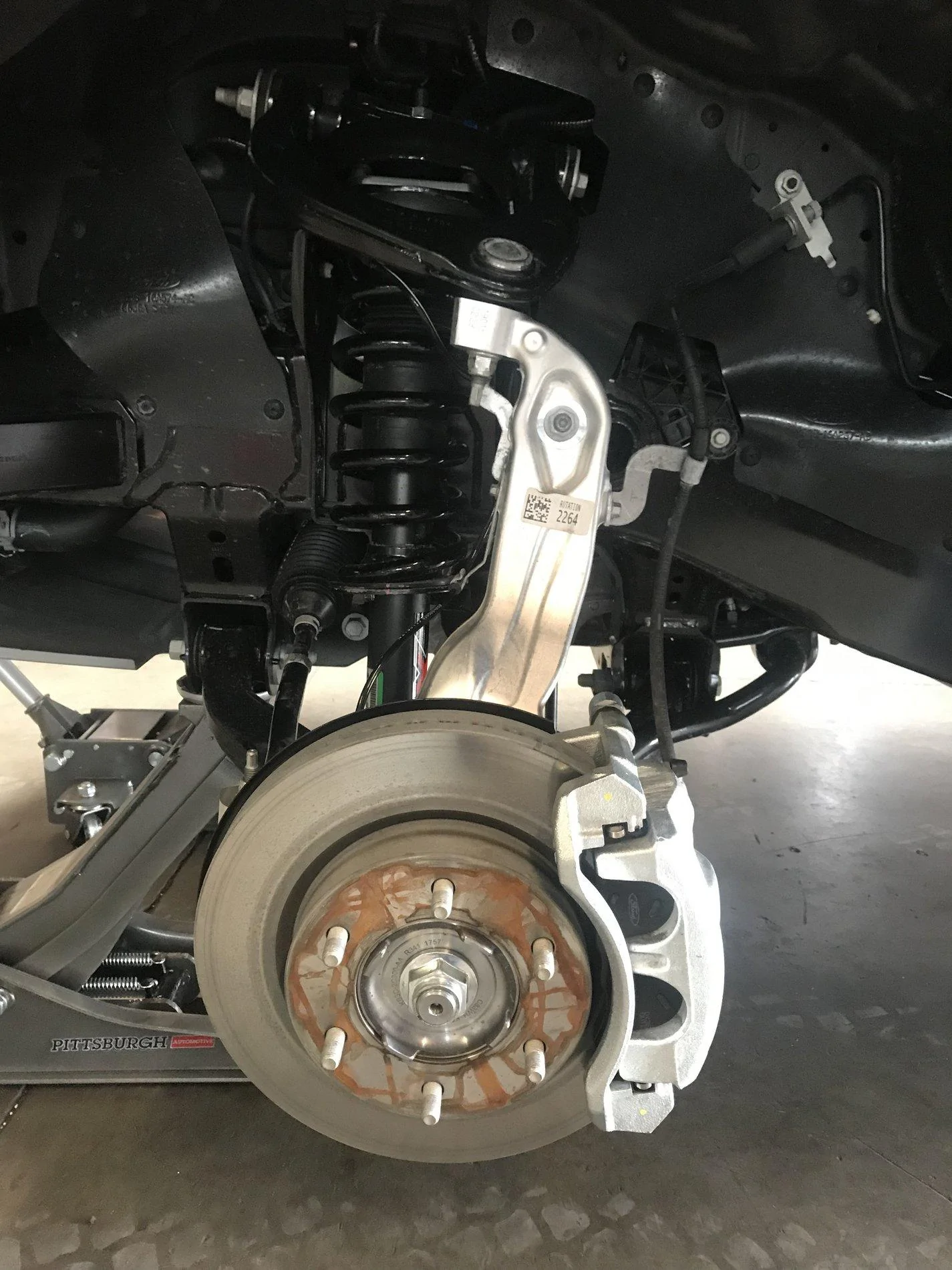

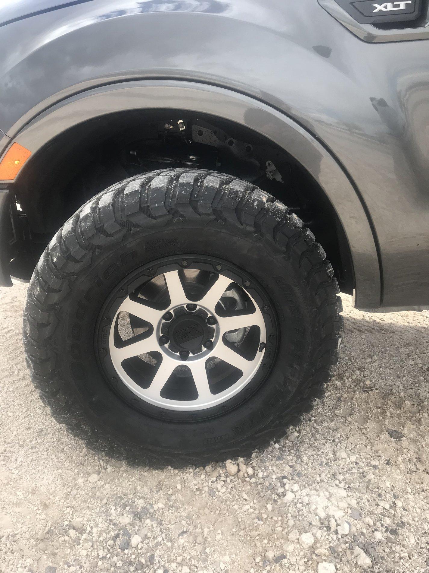

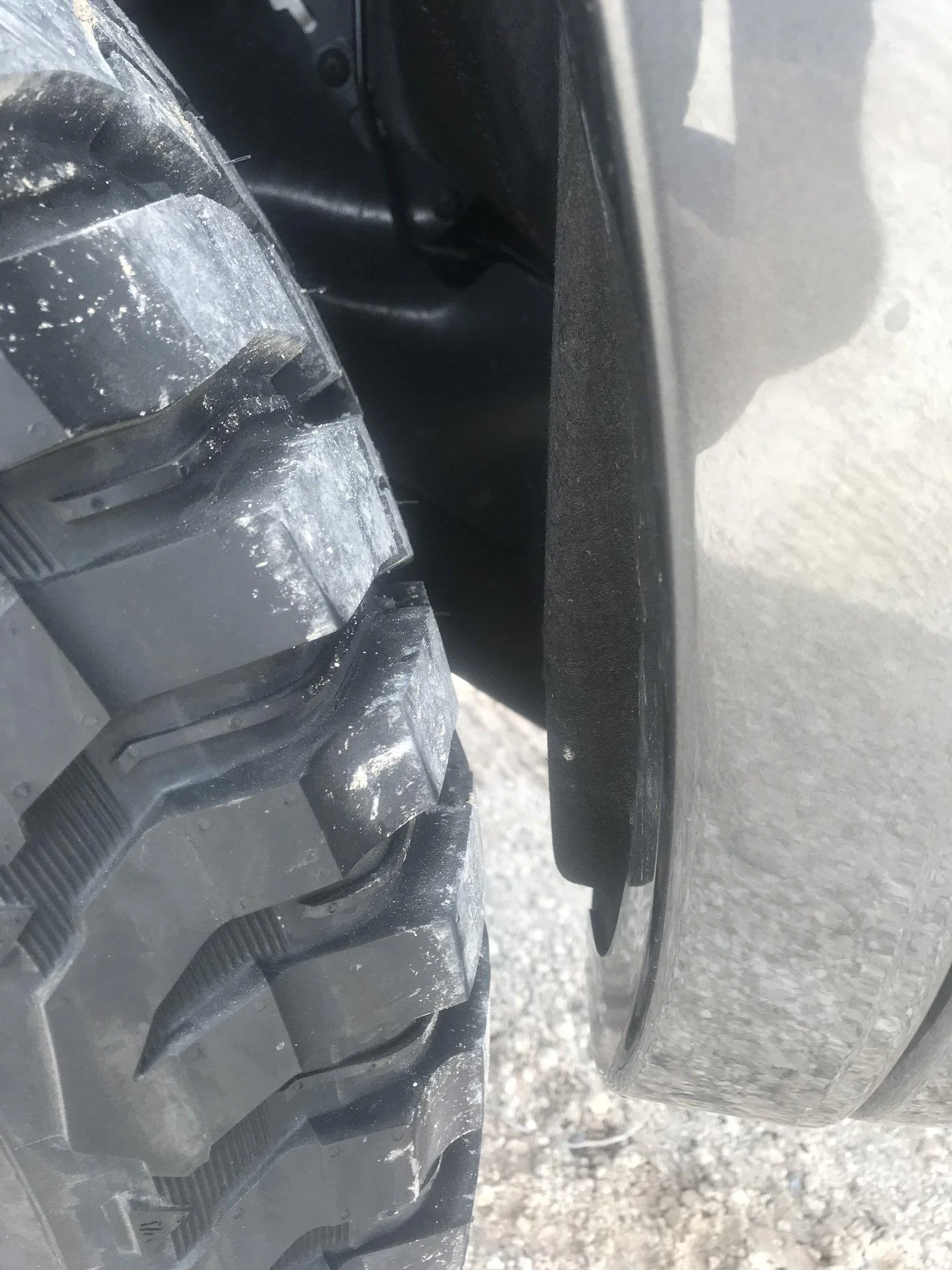

Really? I haven’t verified that. I guess I could go take a peek at the front hubs. I had a conversation with one of the tech guys at ReadyLift about this. Specifically comparing this to the Colorado which requires dropping the whole diff because of the poor angles on the CV Shafts versus the Ranger which didn’t give them issues.
There is 4 1/2” of droop travel at ride height. That’s why I designed a 3” spacer lift. There is no bind in the cv axles at fool droop with the 3” spacer. You will see 3.5” kits but that requires a aftermarket upper arm because it will contact the coil bucket with the longer shocks.

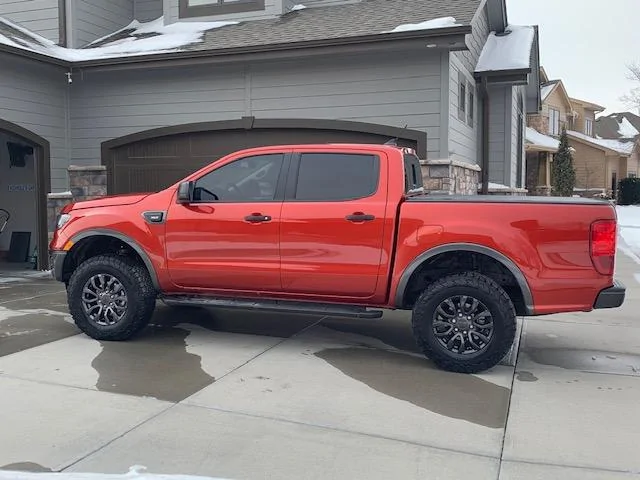

Thanks for the pics. It still appears to have enough articulation to meet my needs and you seem to have cleared up any mystery regarding the front hubs as well. Those cv shafts definitely spin full-time.
DMac
57
78
2019 Ford Ranger Lariat
Rough Country 2.5 level with BFG K02 275/70 R17 on the stock wheels. No rubbing and drives great.
So no scrubbing issues on the upper arm at all or on sharp turns against the crash posts?
