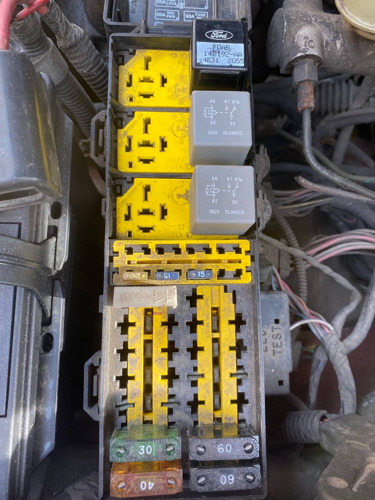

Hi, Just a follow up. Yesterday my mechanic came over and tested the current fuel pump. It wasn't priming. Then we installed a new pump and the same thing, It's not priming. So it doesn't seem to be the pump but getting power to the pump. We got it to start and run for about 10 seconds when the mechanic charged the pump, I'm not exactly sure what he did. But we know two things, It is not the fuel pump, It is the fuel pump not getting power. So I'm kind of back to the relay/distribution box. Which is I had been telling my mechanic based on feedback here. Probably time for a voltmeter and to check grounds. If you have any thoughts I'd appreciate the feedback. I'm going to post a new thread in the Ranger forum for older models. Thanks!
Digbird1
Daniel
May 29, 2024
40
Saint Paul, MN
1994 ford Ranger XLT - 2.3 L
Video Technician
Thanks again for the input. I swapped the fuel relay, the middle one with both other relays - no change, I checked the inertia switch and it hasn't been triggered. I also tried jumping the fuel relay. Could I have messed up something in the wiring or ground switching out the solenoid?

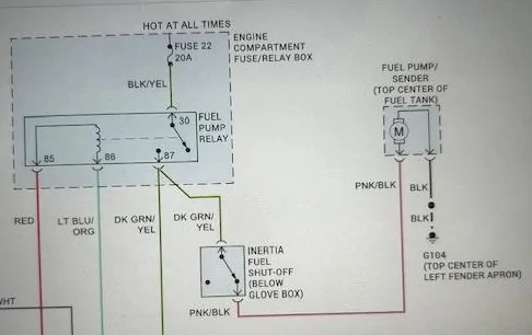

My previously posted - Power Checks, need to be performed, to know which direction to go.
If you got to run for 10 seconds - confirms you have a bad connection or wire with broken strands or a short in the circuit - That possibly just burnt out the new pump.
This is a prime reason for wiring checks, hopefully the bed is still off for easy access to the complete wire run.
Just because the Fuel Inertia Switch is not tripped, does not truly tell you that it is letting power through it.
Think of a bad light switch, just because it is in the (ON) position, does not confirm the switch is good if the light is inoperative.
I would start at the switch 1st and use that as the fork in the road to know which direction to go.
Upstream or Downstream
It would not hurt to possibly doublecheck your connections on the Starter Relay, there is a Fuse Link on that circuit, but it feeds the Alternator.

As already posted, you need to meter (check for power at the switch) to determine where the power loss (which direction - Up or Down Stream) it is.
TJC also points out a valid point and that is the Ground for the pump, is right next to where you were at (Starter Relay) you possibly broke, disturbed that ground point.
This is assuming that G104 is the LF Fender and not the LR Fender, older manuals are not detailed enough for that.
I have a STRONG hunch that if I am following your steps of events, you replaced the starter relay for the no crank issue as well as swapped relays in the Relay Box - Correct?
With replacing the Starter Relay, proved no help and tapping the starter with a hammer, got the engine to crank
With swapping the relays, (a contact was pushed down for the FP Relay) - Now appears corrected - (not yet confirmed - corrected) other than contact is now up and locked into position.
At this point I would back track to the LF Fender and find all Ground Points that you see, pull the bolt and clean and re-install, inspect all wires on the ground wire harness at the lug.
With you jumping - Pins 30 & 87, the pump should have powered (on)
Since this appears to be a - No-Help, then.
You have a power loss between the relay box and the switch or between the switch and the pump.
or loss of ground for the pump.
Being that you were able to get a (10 second) pump run, tells me that the circuit is not completely broken, and you have a bad connection, and I am strongly feeling you have lost the ground. This would make the most sense as you were in the vicinity of the ground point when you replaced the starter relay.
As with TJC posts about the Ground, and your post of the starter relay, this is the most logical spot to check and would explain why - all of a sudden you have a non-running pump when the original issue was starter related.
Other than that quick check of the Ground, you MUST do a Wiring Check, this requires a meter to properly check the circuit.
To test the Ground from the FP connector, you disconnect the connector.
Red Meter Lead - To the Ground Wire (on the connector)
Black Meter Lead - To a good / clean body ground (frame) you should see a (Resistance) of under 3 Ohms (average)if higher than 3 ohms, then the other end of the Ground Wire is not making good contact (G104)

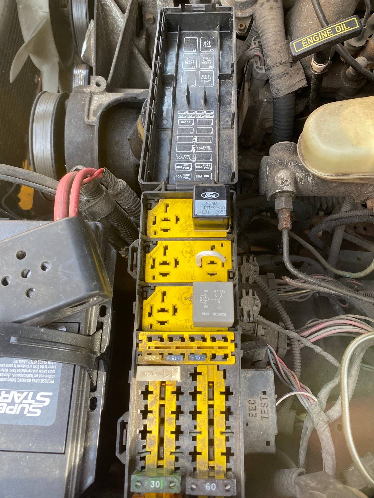

YES - and this is the main reason - I am pushing for a Wiring (Voltage Check) which his mechanic is refusing to do - I guess
This is also the reason - I had him - Jumper the Relay as this by-passes that relay.
Power to that relay (FP) comes off of the EEC Power Relay and the Ground comes from the EEC seeing an ignition signal input and crankshaft rotation.
So, it is still possible for an EEC relay issue or Crank Position Sensor issue, dropping the Ground off of the FP relay.
With a jumper at the FP relay, you take 1/2 of the T-Shoot out of the equation, as you are suppling a direct uninterrupted power feed to the Fuel Pump, if all the wiring Power & Ground are good between the 2, that pump should be running.
With the relay installed the (normal) operation for control comes from the EEC grounding the FP relay and the (ONLY) way to know exactly what is happening here is to get a meter and know what to check for power.
I have provided a Step-by-Step procedure to isolate the issue and the mechanic has ignored my suggestions and thus has spent the time and wasted the OP's money on replacing a FP that did not need replacing, if he had only used a meter to check for power at the Fuel Inertia Switch (5-Minutes) or the test procedure at the Relay box test port, this could have been avoided.
I get it, some mechanics are just parts changers, and refuse to accept the fact that the issue can be wiring related mainly for the sheer fact that they do not know how to use a meter or are too scared to use one. I have been a mechanic both Automotive & Aircraft for almost 40 years, I have seen both types of mechanics. A mechanic in today's age of cars, you cannot be a parts changer, you have to learn how to use a meter (at least basic usage) do you have power & ground to the inoperative part? If yes - replace part, if no - diagnose WHY.
Another tool that would help (for this thread) is to hook up a scan tool and ensure you are getting Crank and Cam position sensor pulses while cranking the engine over. (with the FP relay installed) as with the FP relay jumped you take this need for input out of the equation for that fuel pump to run.

When I swapped out the starter relay I remember there's two ground wires. I wonder if I may caused this issue myself by screwing up the ground. I don't understand what is meant by making a jumper to jumper the ground from the top of the fuel box. After installing the new pump my mechanic sort of ate his words and is bringing over a meter, a voltmeter I think. Thanks again for the help!!
I believe he used the EEC Test port - at the relay box and provided a ground for the FP relay, as I posted above, this is not the ground for the pump itself, this is only forcing a ground to the FP coil side of the relay, which you by-passed with the jumper 30-87.
The test port only provides a way to by-pass the relay (control ground) from the EEC and would be used to confirm a bad output from the EEC (control) and or wiring to the FP relay, as with key on and a forced ground - the FP relay should close and power the pump.
You have already done this by jumping the pins 30 & 87 and by-passed the need for this step
