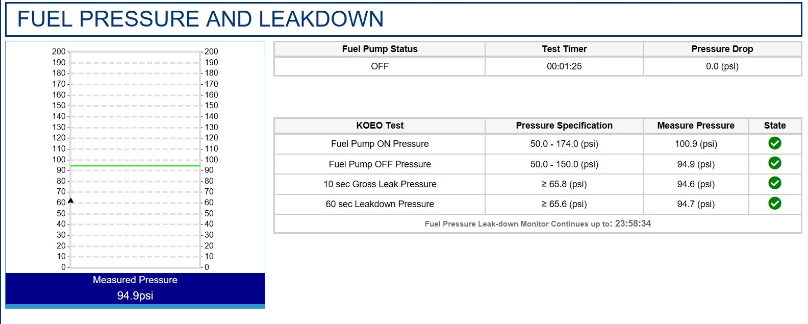

Test Example: When I was playing with the scan tool
Note: The Pressure Reading comes from the Fuel Pressure Sensor, if this fails the test (note this is an automated) test that can be monitored for 24hrs
An actual gauge test can be tapped in between the HP Fuel Supply Line & HP Pump to compare readings.
After 15-Minutes the spec is greater than 45 PSI

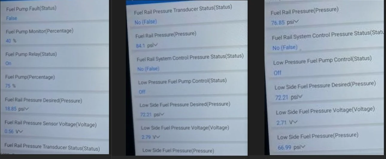

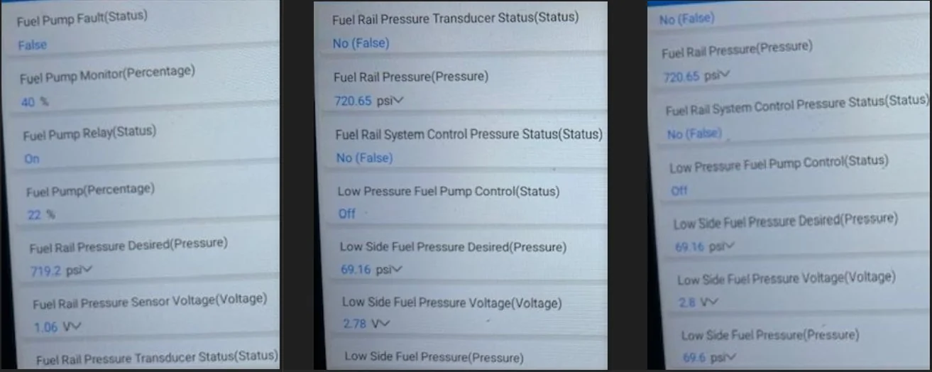

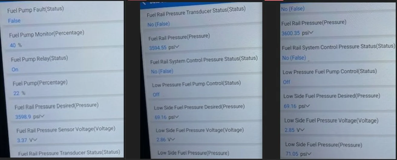

Ok, Not the best snap shots - but at least provides a ref of normal pressure readings
Note: shot 3 for each line only adds the Low Side Fuel Press
Cold Start: From Overnight (Rest)
Door was opened and the LP Pump Primed
KOEO (Key On Eng Off) Readings

Just after engine start (Cooling Fan) and RPMs Higher Speed @ Idle
After Eng Running for 10-Minutes, RPMs and Cooling Fan - Settled Down @ Idle

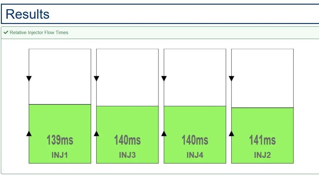

There are a few tests for a leaking injector.
This is the best one as it will isolate the injector.
It's an automated test and it runs through each injector
Pressurizes the Fuel Rail (Reads Fuel Rail Press) to a specified target
Each Injector is pulsed (On & Off) in a cycle, and it measures the time in (ms) it takes each injector for the Fuel Rail Press to drop to the test value (specified target) (I do not remember) that value off hand without getting into my notes.
Relative Injector Flow Test
Test is done in the Firing Order
The results need to be near equal
Normal Range = 140 +/- 15ms
The arrows provide the Min/Max Range, and the scale will turn red if out of range.
Lower Result (faster time) shows a leaking injector
Higher Result (longer time) shows a clogged injector
